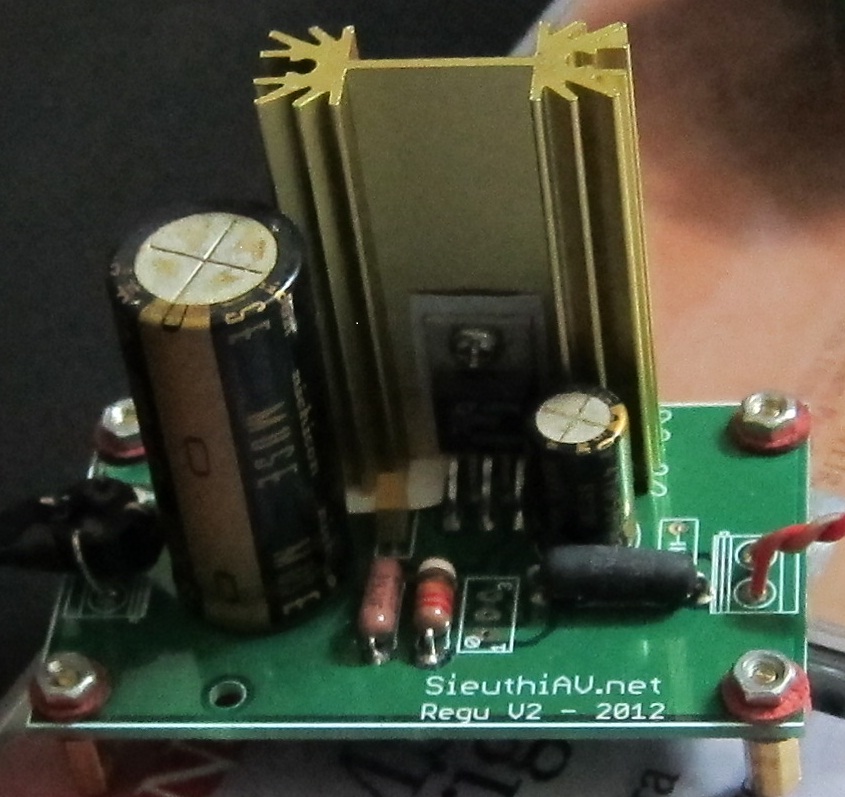

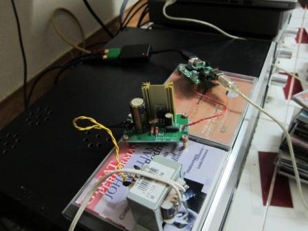

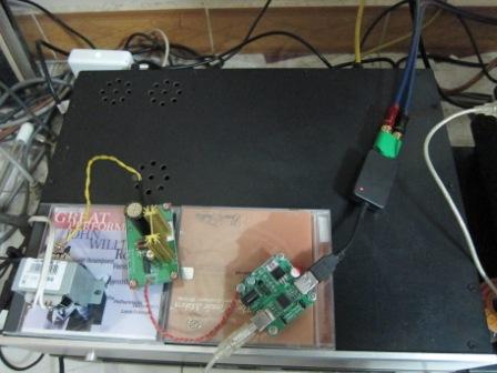

Some photos of the DAC with USB isolation board and independent power supply.
The new version need only a 9v transformer to work the rest of the power supply is built-in but that's not the end of it if you want the best sound possible.
A small 9v transformer is relatively cheap.

I didn't know the current draw for both the usb isolation board and the dac so I just use one relatively large heat sink that I have on hand. In fact, I can't feel any heat when I touch it. It seems very low current is drawn by the circuit.
I chose 9vac because the isolation board specification requires min 8vdc. 9vac gives 10vdc after retification and filtering. Note that the Isolation board has its own discret regulator. I think max drop out on lt1963 is 2v and max drop out on the onboard discret regulator is 3v.
In fact there are 3 regulator before the DAC chip. Lt1963 - onboard regulator of the isolation board and then LT1763 on the DAC pcb. Therefore i think ripple rejection would be good.
May be inserting a current regulator in place of lt1963 is best but lt1963 and the pcb is readily available to me... Do you have any recommendation on this? Which other chip is better?
