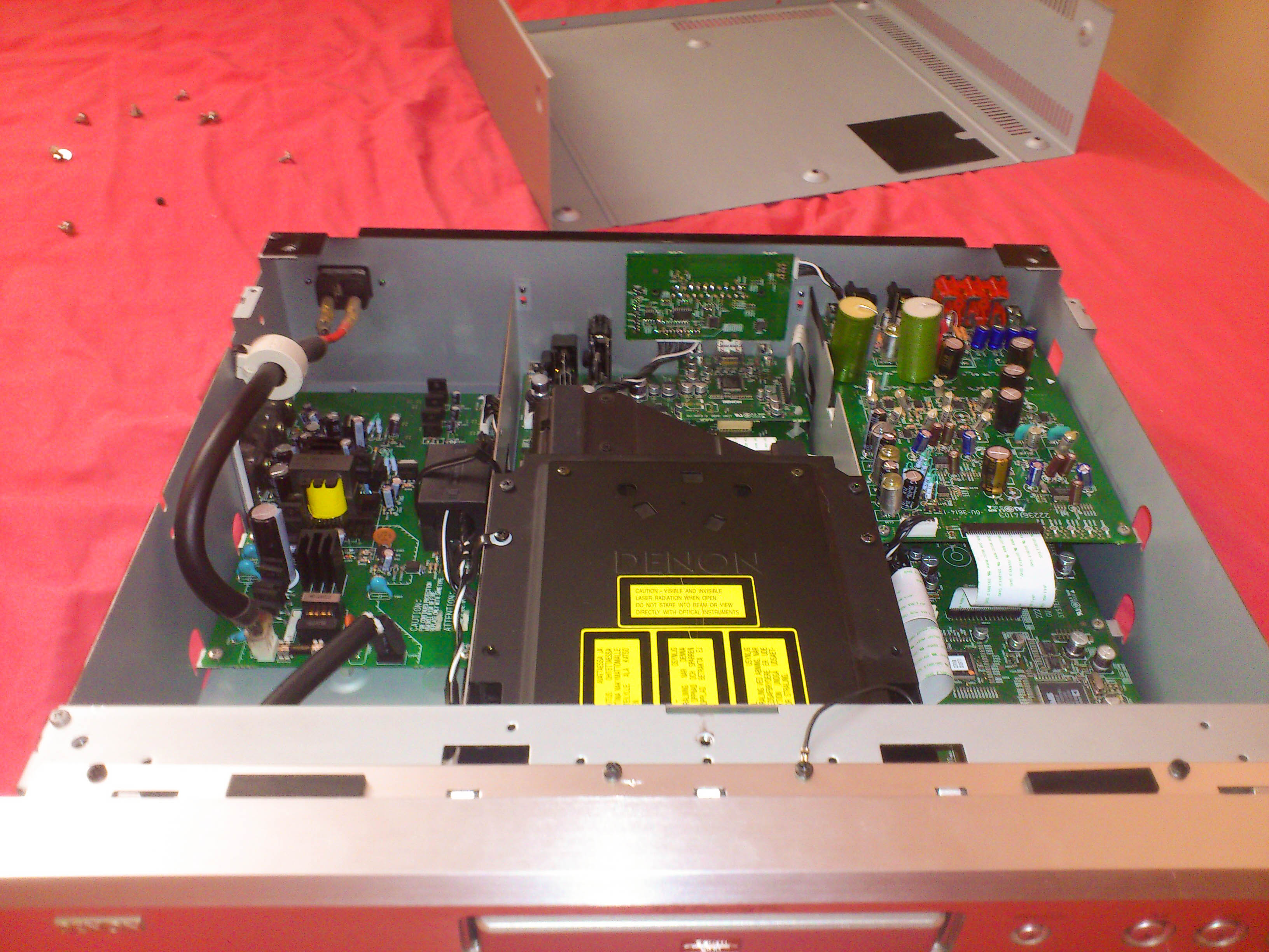

I opened the thread
Was not my intention to ask for the opinion on whether the fuse good.
I opened the thread to ask if into something that the fuse has been such a problem.
I used Fuse before the reconstruction project of 3910 DENON DVD
The audio circuit and power supply SMPS

After the process SMPS project on the DENON DVD 3910
Where some of the components
I replaced the power cord inside and heard a big difference for the better
