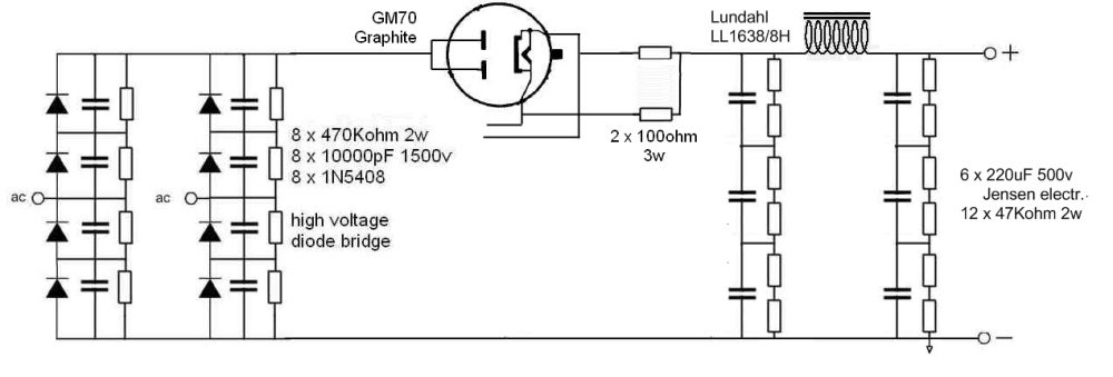

This evening the first test using the GM70 Graphite like diode in the configuration of the attached image.
Tested on my 845 two stage ampl.
1000v without the GM70
940v with the GM70 like diode
Until now I don't see problems.

mmmh... why not using an "hybrid bridge" (SS diodes on one half of the bridge + 2 VT diodes on the other half) instead?
AFAICT, that should give better results (e.g. less rectification noise), though at the price of one more VT.
Since I'm here, another question: why "wasting" a triode to do the job of a diode instead of just using a plain VT diode? I'd bet the Russians had some plain VT diode similar to a "diode strapped GM70" among their vast VT production...
ahem... broken link. Could you fix it, please? Tnx.
This evening the first test using the 6D22S like diode in the configuration as previous PS design with GM70.
1000v without the 6D22S
972v with the 6D22S like diode without output resistors
Until now I don't see problems, probably I will add an output resistor to reduce current peaks
Why use 2 tubes instead of 1 ?
http://www.audiodesignguide.com/Claudio845/VTPS_solutions.png
mmmh... maybe.
I'm not sure about the switching noise of the SS diodes, particularly in the 3rd circuit.
IMVHO, "by heart" (educated guess) I would say that (at least noise-wise) the "=" signs should be in fact "~=" (almost equal), with the 3rd circuit being quite less similar to the first than the 2nd.
Hint: during switching transients, SS diodes are not so much "one-way" devices... they may have quite a bit of stored charge... if each SS diode is connected to a VT one (2nd circuit), the VT diodes should prevent any "strange" fast switching transient within the bridge. Obviously the same will not hold true if you have a full SS bridge before a VT used as a "dynamic resistor" of sort... (though adding small caps and/or snubbers you may effectively clean it up).
BTW: for sure, if you want to get close to a (fully) VT rectifier, you'll want to use only Shottky barrier type SS diodes in either the 2nd or the 3rd circuit...
