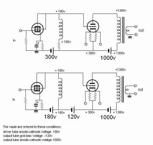

It is clear that for the direct coupled with stacked power suply are necessary the same power supply of the interstage version, no more.
In my case:
170-180v for the driver stage
90-130v variable for the bias of GM70
1000v for the output stage
I cannot see problem of this configuration.
The cost is reduced because there is a simple anodic choke instead of an expensive interstage and the frequency band depend only by the output transformer if the choke have enough inductance.
The interstage transformers are complex components with more problems and frequency band limitation than output transformers.
I think to try it soon using a pair of sowter 8982 Plate Choke with
100 Henry 50 mA and about 300ohm

audiodesign said:In any case without dropping resitor we are sure that bias does not change with the characteristics of the driver stage and also at the startup there are no problem.
I never had problems at the startup, I use mercury rectfiers that are pretty fast in reaching the B+.
You can trim Rx to adjust the bias of the output tube while the driver ages. Anyway I never touched it in months.

At the startup the direct coupled with dropping resitor can give problema because the warm time of the D3a could be more longer than GM70 so this can be destroy for the low Vg.
The direct coupled without dropping resistor (in the attach second schematic) give the same peformance of the other solution but it is sure in any condition, also if the D3A is not in the socket.
It is obvious that this solution cannot be applied in my 845 with 2 tube stage ampl. (see other forum) because 1000+120+1000 = 2120 voltage of isolation are too much for any output transformer.
There is a little problem using this direct coupled configuration: it is necessary use separated power supply for the 2 channels because the gm70 grid voltage must be variable so also the negative reference of the 1000v power supply.
Only the 180v could be the same for both channels.

For Gluca:
there is a big differences between the schematic you sent from Andrea's one.
On your example the cathode is not bypassed so, in this case the V3 is modulated from the ac voltage on R6.
On Andrea's the cathode of KT88 is bypassed so there isn't modulation and the KT88 is not working in ac.

Yes, this is true the two schematic are very different
in the Gianluca version the second tube give some contribution on output because also if this have the grid connected to ground it receive a parts of signal from the cathode.
in my case if I connect one grid to ground the second tube is near to a fix costant current generator so this will give a sound like a single ended configuration.
