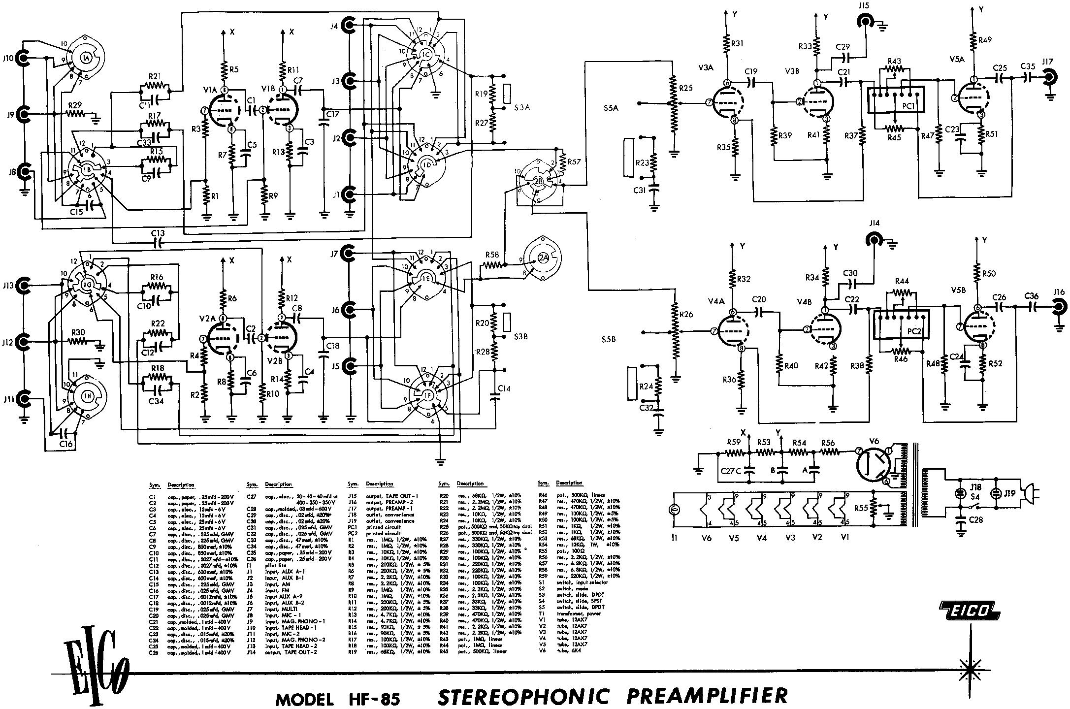

So believe it or not Im finally getting to this! LOL.. been awhile..
If someone would be so kind I still have some questions.. I cannot locate the can cap with three caps in it.. the original is 20/40/40 UF... can I use a 50/50 can for the two 40's and then a 20uf or greater for the 20?? This is obviously in the power supply section...
Also.. I am told, if I am not using the phono section that it can be "disconnected" and hum will be lost.. Im hoping to make this thing a black hole of quiet.. although its stull functioning well with all orignal caps but the .1MFD caps replaced (did that a few years ago cuz it was easy and sorta wish I had kept those old black diamond caps)... there is some hum and popping.. but no hiss.
Im told refreshing the caps will not stop all the hum.. so since vinyl is not practical I would like to try disconnecting the phono section.. but where? and then how would I adjust voltage for tubes shut down (I read I need to do this.. not sure if its right).... My guess is I disconnect the X output at R59/C27?? I have no clue though.
Lastly.. and this is weird.. I was experimenting with using tape out.. WOW.. much better sound without the tone controls in place.. but I MUST use loudness as there is no bass (which I have modded BTW so the volume control works way up higher and accurate)... umm anyway while I was doing that my 400a threshold went bonkers and blew a fuse.. now no matter where I put the 400a on the Eico the meters go full bore and it blows a fuse.. however my little Aleph amp works fine.. I ran another preamp into the 400a and it plays fine.. so Im guessing I possibly have some DC on the outputs of the Eico that the 400a cannot tolerate or something like that??? Whats really odd to me is on the standard preamp section there are .25uf caps in series just before the RCA connectors and none at the tape out.. I thought the point of those was to ensure AC only... Not sure why Im second guessing these design as I have no clue what Im talking about.
Also.. are MICA caps ok for the ceramic replacements? My shopping cart is loaded up at mouser.. just need to pull the trigger..
here is the schematic..

Barchetta -- using a 50/50 for the power supply is fine. The original Eico design of the HF-85 is woefully inadequate in B+ filtering, such that most stock units will exhibit a slight 120 Hz hum in the output as a result. Using a 50/50 uF will help, but the real answer is to split the 10K B+ dropping resistor into two 4.7K sections, and add another filter cap section in the middle where the two resistors join. Using a 50 uF for that position would be perfect as well.
The tape out jack is supplied by a .02 uF cap in the stock design. If these are not in place in your unit, you would surely have DC on the output at that point. If you are driving a SS power amp, from the tape out jacks, then I would increase the value of these caps to 1 uF, if VT equipment, then increase them to .1 uF.
In spite of increasing the value of these caps, the HF-85 has an eq error at the tape out jacks. This is because the fore mentioned coupling cap is connected directly to the plate of the line amp output stage, and not to the output of the coupling cap feeding the 33K FB resistor. This error results in a slight bass boost at the tape out jacks which you might find pleasant, but it is not accurate. To correct these issues, the tape out coupling cap should be increased in size as mentioned above, it should be tapped into the circuit at the output of the FB coupling cap, and then the FB coupling cap itself should be increased to 1 uF. These changes (along with the power supply changes) result in a very stable preamplifier, whose response at the tape out jacks is dead flat -- as it should be.
If you want to guild the lily, then a .25 cap (low voltage) should be placed between the output of the fore mentioned FB coupling cap, and the input of the tone stage amp. Then, the .25 uF cap on the main output of the tone stage amp can be dispensed with. The original design uses the .25 uF output coupling cap to prevent any DC at the main output, but such an approach leaves DC on the tone controls from the line stage, making the tone controls noisy when they operate. Inserting the new coupling cap as mentioned eliminates any DC on the tone controls from the line stage, and also eliminates the need for the main output coupling cap as well.
The excessive gain is a whole different story, that really requires a redesign of the line stage to reduce its gain, so that the level control will respond properly to most power amplifier sensitivities without the need to modify the level control to achieve it. However, the loudness control circuit should be modified so as to allow the sound level to remain relatively constant whether the loudness switch in turned on (providing bass boost) or off. The yahoo Eico group has details on this modification.
If you don't want to use the phono preamp tubes, the easiest thing to do is to just remove the them. Yes, it will cause the voltages to jump a little bit, but hardly to anything that is of concern. There is little if any need to compensate for the removal of these tubes if you chose to do so.
Good luck with your preamp!
Dave
The caliber of folks on this forum continues to amaze me.. Thanks so much for taking the time to reply with a thoughtful, and extremely informative post. While I dont fully understand it I'm going to read it a few times and google what I dont know.. however, most of it makes perfect sense..
I will say this.. I did do that mod of the loudness control you mention.. basically it involves swapping the resistor and cap on both channels of the loudness switch and then moving the tap wire from each potentiometer to the center position of the switch.. this effectively adds more resistance to the volume pots and lets you run them (the pots) up higher where they are much more controllable.. it used to be Id have to adjust the balance nearly every time I moved from a low volume to high volume ... now I do not and its much more linear for some reason.. I do need to run the loudness "on" to get bass but I suspect when Im done rebuilding I will not need to do this.. the loudness on puts a capacitor in each channel in I think series? with the potentiometers.. maybe not in series.. forget.. anyway.. they are both ceramic type but seem to be working after all these years. If anyone has this amp, all I can say is I wish I did this modification years ago.. I've spent way too much time manually putting the balance back and this is an easy mod for anyone who can use solder wick and solder.
If you do get a chance.. the one acronym I do not understand is the reference to "FB".. not sure what that is.. but I'll probably figure it out.. I would like to make that power supply mod you mention if I don't get it to go very quiet after the cap upgrades and removing the phono section by removing the two tubes as you suggest.. I was able to successfully recap, and re-transistor my Threshold 400a SS amp with a ton of help from this forum so I think I manage this based on what I learned...

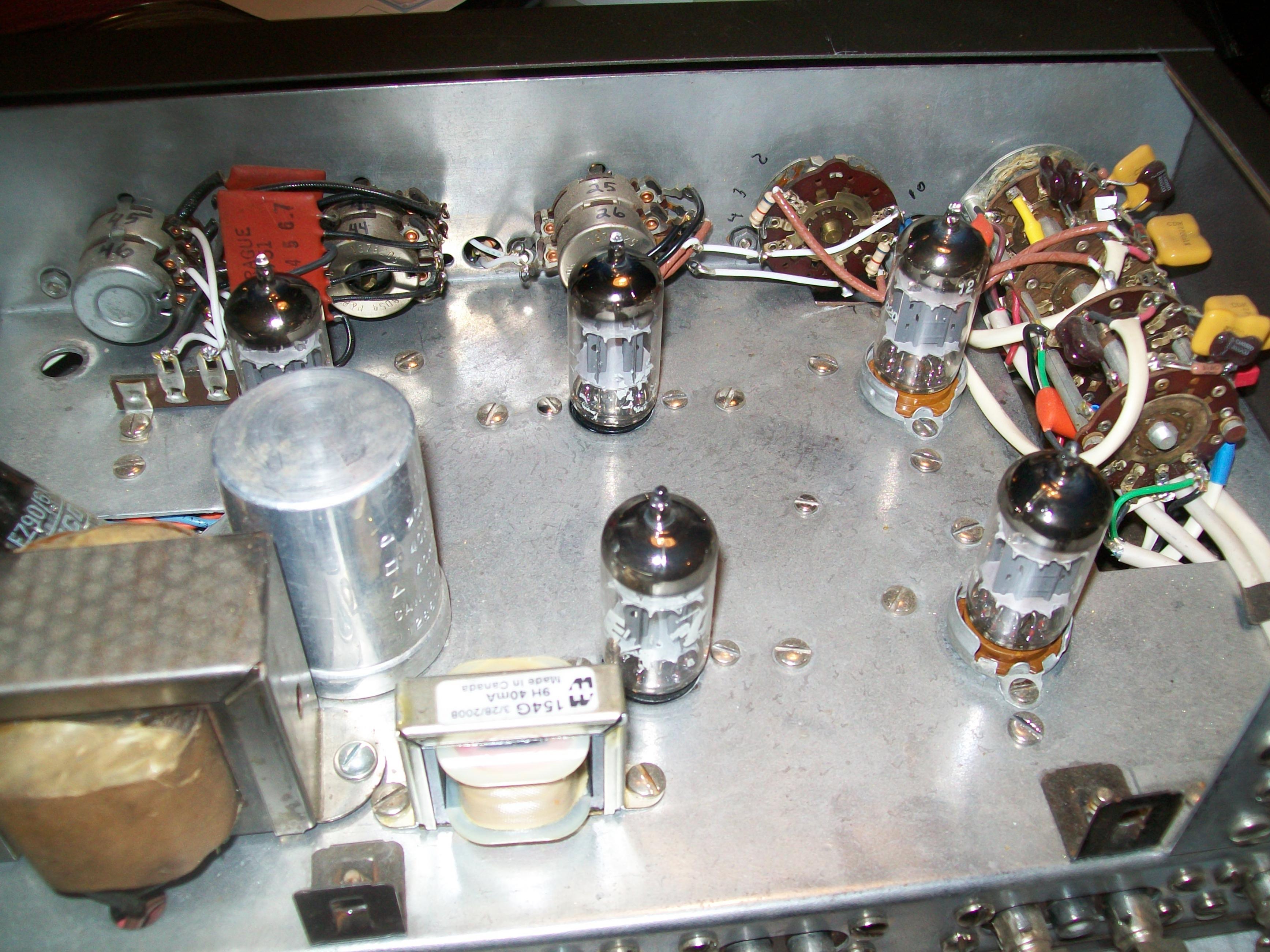

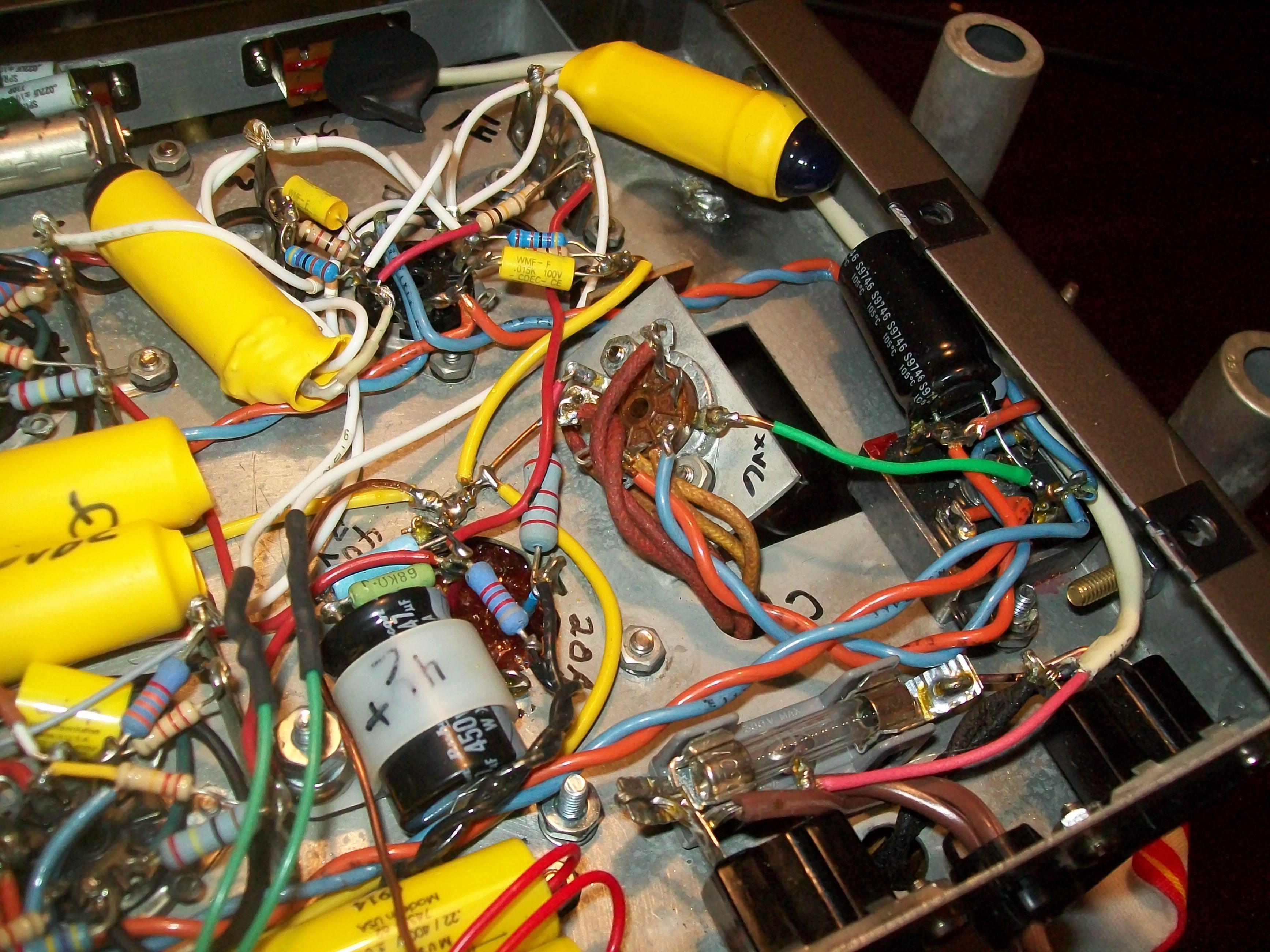

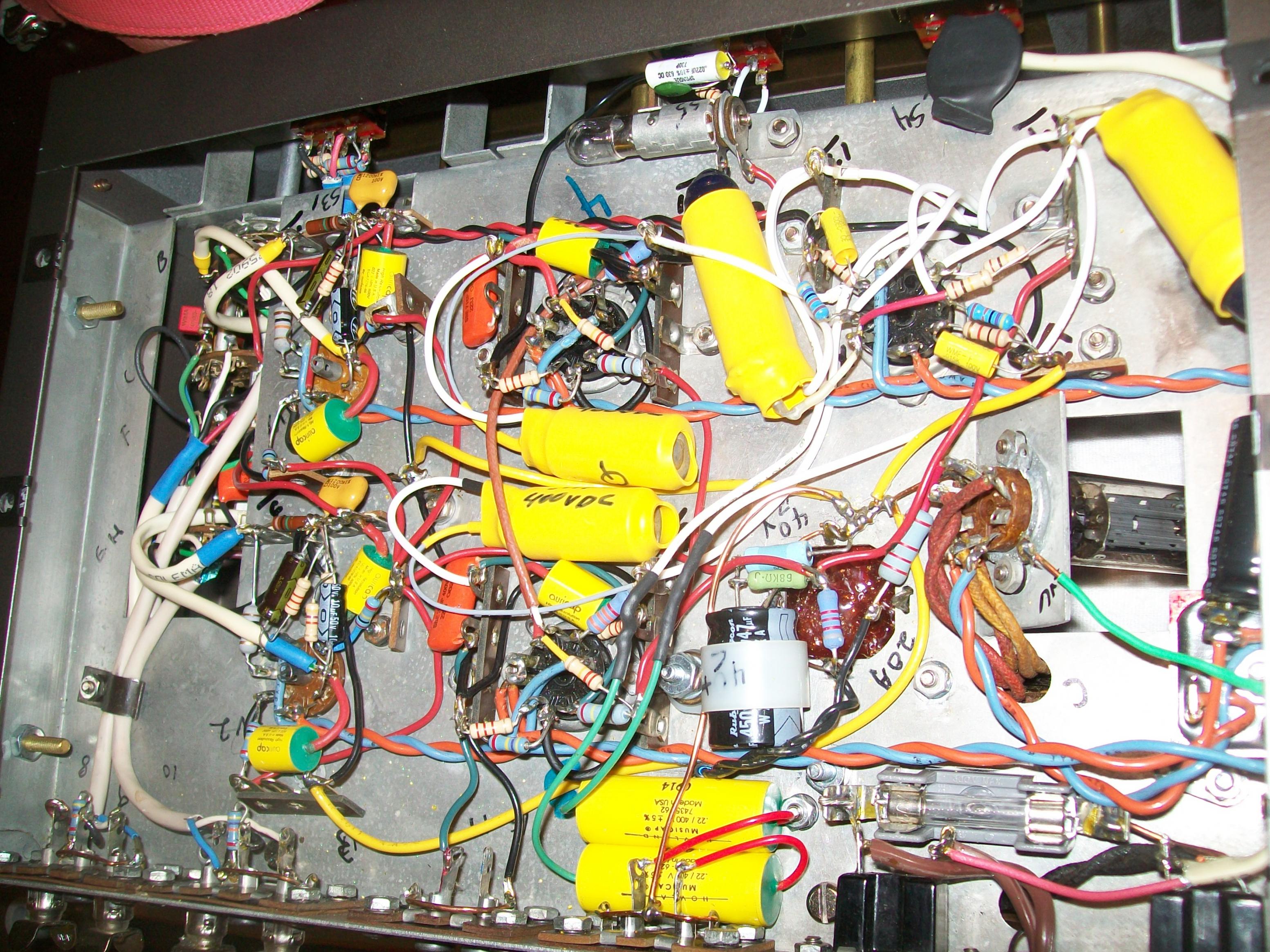

I converted mine to DC fils and haven't had any problems as far as PT overloading. This one was fairly rough, so a complete overhaul was a no brainer. I was able to retain and rebuild the selector, and the old pots work well after disassembling and cleaning, as do the RCA connectors in back. Pretty much everything else (except the tubes) is new. The only issues I had was straightening out the funky loudness resistor / cap wiring issue and a slight turn off pop that was corrected with a .02 1kv ceramic across the power switch contacts. Nice sounding little preamps for sure. I think you can see the low voltage full bridge and cap for the filaments in the last picture. I ran the wires twisted just in case the DC thing didn't work out.

The photos supplied help a "know enough to get in trouble type" like me understand and verify some things.. so I appreciate those being posted here.
