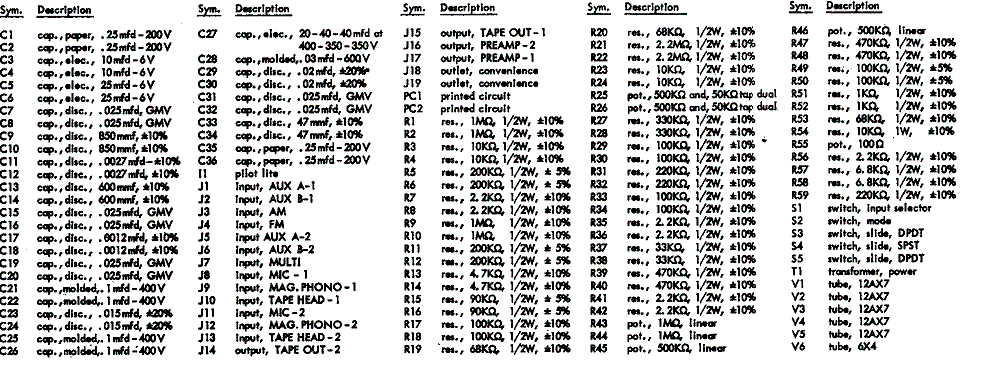

Well Anatech has reminded me that my original 1959 vintage Eico HF-85 preamp is running on borrowed time. I'm wondering which components I should be replacing and with what? I have heard that component selection is critical on this pre-amp to maintain the original sound..
I have also heard that the original carbon resistors are critical to the sound.. so if that is true (is it?) can I leave those? Should I measure them and see if they are in tolerance?
Which cap types can stay?
As you can tell I am a beginner.. so please try and respond so a beginner can understand.
The current condition of the unit is a very small amount of hum and amout 50mv of DC if I remember right.. it sounds great but lacks in detail a little..
thanks in advance for any advice you can offer.

It's possible to get new carbon comp resistors (or use Kiwame carbon films). Use metal films in the power supply section. Use new oil capacitors (russians or other) to keep that pyramid 'tone'. I would ditch the ceramic caps for something a little more modern though JJ sells a multi-section electrolytic that could be used to replace the original.
The other option would be all metal film resistors and modern film capacitors.

WHich ones are the ceramic? And by oil caps does that mean electrolytic? Sorry warned you I was a beginner.
Those flat ones are ceramic. Oil referred to Paper In Oil (PIO) caps, they are the coupling caps - those 4 black pyramid and 4 paper caps.

Some advice. Do not buy paper in oil caps or carbon composition resistors. They are not reliable and are rather over priced. Just use a decent axial plastic type (poly) capacitor and metal oxide resistors. The only "vintage" sound carbon comps will give you is a hiss and possibly light popping in the background.
Take picture and replace both resistors and caps at the same time. If you get rid of the ceramic caps at the same time, you will improve the sound substantially. Try to place the new components in the same physical positions as the old ones.

Hey I have a question about this.. when we talk about resistors that are out of spec, can I determine if they are in spec by simply measuring them with no power applied? Or can they change while under power?
I guess what I am getting at is there are lots of them and I could easily measure then all quickly rather than having to replace them all.. I know many of you would say to me just replace them all.. but call me lazy..

716P type capacitors are the wrong ones. You can not install them in the same place the originals went because they are radial caps, you need axial types.
Hi tolerance resistors will not help you. Those circuits are designed with 20% parts in mind. Certain resistors should be matched together and not to a value.
Hi Joe,
I normally replace all resistors that have been overheated or changed colour not matter how they read. That may be most of them in some sets. No tolerance band gives you a 20 % tolerance, silver is 10 % and gold is 5 %. It would be very odd to see an original 5 % resistor in there. That was a precision resistor back then. If you have a 20 % resistor reading over 10 % off value, you may want to change it anyway. It's already heading off somewhere.

Normally you can just measure them. Leaky caps will throw your reading out, and power supply caps may need to charge to give you an accurate reading. You will see the reading changing with time. There are times when you will have to lift one lead to be sure. Some defective resistors will change their value as they warm up under load.Hey I have a question about this.. when we talk about resistors that are out of spec, can I determine if they are in spec by simply measuring them with no power applied? Or can they change while under power?
