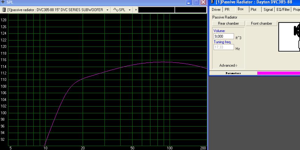

Hey thanks! Those are nice PRs, but it says that their Fs is 4Hz?!?! Even their "700" PR has a Fs of 6Hz. How would I be able to use those with the Dayton 15 DVC?
"BAM", I take it you built your own PR sub system right? What did you use and what size enclosure did you go with? What the sub rated down to (Hz)?
Also, I tried entering some data in WinISD Pro last night and the program locked up saying something about a "Floating Point Error = 0" or something like that. I've used WinISD for several years now and never came across that error before. Any ideas?
Well it depends on how the "stock weight" is integrated into the passive radiator. If it's a extra weight disc that has been perhaps glued onto the cone it should come off easily. But if they use a extra heavy diaphram to contribute to MMS you would have to do someting like replacing the diaphram.
My suggestion. Find the PR's parameters. Enter into winISD and play around with alignments. You may need alot MORE mass than the PRs already have.... Hopefully that is the case.
Knowing that you have two PR's the system resonance should be fairly high that you shouldnt need to remove mass
I use the AE Speakers AV12 in 3 cubic feet with two 1400g 15" passive radiators. Both the AV series drivers and the passive radiators are fantastic parts. If you want 15's, you might consider the AV15 woofers once they become available again. They will want the AE Speakers 18" PRs, though, two per driver, to make sure you don't run out of displacement on them. With a 20 Hz sine at high levels, I can push the 15" PRs all the way to excursion in the 3 Cu. Ft. box. This is an extreme case, though. But it shows why you will want the 18" PRs if you go with an AV15 woofer. The diyAudio.com member "paulspencer" also has a pair of AV12 woofers in sealed boxes.
As for PR subs in general, my experience has been a favorable one. Just mind your box-design P's and Q's (like, don't tune too high) and you will be happy with it. If your box is tuned very low, don't be surprised if the PRs don't really get into the action with most program material - they only really get going when you start getting pretty close to their tuning frequency. Mine is tuned to 18 Hz. It's fun in the movie We Were Soldiers when the helicopter flies overhead, and the bass is going "whompwhompwhompwhompwhomp..."

simon5 said:Hey chops I've just checked your driver with Acoustic Elegance PRs. It could work well.
I want to know, do you have 9 cu.ft for both enclosures or 9 cu.ft per enclosure?
Hi simon5, I could if need be go up to 9 cf per enclosure. I'm a firm believer in larger enclosure for improved bass output with moderate amplifier power.
In fact, speaking of amps, I am no longer going to use the QSC RMX 1450HD that I was planning on. I just don't like the idea of a fan running, especially durring quiet music passages or quiet parts of a movie. I am however going to get two of those 300 watt digital BASH plate amps from Parts Express. Digital amps are the way to go these days; low heat, efficient and silent operation.
Simon5, did you run my driver through WinISD with two of the AE PRs? How did it look on the screen? Just curious, thanks!

Holy smokes! Three PRs per enclosure?! Wouldn't two PRs be more than enough for the Dayton sub?
Don't worry, I'm not complaining or questioning you at all, just a little surprised.

Yeah, two would be enough, but the light PRs (PR700) are at 70$ each and you would need two.
So, you can go over the edge and buy three PR1050 for the same effect, lower price (3x 45 = 135 vs 2x 70 = 140) but better visual effect, no???
