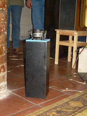

Can you show me an image of the Omnidirectional speaker that was chosen? I was able to see some, but believe I am missing out on the most important ones.
here is a picture of one of the original speakers. They are tiny sealed box with a small mid-woofer mounted horizontally and "backwards" (upside-down) on the top, "back-to-back" with a tweeter (also horizontal, that is firing toward the ceiling). Some care have been taken in the choice of the drivers (and the xover) to obtain a suitable (vertical) dispersion and proper tonal balance. In spite of its extreme simplicity and low cost, results are awesome. The original design is unfortunately not replicable as-is 'cause the drivers used are no longer available, but the author is working on a new version using currently available components.
