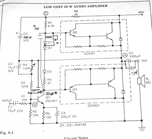

Here's a 20 watt amp, very simple but sound good
unclejed613 said:
i hope that 47uf compensation cap on Q1 is a typo....
Hi
Yes it was a typo error, I did post a corrected schematic in a second post, with a 47 pf cap.
Btw, I would like to try this amp circuit but do 70v supply are ok for TIP142 and TIP147 ?
They have a Vceo of 100v.
I do not have a simulation software, anyone can do a simulation on my circuit ? .
Thanx
Cheer
Paul
Paul, since you increased the supply voltage and changed the values of the bootstrap resistors the DC offset control no longer works in the proper range and the circuit operates with a huge misbalance in the DC levels. With the trimmer set to about middle of the dial the DC voltage at the point between the emitter resistors (of the ouput devices) is about 20V while it should be 35V! Even when the trimmer is turned to its fullest resistance you can bias that point only to about 25VDC. That is is still 10 volts off so the trimmer resistance must be higher. Replacing the trimmer with a 500 kilo-ohm one should to get to the ballpark of things.
Increase in rail voltage also increases headroom because the closed loop gain remains unchanged, thus input sensitivity changes. The new one is approximately two volts, which seems quite high. That's of course just a minor issue.
general rule of thumb for Vceo of output devices is about twice the total rail voltage ( in this case, 140V between the rails, so your Vceo should be 300V). many 100W designs (with 65 to 70V rails) use 200V or 250V (instead of 300V) devices very successfully, so it's not a hard and fast rule. 100V devices might be pushing the envelope, as you will have a very limited Safe Operating Area.

After a look in my parts bin I see that I don't have 47pf capacitor. I have a lot of 15pf capacitors.
For the 47pf compensation cap on Q1 (or on a vas transistor of any amps), is it do any sonic differences to put few 15pf capacitors in parallel for a compensation cap ?
