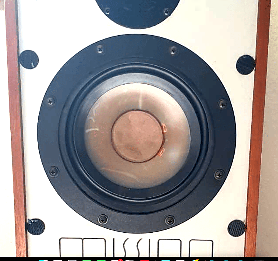

1.) There seem to be scratches or discoloring on the bass. See the first picture. Is that an issue? Or signs that it got hit or something?

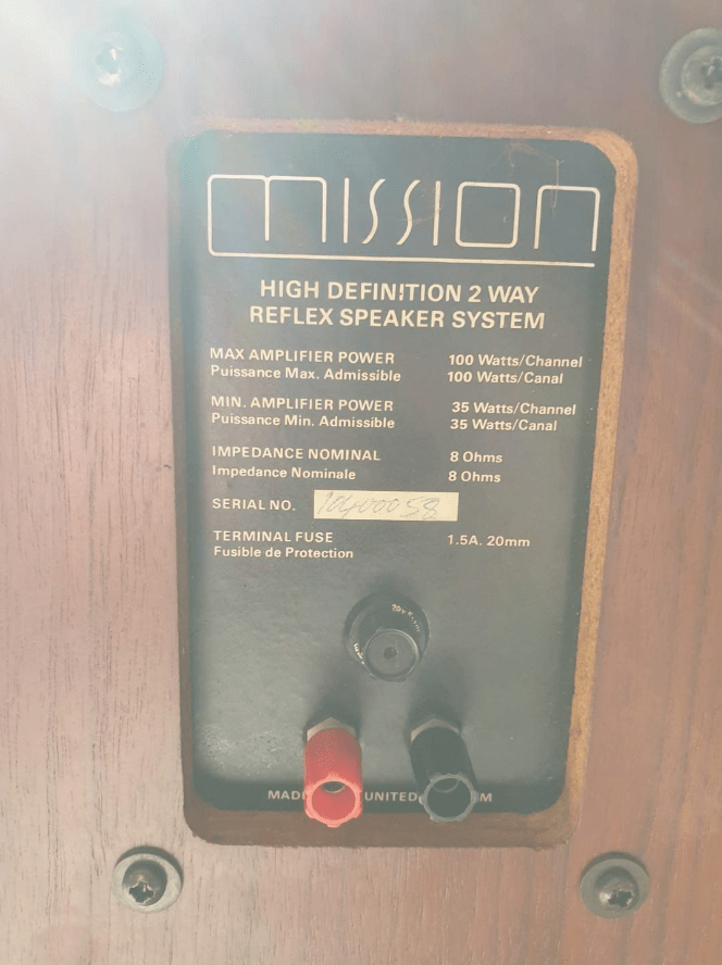

2.) The owner does not know what version and from when exactly they are. But the handwritten serial number looks like it is from a really early stage.

TU-8200R has maybe 8 watts/ch. Back of that speakers says min. 35 watts, so that's a bit on the low side.5.) Can I drive those with an Elekit TU-820R or is that a bit on the lower side?

1) The surface of the polypropylene cone may simply be dirty or the material may be discoloured with age.

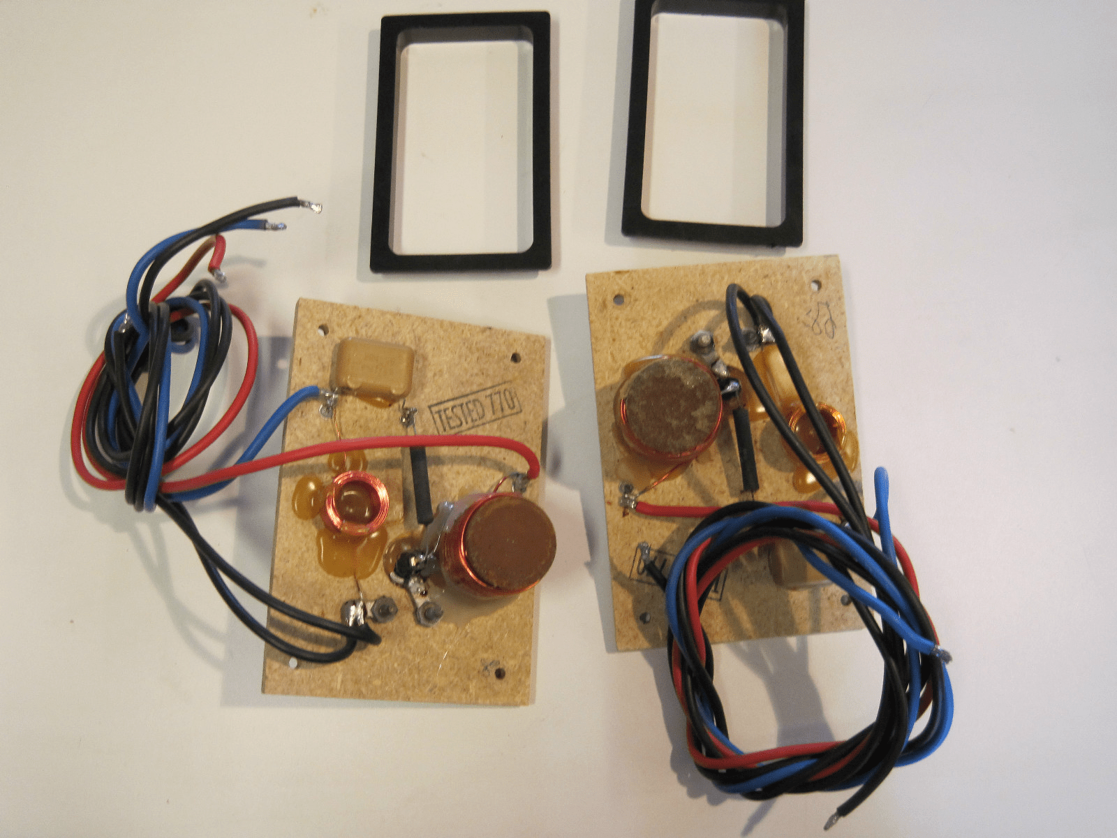

3) The tan coloured capacitor shown in the following crossover board image is a film type which does not deteriorate with age.

It looks like the dust cap is crumpled/pushed in also. Probably still works OK, but is a sign the speaker may have lived a bit of a rough life.Or signs that it got hit or something?
Same pic, but contrast adjusted and sharpened.

The Mission 770 has a sensitivity of 89 dB: https://www.hifiengine.com/manual_library/mission/770.shtml
8 W will give an SPL of 88 dB at a listening distance of 3 m, and that's considered to be very loud.
Not for Rock or EDM it's not. Fine for general listening thou.8 W will give an SPL of 88 dB at a listening distance of 3 m, and that's considered to be very loud.

Aside from listening to them and seeing if the tweeters work, and you can put your hand over the tweeters to do this, I would gently push the bass cones in with three fingers and listen for voice-coil rubbing.
Which can sometimes be cured by rotating the bass driver 90 degrees.
These old SEAS 104mm tweeters often have dried up and solidified ferrofluid, which is easily replaced.
I guess it's a SEAS P21RE 8 ohm polycone bass, which quite resembles the newer paper CA22RNY in response:
The bashed in dustcap is easily pulled out with a bent pin and a bit of glue over the resulting hole. Vacuum cleaners can do the job too, apparently.

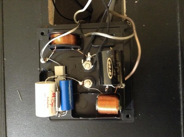

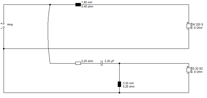

The crossover resembles this third order 3kHz approach with a 1.5A SB fuse in front of the tweeter filter.:

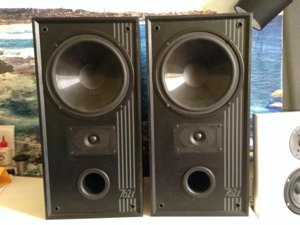

I looked into the Mission 762i and it looks a goodish polycone 8" plus metal 1":
Crossover is OK, being 1-2mH coil plus (10uF?) capacitor and a damping resistor in shunt, to overcome the bass voice-coil inductance. Tweeter is typical 5.6-6.8uF Capacitor and resistor (2.2R?) series, and small (0.2mH?) coil in shunt. Probably positive polarity BW3, but I don't know.
The enthusiast here has been upgrading to MKP capacitors...

Thanks for that info about the 762i. They are decent good speakers for their age (31 years old). Especially for the price I paid back when I bought them new from my confirmation money.
I'll have to decide whether to get a bigger amp and then a new speaker or else. I will try my 8W tubes at a friend's place over the weekend with his Wharfdale Linton 85 to see how well that'll work.
But maybe I'll check my 762i and keep them for a while longer. What do you mean with the carpet? Putting carpet on the inside walls?

system7's image of the reworked 762i crossover is contained in the link below.
https://www.stereonet.com/forums/topic/78227-price-drop-mission-762i-speakers-now-175/
The member simply says that good quality film capacitors have replaced the old electrolytics.

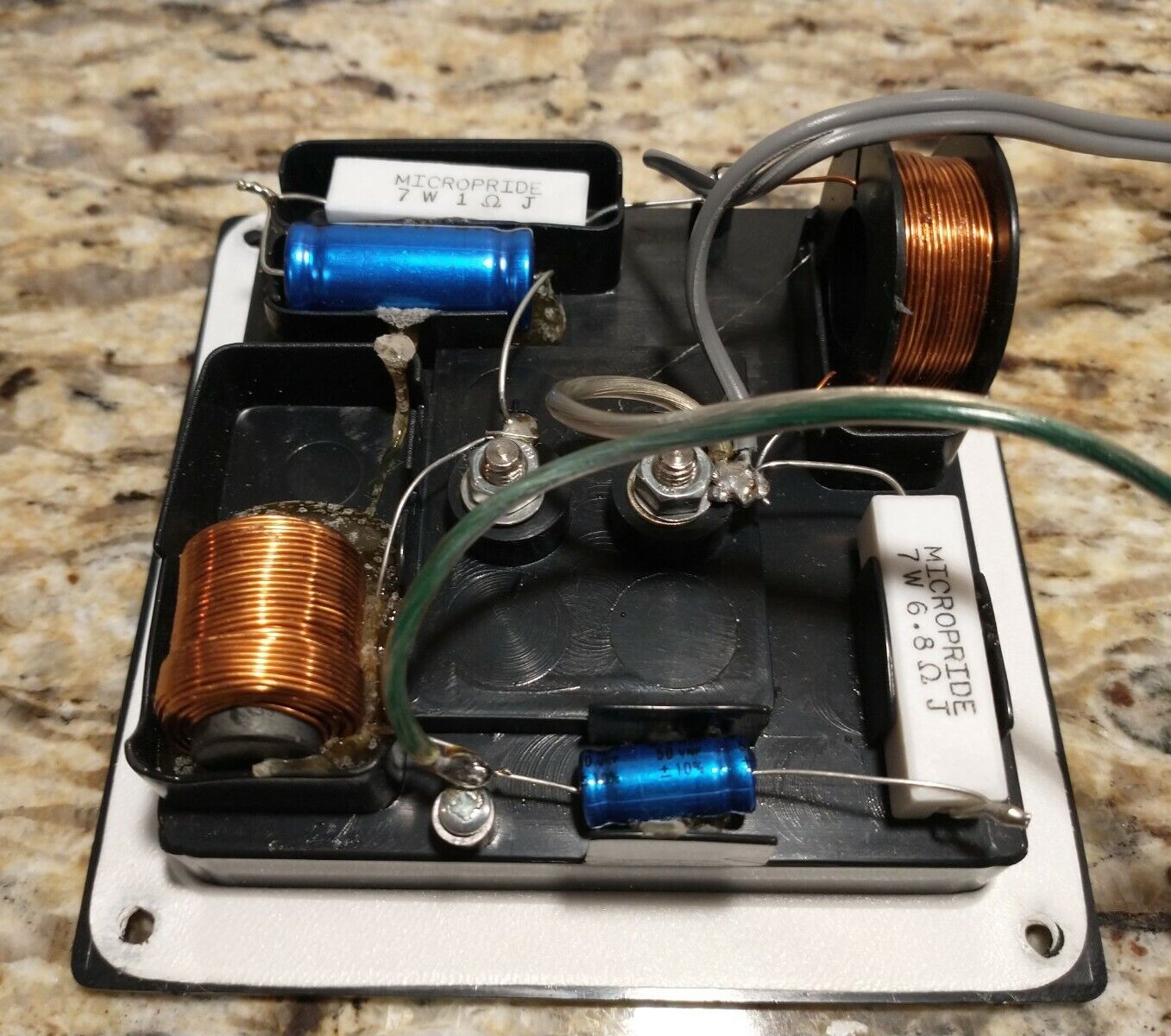

P.S. I've attached an image of an original 762i crossover which shows the two bipolar electrolytic capacitors that you may wish to upgrade. Dayton Audio polypropylene capacitors would be affordable substitutions: https://www.soundimports.eu/en/cros...J7*MTcxMzE4NTIwNy4xLjEuMTcxMzE4NTI4MS4wLjAuMA..
P.P.S. With a claimed sensitivity of 93 dB, the 762i will go loud with just a few watts.
