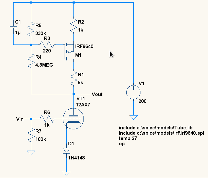

I just simulated the circuit posted by Rod Coleman in post #14. The difference is that I used a triode (12AX7 and 5751) in place of the pentode, and a 1N4148 diode instead of the LED (to get the proper bias range). I have attached the schematic.
As I predicted, performance is pretty variable depending on tube characteristics, and somewhat variable with temp. The output for a 12AX7 at 27°C is 130.095V and the tube current is 1.18mA. Running the temp up to 85°C gets us 123.996V and 1.67mA. In absolute terms it is a small amount, but given as a percentage it is a 5% change in voltage and a hefty 30% change in current.
If I replace the 1N4148 with a 507 ohm resistor (to get nearly the exact same operating conditions - in real life a common 510 ohm would be used), I get 130.182V and 1.17mA through the tube at 27°C. At 85° I get 128.771V and 1.35mA, which is a change of 1.1% and 14% respectively.
A 5751 has a mu of 70 vs 100 for the 12AX7. Gm is a bit lower as well (1200umhos vs 1600umhos). It's an admittedly wide variation, but one which works fine in most circuits. If we plug it in place of the 12AX7, put the 1N4148 back in place for bias, and set the temp back to 27° we get 121.872V and 1.77mA. Bumping the temp up to 85° results in 120.745 and 1.92mA. It seems that this circuit favors tubes with lower mu and/or gm. If I replace the diode with the same 507 ohm resistor used for the 12AX7 we get 124.835V and 1.56mA at 27° and 125.705V and 1.55mA.
Interestingly the current went down and the voltage up with increasing temp and the 5751. Nevertheless, the variation over temp with the lower mu tube and a cathode resistor is quite small. Also, variation between the 12AX7 and 5751 is less with the cathode resistor at any given temp vs diode bias.
I actually thought the temp variation would be higher than it is, while the variation with tube characteristics is about what I expected due to the fixed bias.
EDIT: I did some sims with a regular CCS. The "gyrator", which is really an operating-point compensating CCS, is indeed less sensitive to tube variation than a fixed CCS. However, both are more stable over temp with a bias resistor rather than a fixed bias diode. It's definitely an interesting variation for sure, but I will stick with pentode CCS's 😉
The purpose of the gyrator circuit is to provide all the advantages of a CCS-loaded stage, while permitting the use of fixed bias.
This is not a small difference.
With an ordinary CCS load, picking a random tube will be unlikely to result in an operating point where the full output swing of the stage is available. More likely, an unusable operating point with the CCS cut-off, or excessively LOW anode voltage will appear. You already identified that a cathode resistor/cap is needed to make a practical circuit - but that almost always means an electrolytic cap! The degradation in the sound from such a component choice is not acceptable for any of my designs, nor I suspect, for many others.
With the gyrator, a workable operating point is guaranteed for any reasonable sample, and with a predictable output swing. The gyrator simply matches the current that the triode demands, at the anode voltage we choose, using the pair of resistors.
Considering that we only have to add a couple of non-critical resistors, and a non-critical cap, I'd call that a good deal.

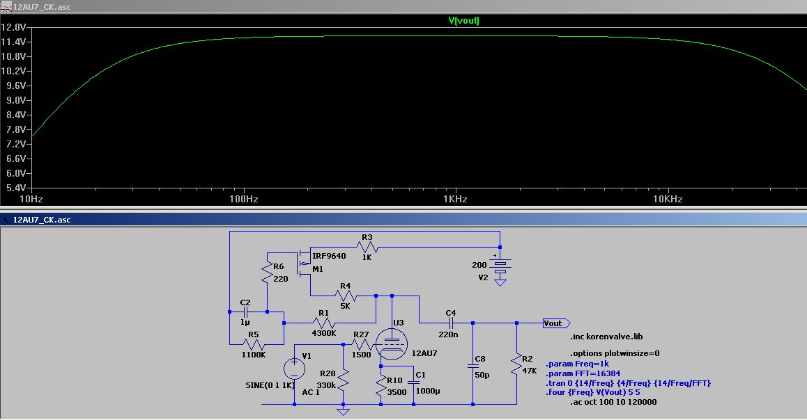

Well, after all of our talk about the hazard of simulations, you have just given us the perfect example!
Your simulations are valid only for the circuit in isolation - you must have forgotten to include the 47K resistor I noted (specified directly from the Ale's design).

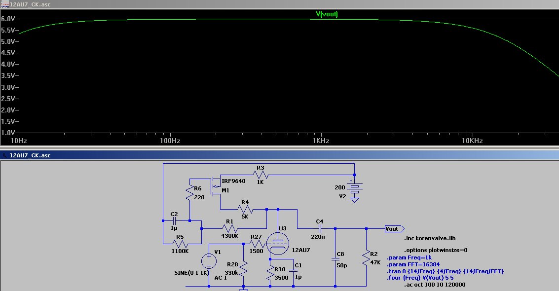

I have attached the output of what really happens - with the correct load of 47K. Now the gain is 11.6 with the bypass (or a LED), and 6 with no bypass.
What also shows up is that if a power valve is driven (as Ale also specified) a 50pF load rolls off the unbypassed circuit to -3dB at 26kHz, and 18kHz for 150pF. This is because the unbypassed cathode resistor increases the triode's anode resistance too. The resulting circuit would give very poor results in any real world application, and is best consigned to the waste basket - or /dev/null, for Linux hackers.

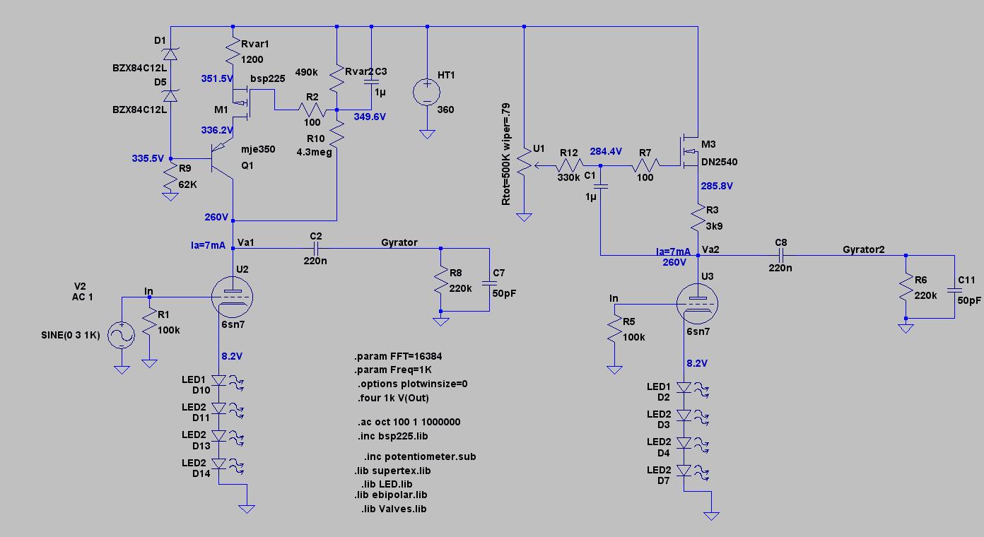

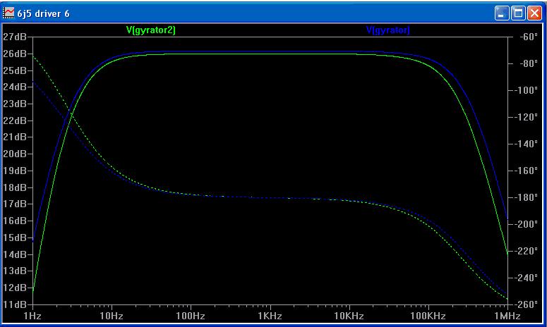

I have adjusted now the cascoded gyrator from previous post to my supply levels and also simulated the 45 output valve circuit (fixed bias) with a 220k resistor and an equivalent capacitance of about 50pF.
The optimal operating point for minimum distortion at full drive (anode voltage to around 100Vpp) is Va=260V and Ia=7mA based on my previous tests on a breadboard driver setup.
The gyrator 1 (left circuit) is Wavebourn's and the gyrator 2 (right) is the mosfet version that many are using as well.
If I connect the output of the gyrator 2 from the mosfet source, the setup is now a mu-follower which I read is better for output valve drivers. You can see in the simulations that the frequency response is improved if you connect the output capacitor in the mosfet source and not in the 6J5 anode.
I'm planning to build both version so I can test and listen to differences.
Would you recommend mu-follower? Any changes before I etch a couple of PCBs?
Also, have seen others bypassing the LEDs with a good capacitor. I have a couple of 33uF PIO which could use. They don't impact clearly on the frequency response due to the low dynamic resistance of the LED arrays, however I bet they do contribute to the sound. Any recommendations based on your experience?
Thanks for the help....
Ale
No disadvantage to the mu follower, but much lower output impedance.
Sheldon
+better PSRR, +less of parts that means lower cost and higher reliability.
On currents higher than 10 mA I prefer version number 2 (source follower configuration), on lower currents I prefer version 1 (P-type configuration).
Hi Anatoly,
You have been away for some time! Rod has kindly helped me out with your gyrator. Now I got the basics for SMD soldering for the bsp225 MOSFET.
Any particular reason why you prefer version 1 on lower currents?
Ale
