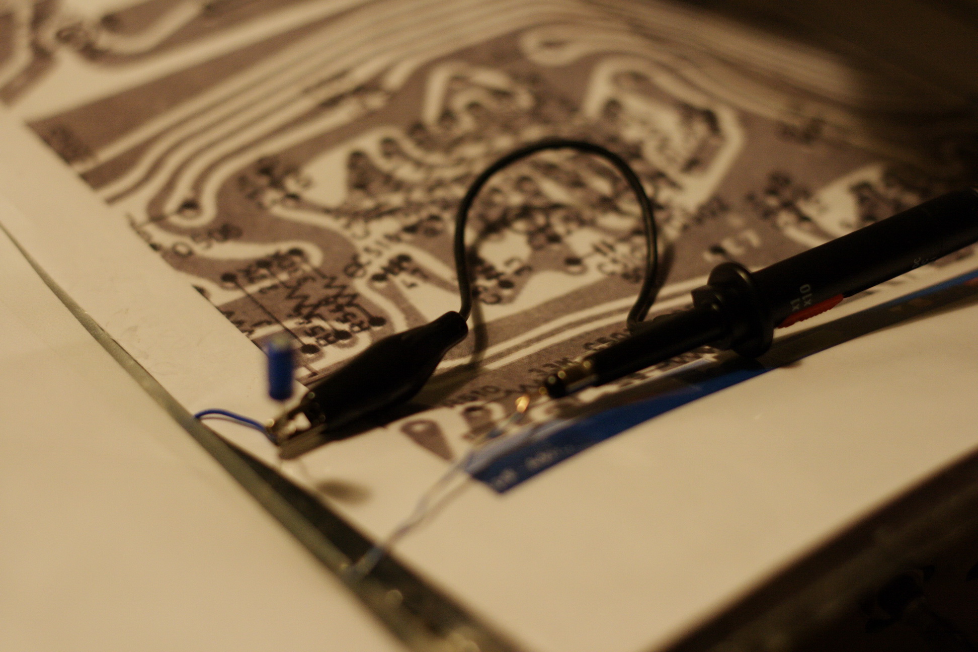

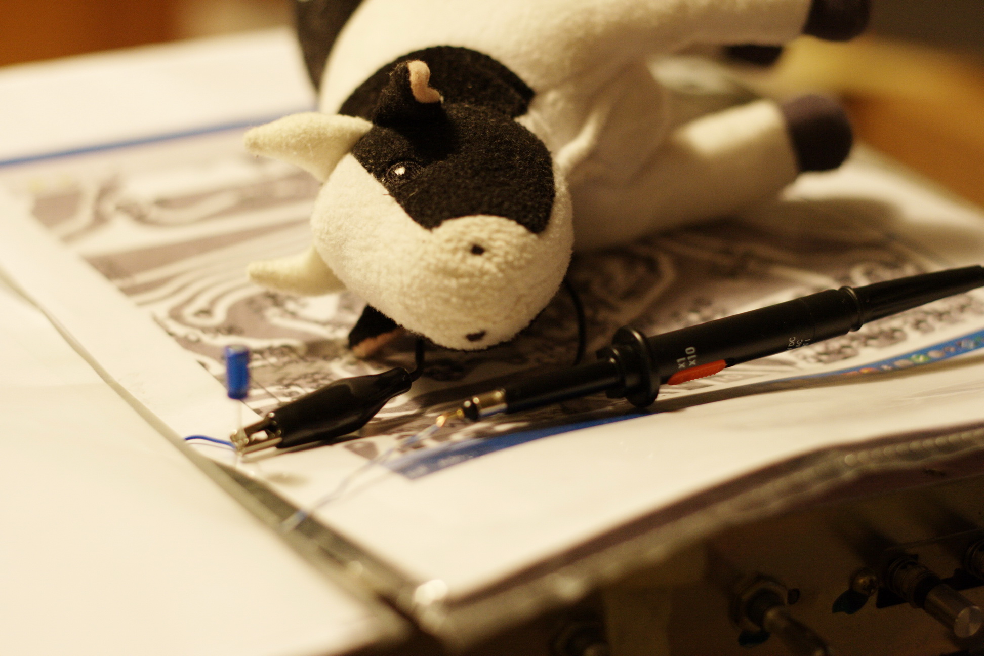

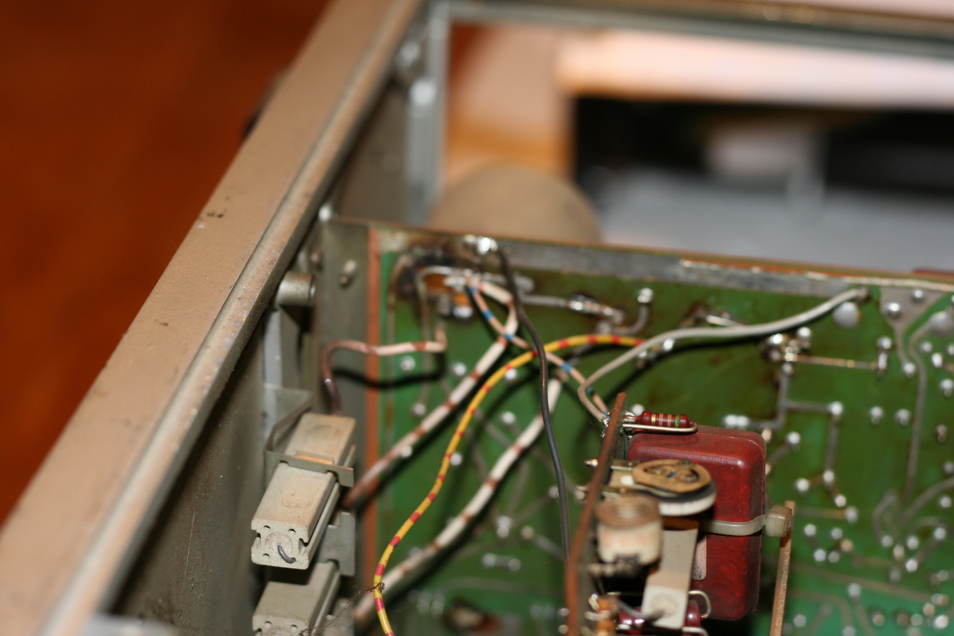

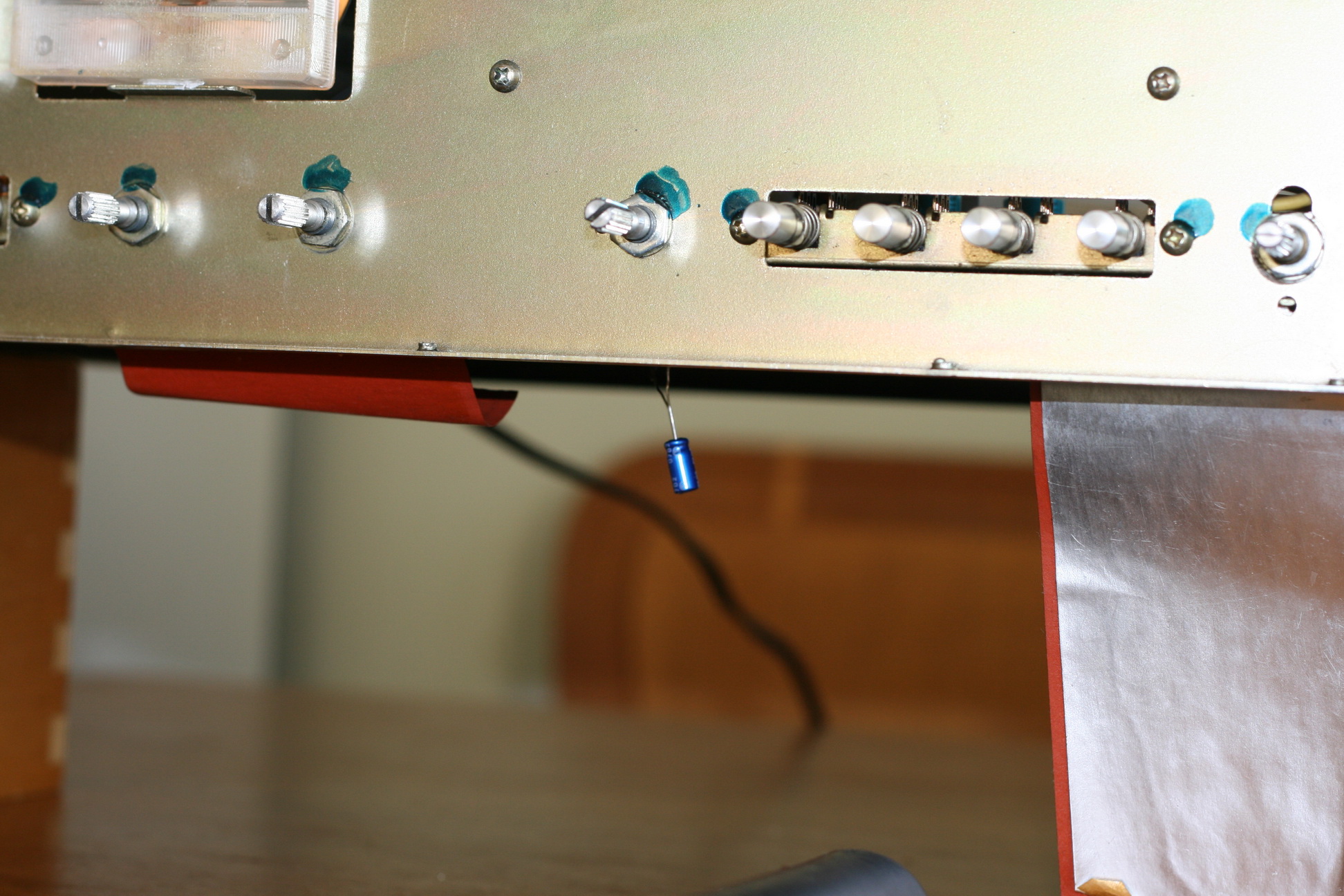

Remember that C506 hack you wanted me to do, since I already had a wire there going from ground of R516 I used that for alligator clip.

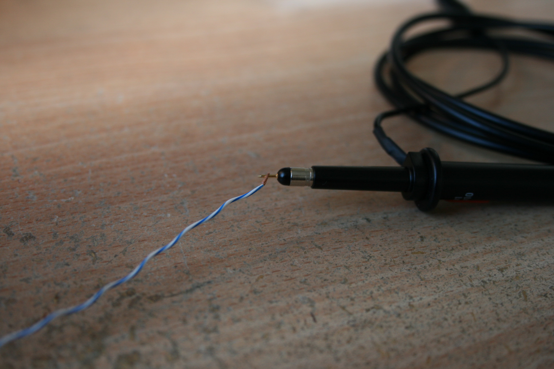

I soldered a piece of wire from C518 that went to the tip of positive probe of the scope, and later did the same for collector of Q506.
Both tests with 1V/div and 2mV/div gave straight line showing no signal.
If it sounds complicated, I have pictures
Soldering wire on the probe... Eeek

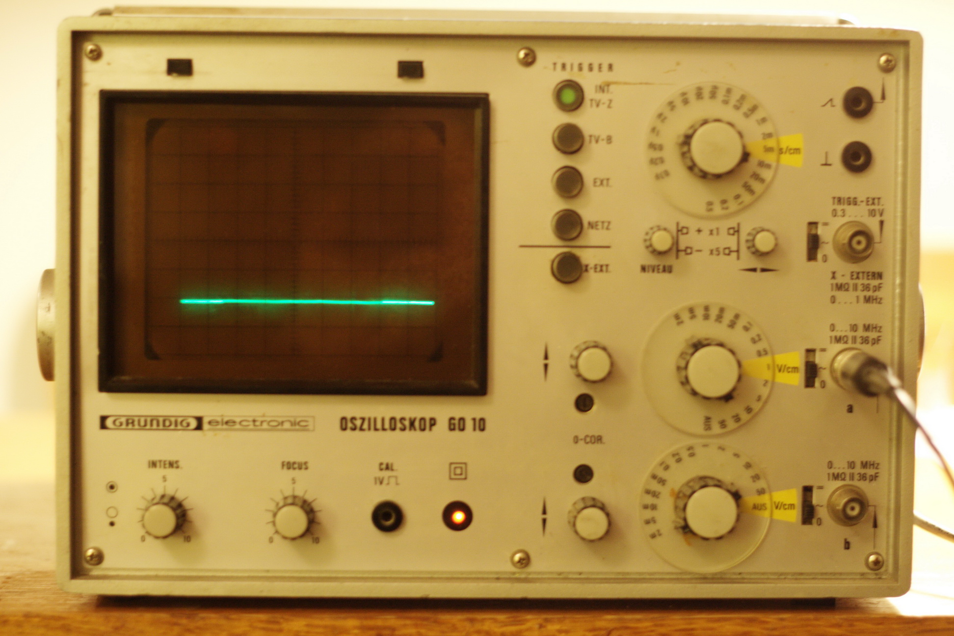

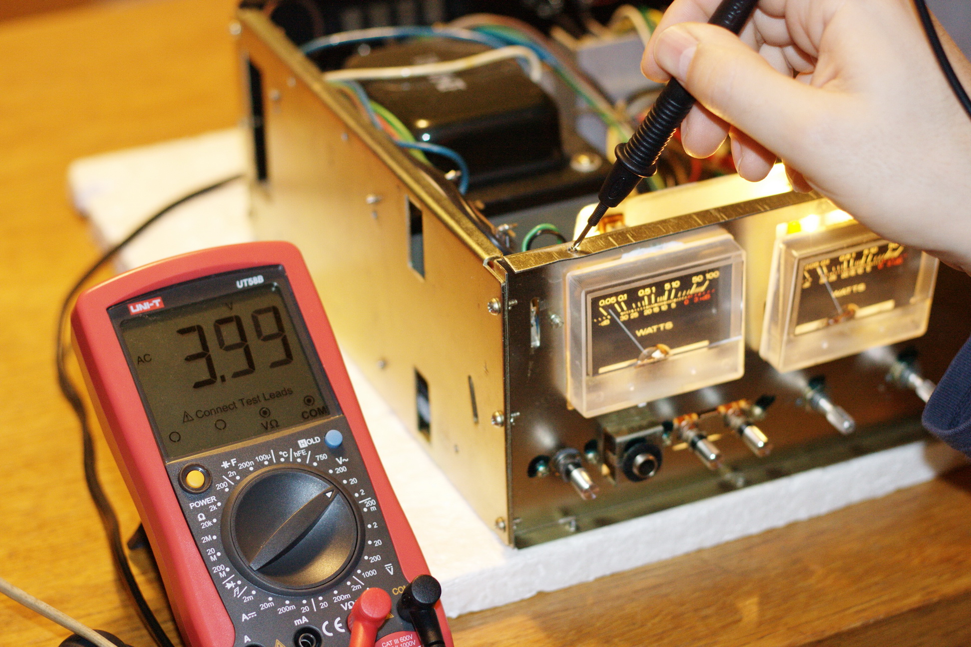

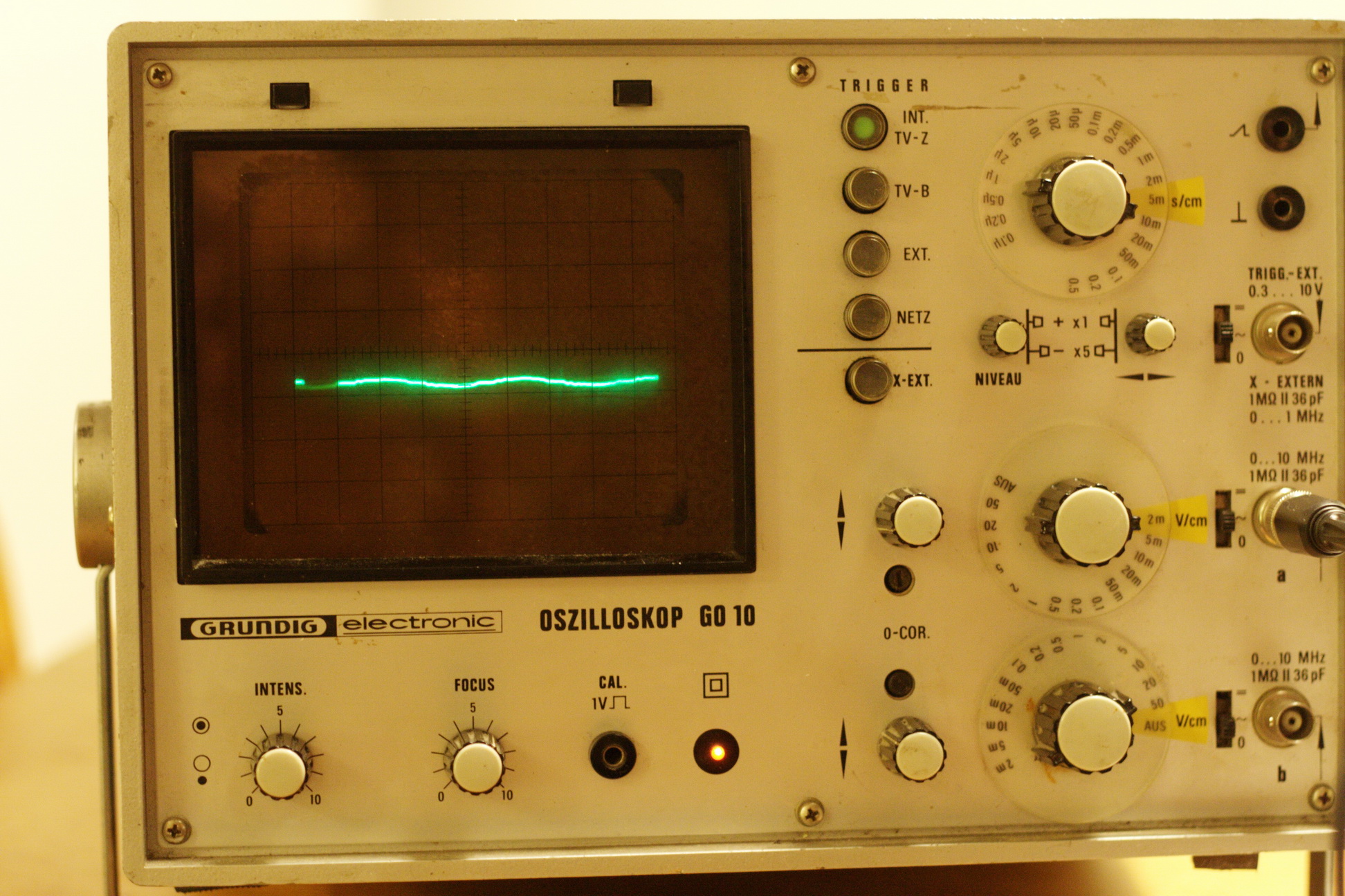

Is that a friend helpng you (picture 2)
Yes, that is a friend inspecting my work, feels safer that way

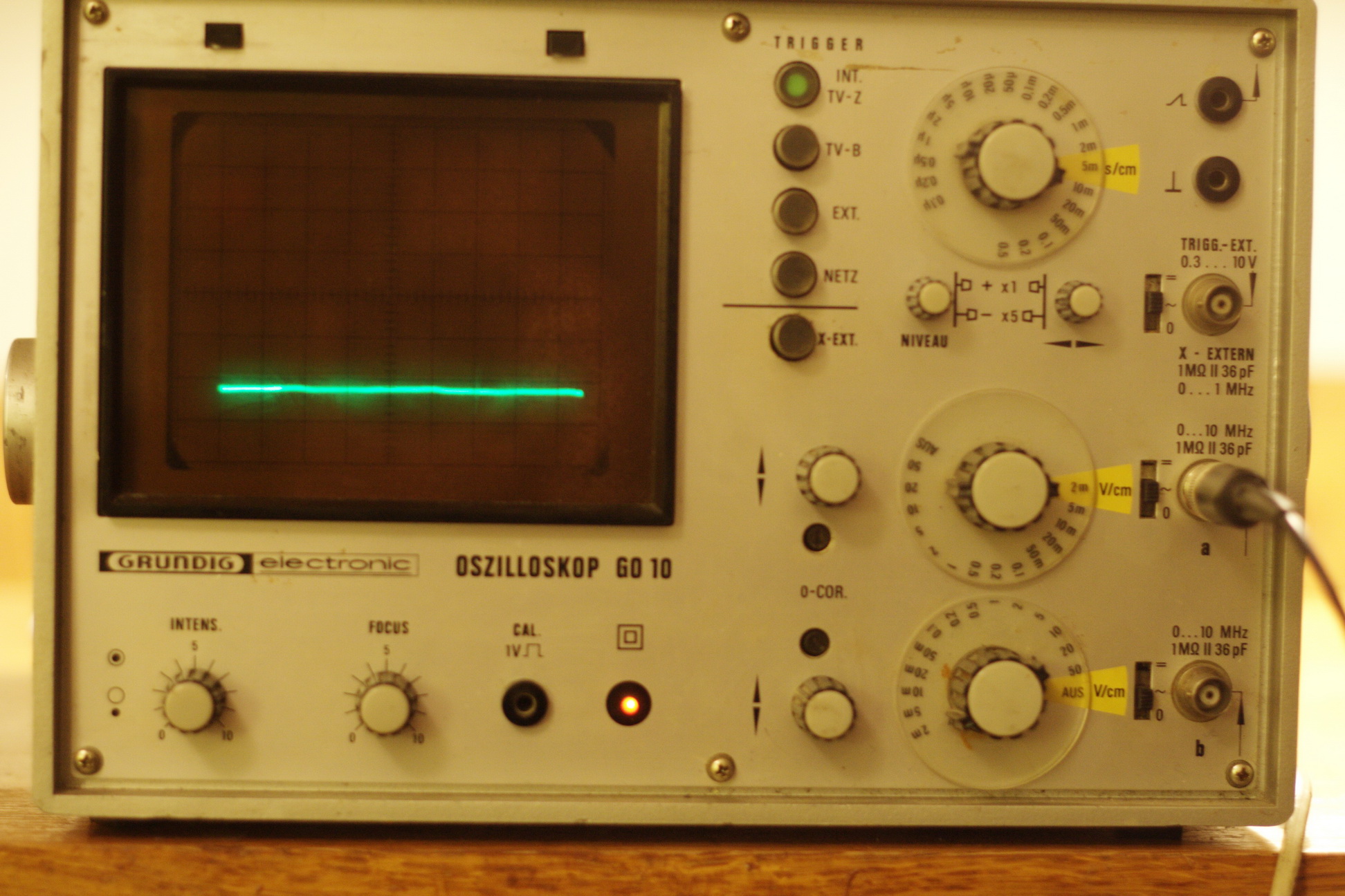

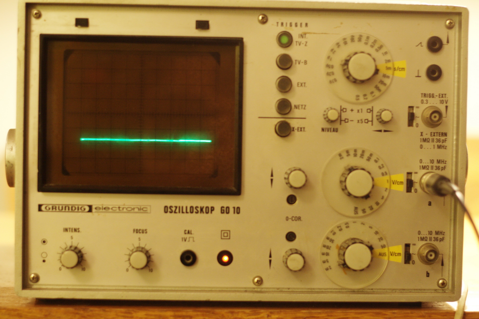

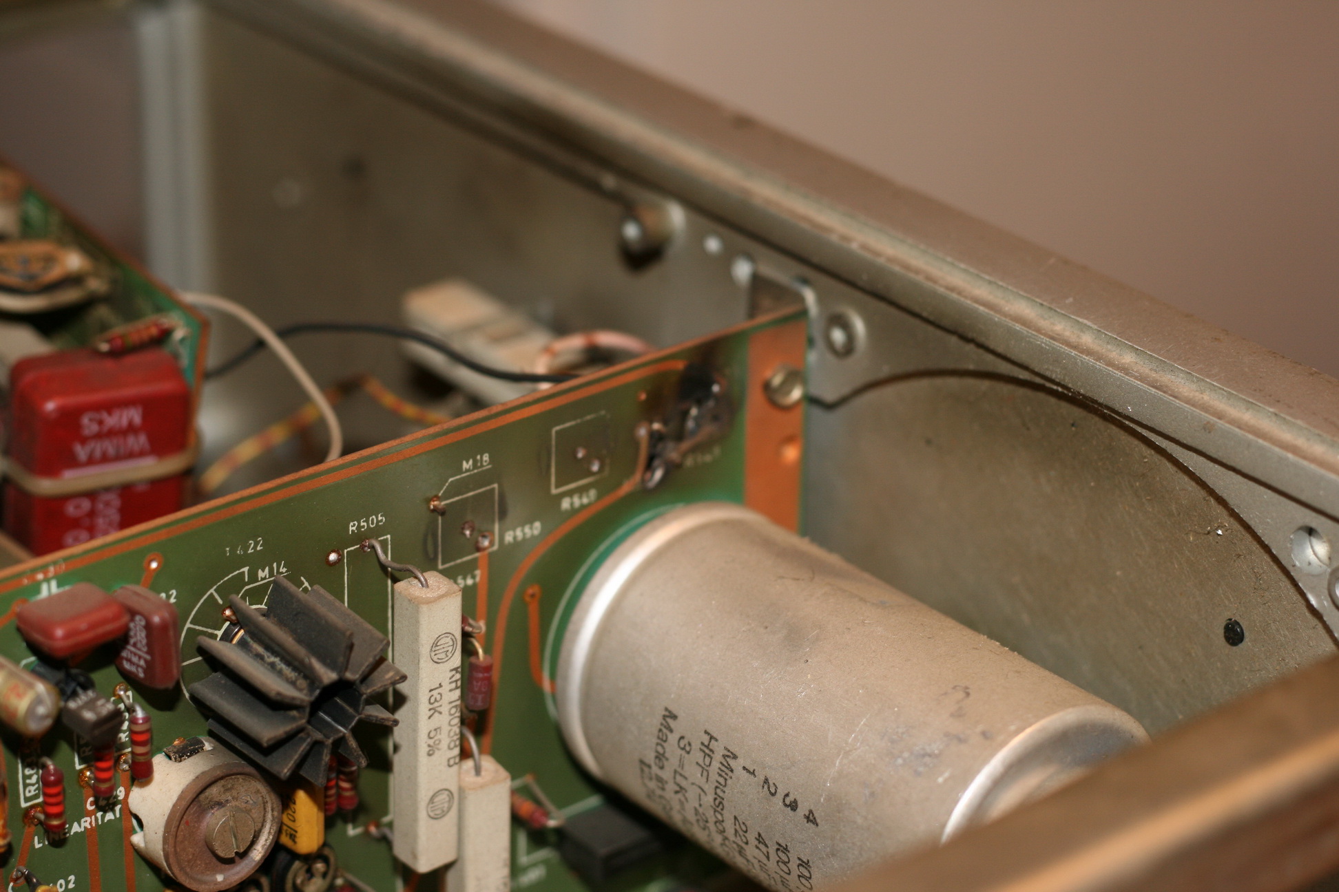

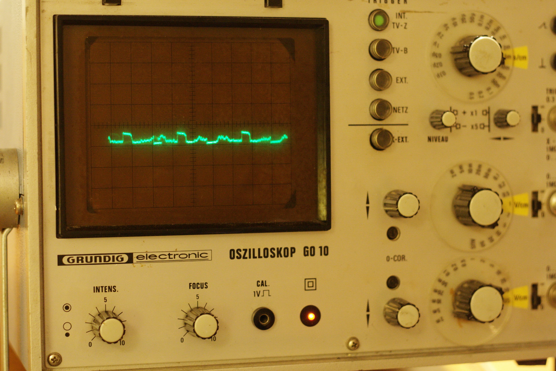

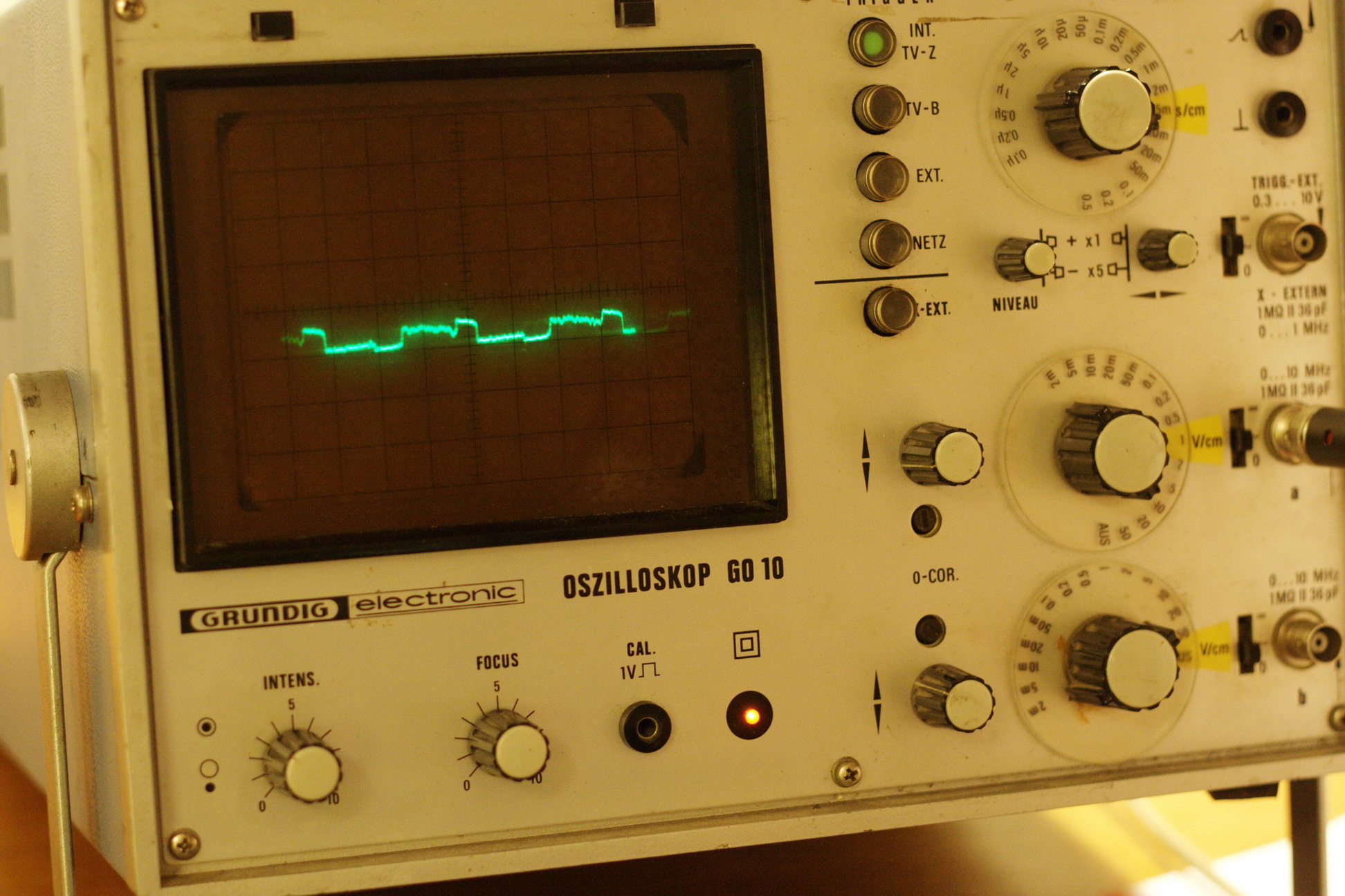

At 1V/div line was straight at 2mv/div my wife started taking pictures
That looks just like white noise (hiss) and a small 50Hz hum component at low amplitude.

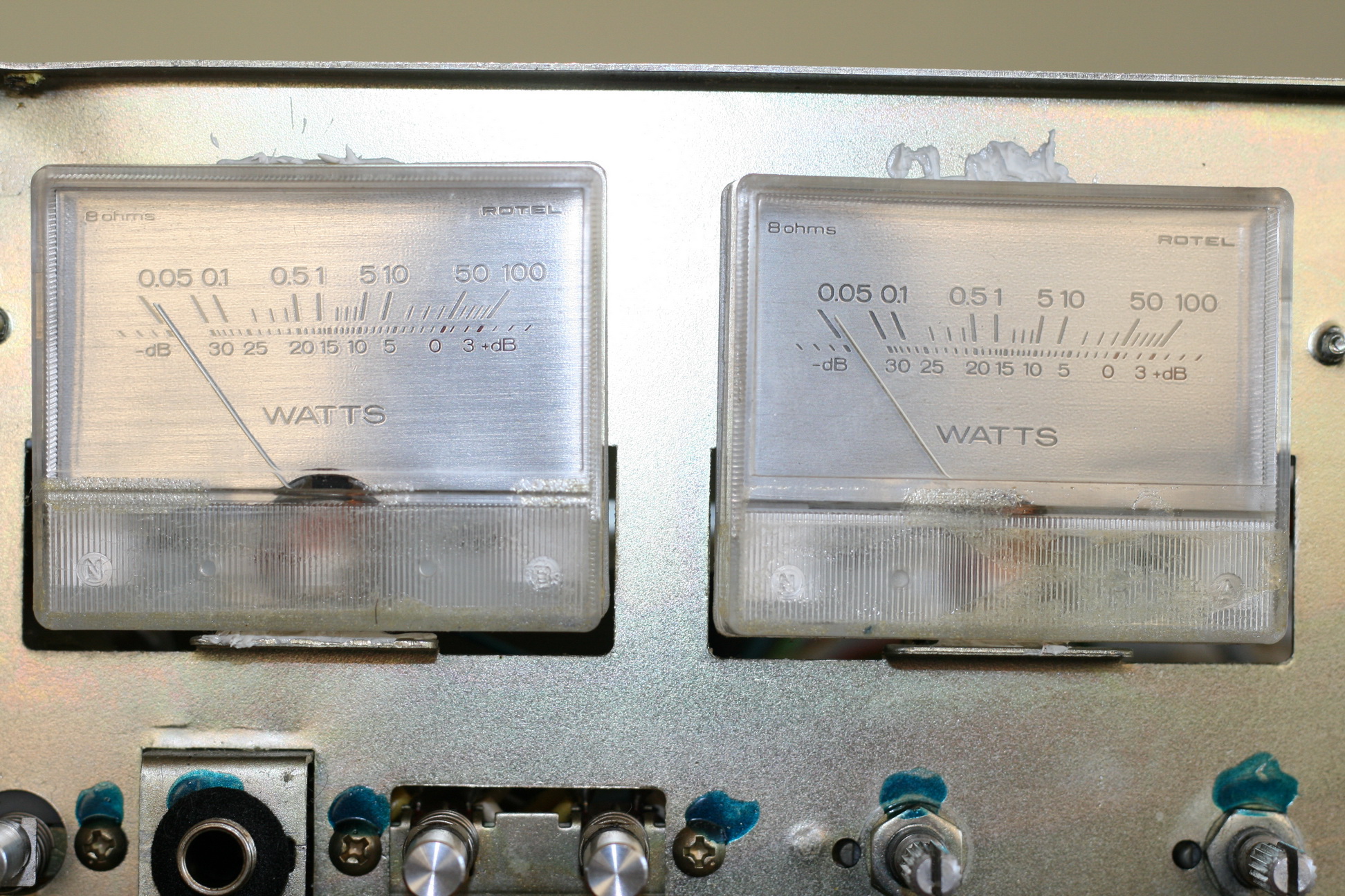

Was the VU meter mis-behaving and showing a reading ?
Is C506 still connected to ground ?
Actually no, I took pictures with amp off and on. Although when I try to rotate the volume pot with no signal I am getting a reading that corresponds to pot turning but only in left channel now.

I will reconnect C506 to its proper position.

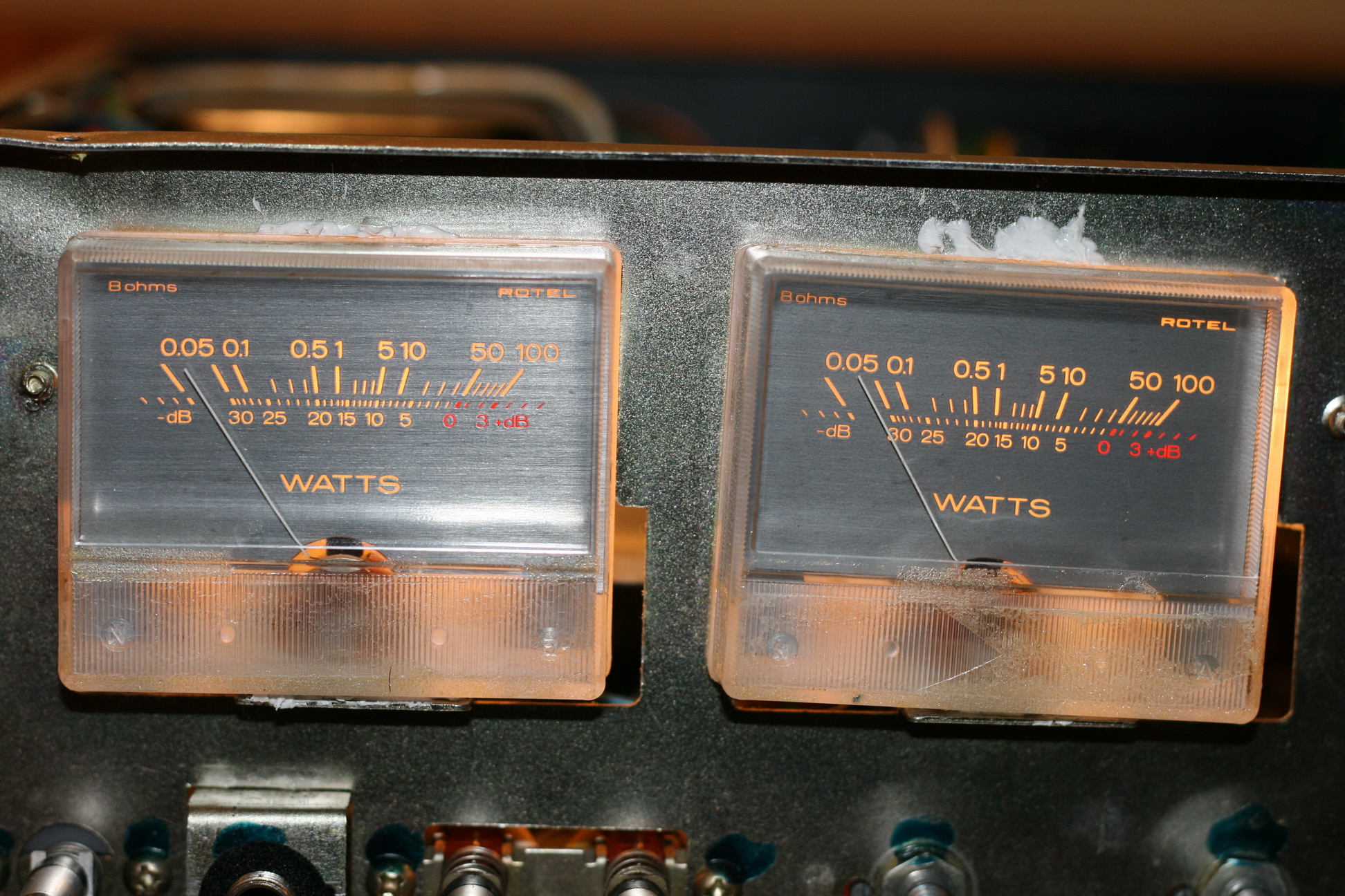

One specific fault that should be traceable is the VU meter reading,
"I left the amplifier turned on over night and in the morning the right vu-meter needle was closer to zero, imagine my vu-meters have a scale from 0 to 10, immediately after powering on my left channel is on 1 and right on 3. In the morning left was on 0 and right on 1, and this time needles were jumping up with volume up or down with volume down (without any input). Looks like what ever DC is there it was lower after the amplifier was on for eight hours.
Is this problem still present ? I read this to mean that the meter was showing a reading even if the volume was turned down (or up) and the control untouched.

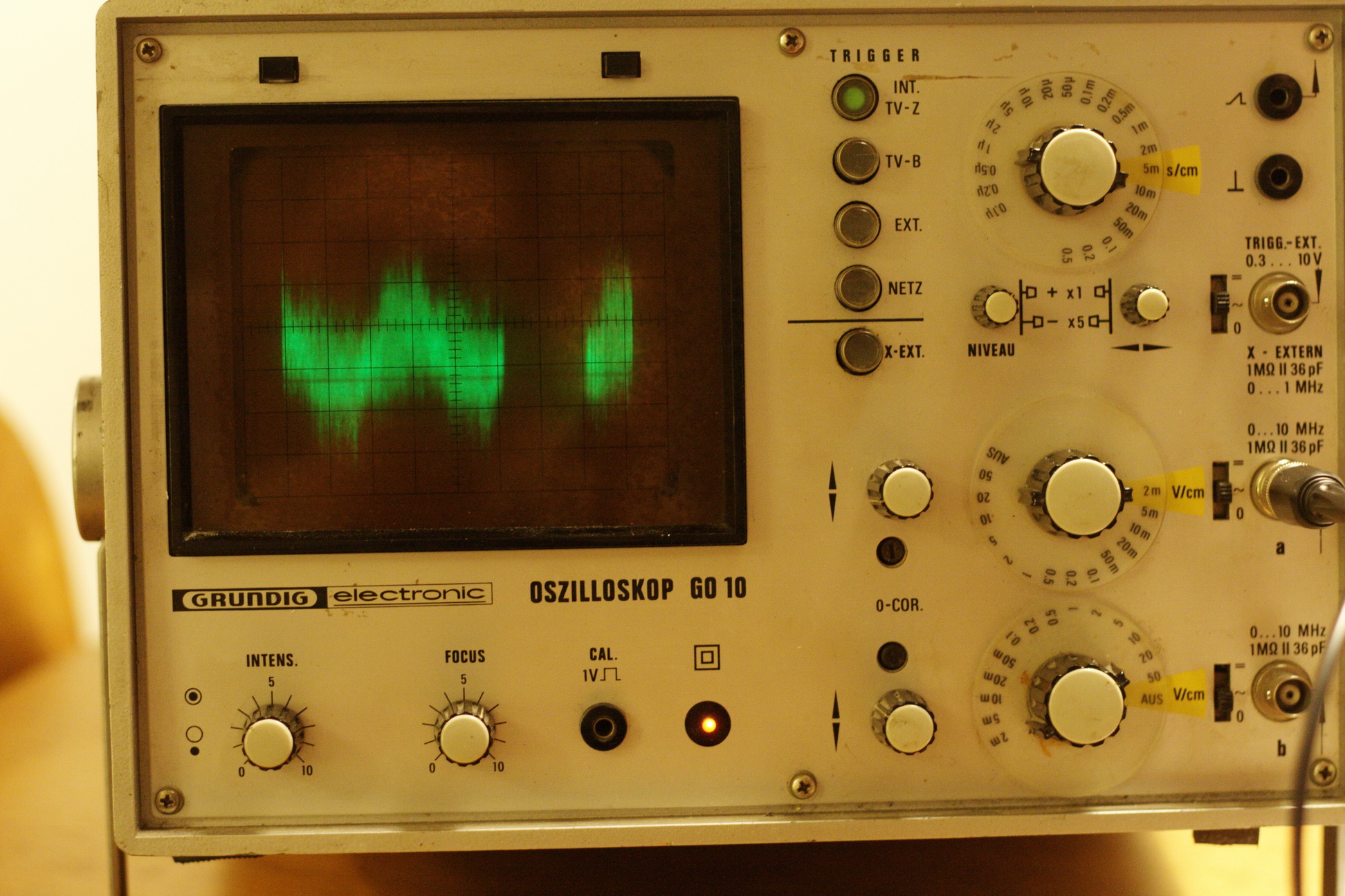

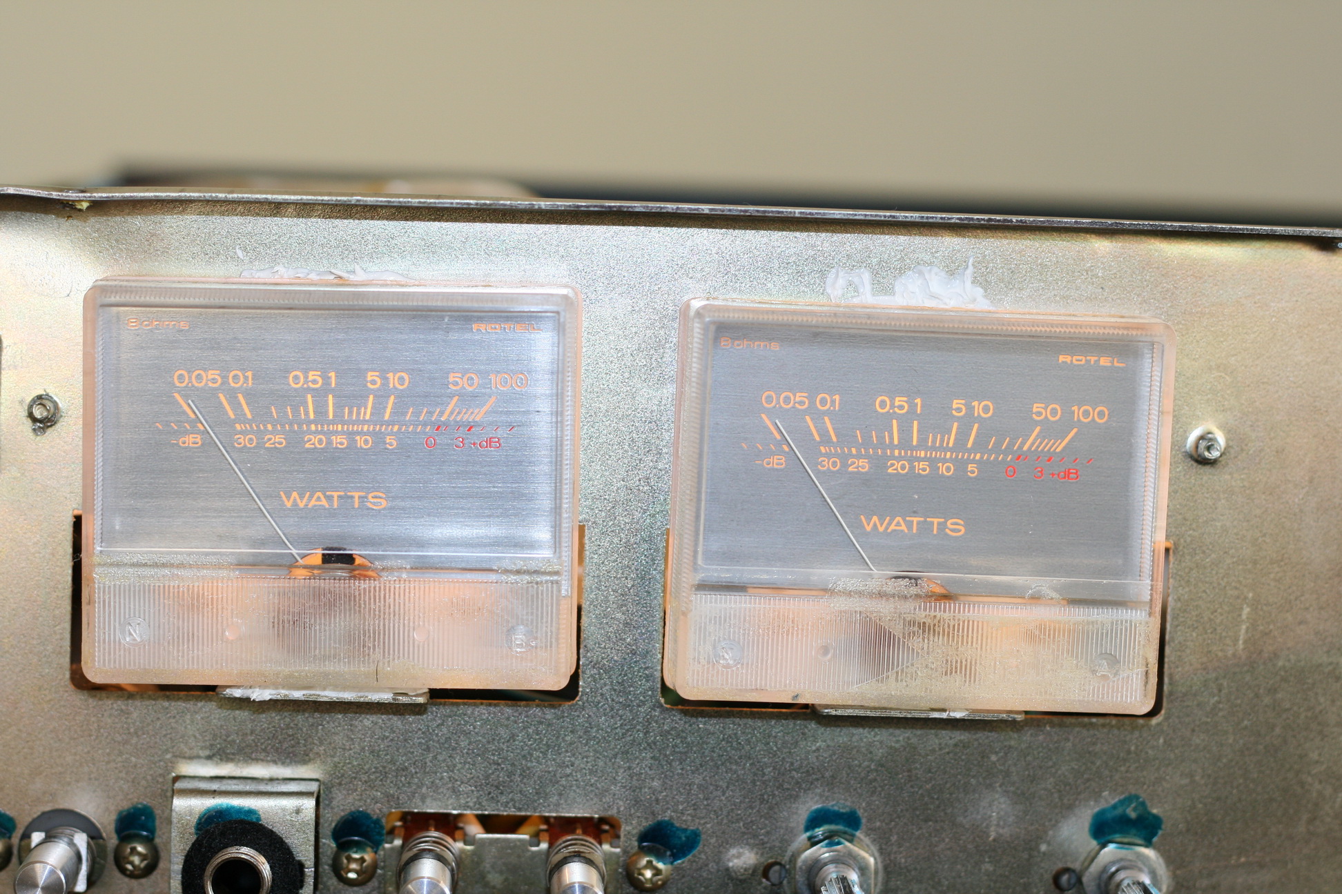

C506 back in and the VU-meter reading is still present, I took pictures for you to see. I believe the reason why the needle did not zeroed in immediately after we removed C506 is because the amp was upside down all along. I will leave amplifier on overnight to see whether the readings will be lower in the morning. You understood right, no input and the control untouched and the reading is there.
Noise of the switch is still there, more so in the right channel, more so when the unit is colder. Louder pop (or thump) is heard while the switch is being depressed then while being pressed in.
I took AC reading with DMM, just ground probe on chassis gives me 3.99V, normal or not?

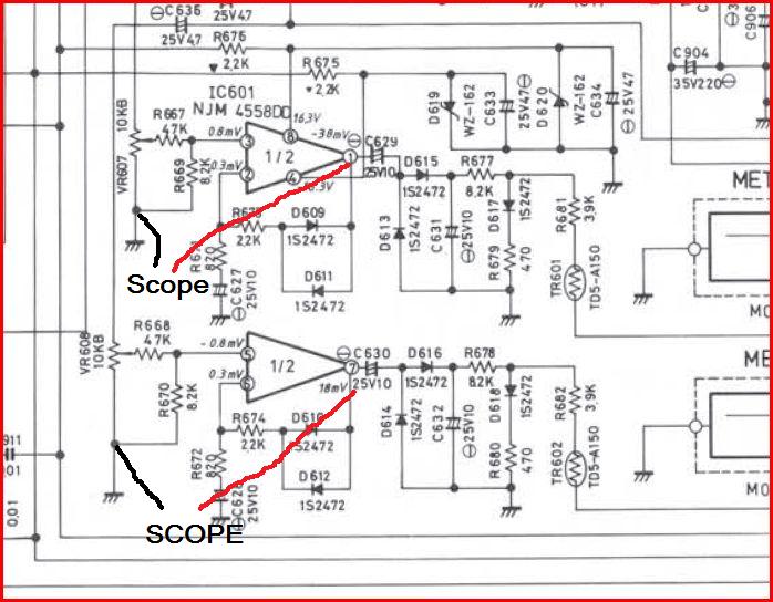

Lets work on the VU meters first. Also is it possible that the VU meters are sticking ? Just trying to cover every posibility here. When you power up they probably flick up a little. If you tap the meters do they settle to a lower reading ?
We will prove if there is a problem or not
Diagram shows where to connect scope probe. We will use the correct ground for each meter circuit and look at the output of the opamps. The scope should show no AC signal. If you also measure with your DVM on DC volts there should be NO voltage across either C631 or C632.
Those two checks will prove conclusively whether the VU meter reading is caused by an AC signal, a DC problem around the opamp or the meter physically sticking.
The meter reading just probing the chassis is normal if the other meter lead is just floating around. It's just stray pickup.

"C506 back in". So the amp is all connected back up as original and ready to go ?
Connect scope across either R529 or R530 in the preamp (depending which channel you are looking at). Connect ground of scope to bottom end of resistor. Set the scope to 0.1V/div initially and the time to 5 or 10m S/div.
If you operate the filter switch can you see the scope jump and show a spike or click as the switch is operated ? Can you see what the amplitude is approximately? Also if you rotate the volume control can you see any disturbance. How big if so ?

You are right, it is possible that VU-meters are sticking. Only left flickers when I power up, if I tap on plastic cover they settle. I played music observing meters and the right one is definitely lazier than the left.
I am getting AC reading on pin 7 and on pin 1 of op-amp to their respective grounds, see pictures. I am also getting DC reading of 1.1mV across C631 and across C632.
"C506 back in" means returned to factory default position We are ready to launch.
Scope across R530 with 5mV/div and time of 5 S/div:
pressing in 1/4 of a square up
depressing 2 squares down
Scope across R529 with 5mV/div and time of 5 S/div:
no visible jumping
If I rotate volume pot in both channels I can see what you described once commenting the picture I took as a white noise with the amplitude of about 2 squares with 5mV/div and time of 5 S/div scope setting.
The meter measurements are OK although it does sound like they are sticking a little.
On that basis we have to say there is no electrical problem showing and that the meter "problem" is mechanical.

R529, LEFT channel with no jumping is silent with speakers connected and the switch is operated.
With C518 out of circuit the scope still jumps measuring across R530, amplitude is smaller, but I am seeing a spike while depressing switch which I don't recall seeing yesterday.
I also measured across R530 with DVM now without C518, I am getting 00.1mV of DC, before it was 14mV if you remeber.
Position of "High Filter" does not have any effect on scope reading.
