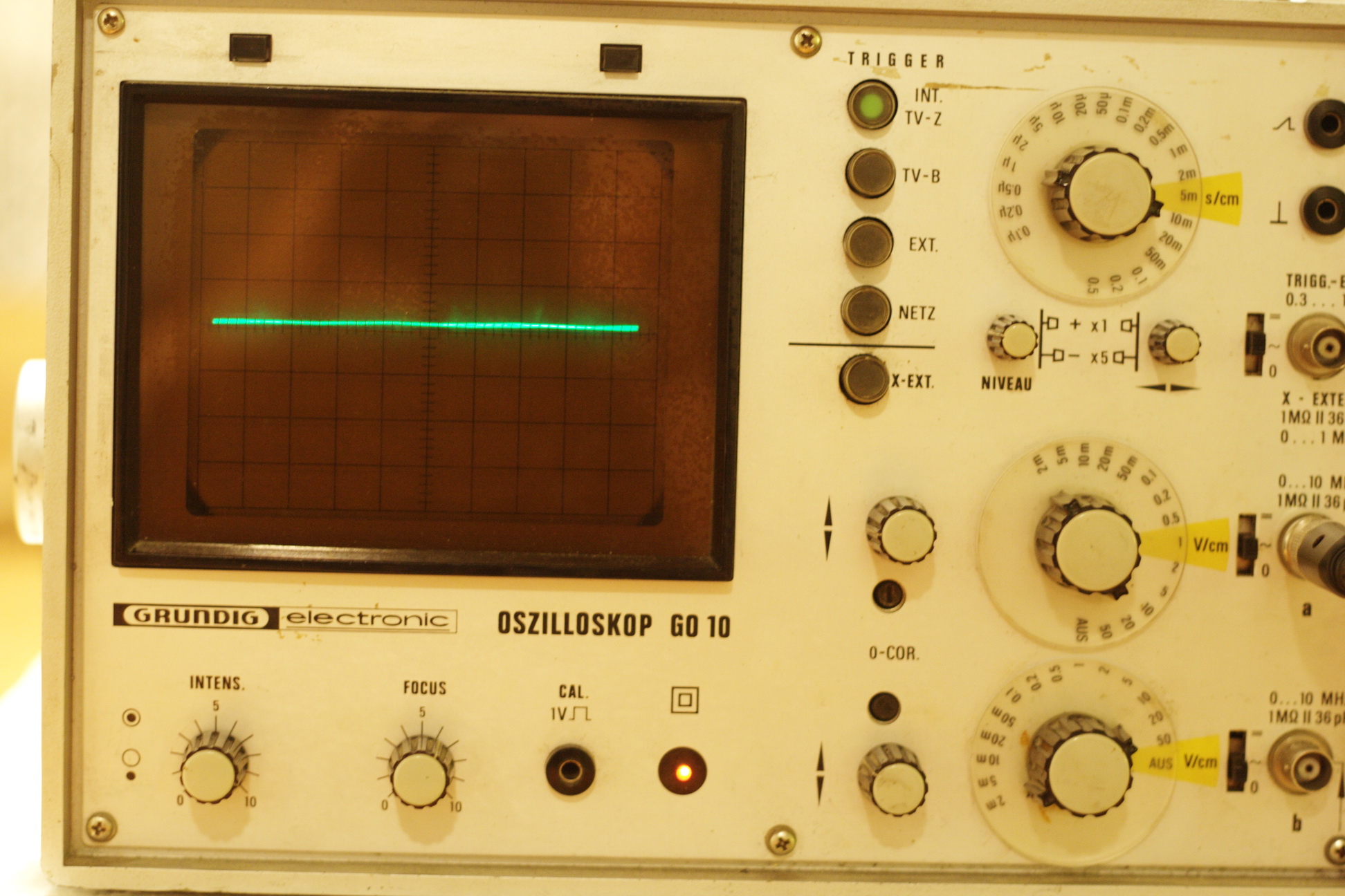

First you need to familiarise yourself with the controls.
Connect the probe (use the left hand one in your pic with a X1/10 switch on it) to terminal marked "A" on the scope. It's a dual or two channel scope by the way. We will use channel A although both are identical.
Make sure the probe is in X1 position. The other position on the probe marked X10 divides the signal by 10. We will use X1 for now.
Switch the scope on. Does a trace appear ? Don't have it too bright.
Set the two V/cm controls to 1/Vcm as in picture.
Set the S/cm knob to 5S/cm as in picture.
Set the three small slide switches to AC which is the middle position.
Without using it I'm not sure how the trigger controls work but you want "Int" trigger so press the top trigger button in.
The two small knobs below S/cm want to be pushed in.
You should have a line across the screen. What does AUS mean ? language problem as there should be a way of turning off channel B

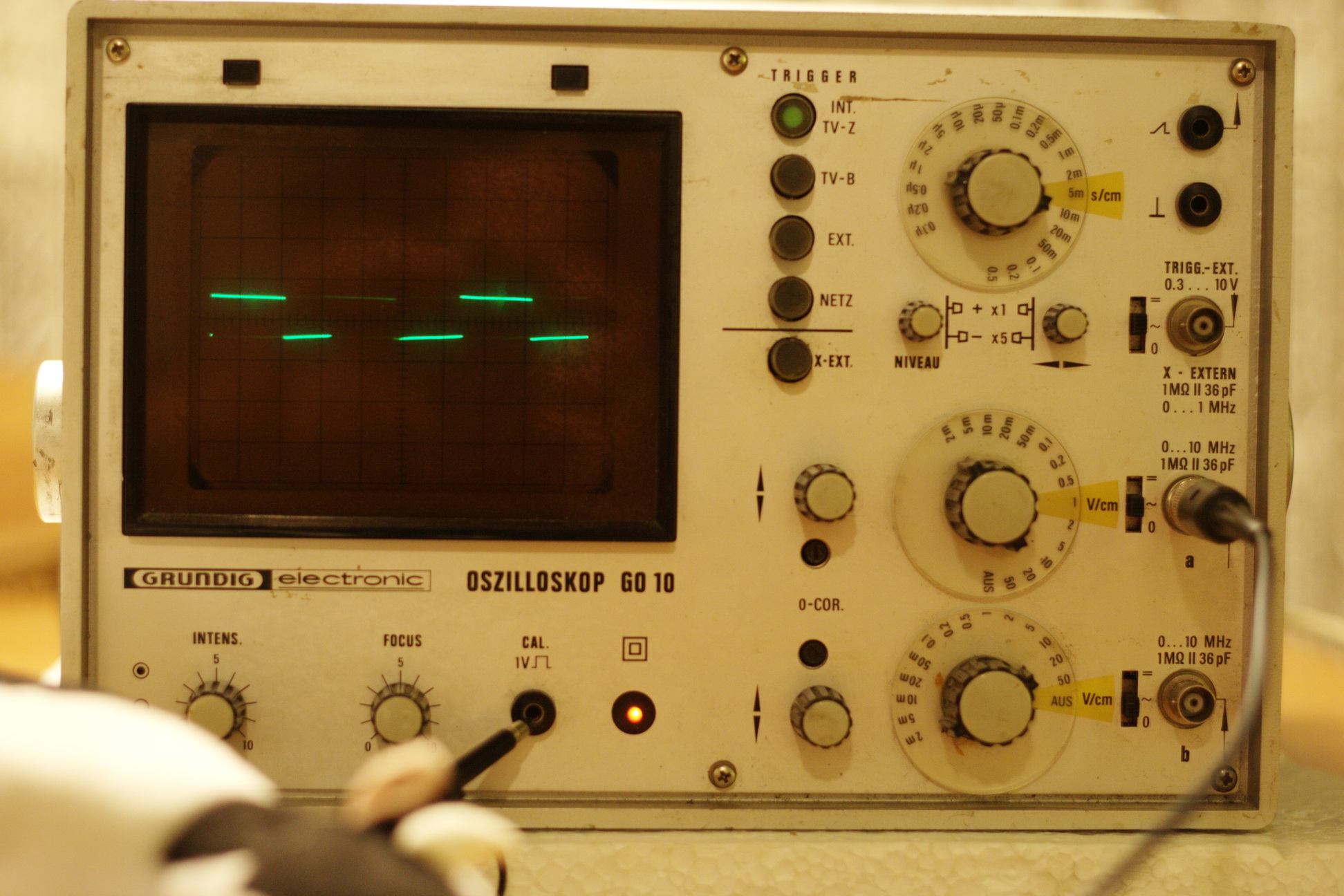

If you now connect the probe tip to the front socket marked "CAL" (calibration signal) the trace should trace out a squarewave on the screen.
The CAL output is 1 volt peak to peak so the trace should be deflecting or showing 1 "squares worth" of signal. It doesn't show the frequency so we can work that out later. It will probably be either 1Khz or maybe even just 50/60 hz... it could be anything.
If you adjust the S/cm control that will alter the speed the spot (trace) moves across the screen. The trigger control (Niveau ???) should allow the trace to be "locked" so that the display is stable.

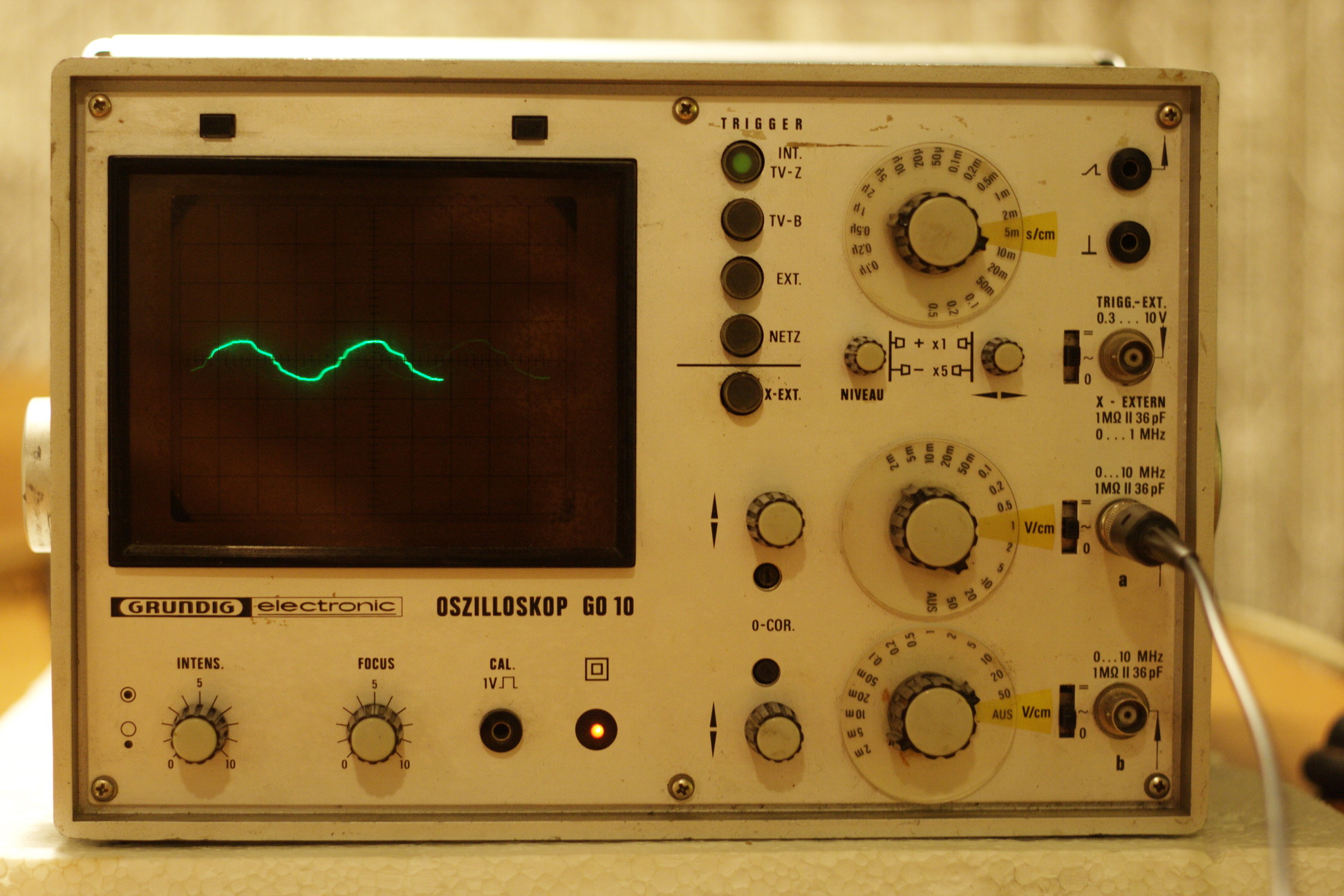

That looks OK, certainly usable.
Picture 1. OK
Picture 2. I think OK. Is it an effect of the camera photographing a moving spot that part of the trace is "missing" ? The amplitude is 1 volt peak to peak as it should be. You are seeing the scope show the voltage alternately jump from zero to 1 volt and then back to zero again repeateadly.
Picture 3. Same as above. Is it an effect of the camera that part of trace is missing. It is showing that "you" are picking up the household 50/60hz mains supply that is all around.
Now we'll work the frequency out.
Look at picture 3. Pick any point on the waveform and count how many squares along the horizontal axis until that same point on the waveform is reached again. I make it about 3.4 squares.
So 3.4 times 5 milliseconds per division (the S/cm setting) is 3.4*5e-3 which is 0.017 seconds.
The frequency is 1/T (just the reciprocal) so 1/0.017 is 58.8 Hz. So I'm guessing your on 60 Hz mains over there. Within the accuracy of looking at a screen and the accuracy of an uncalibrated scope thats very acceptable result.
Picture 2 looks the same frequency so we can deduce the CAL signal will be derived off the mains transformer and just squared up. A squarewave should jump between the two voltages instantly and so that is what you see.

1. Thank God
2. It is indeed an effect of the camera, I was worried because vertical lines were missing
3. Another effect of the camera, we have 50 Hz mains here
As for the frequency I will count precisely those squares and get back.
I tried all trigger controls while looking at the screen and they all looked very similar to me.
If it's 50Hz mains then one cycle should be 20 milliseconds (F=1/T), so that would (should) be four squares at 5ms/div. If the scopes a little inaccurate it doesn't matter.
The setting for trigger controls matters far more for higher frequency signals. What the trigger circuit does is start the spot sweeping across the screen at the same point on the waveform and so the waveform appears locked and stationery on screen.
There should be a calibration adjustment to get close to the correct 4 squares for the full 50Hz cycle...........If it's 50Hz mains then one cycle should be 20 milliseconds (F=1/T), so that would (should) be four squares at 5ms/div.
You can then check the accuracy of the two or three horizontal steps either side of that. The step accuracy of the switches is usually pretty good.
Mooly and Andrew,
It is definitely 50Hz mains, looking at pictures I also counted just 3 squares between cycles, and it is easier for me to count squares on the pictures because the waveform is far from stationery even in slowest mode which is adjusted by the niveau button.

Wouldn't like to say without first hand look. DC offset (for minimal drift) maybe.
Markings on front panel... on/off rotary/brightness

The horizontal axis is time.
Timebase uses values like 5ms/cm or 2us/cm (div = cm square)
The vertical axis is voltage
Voltage uses values like 2mV/cm or 5V/cm
The two Trim Pots next to the vertical adjustment knobs look like vertical (voltage) trimmers.
We need to try and find a horizontal trimmer, so that a 50Hz signal fits the correct number of div (cm squares).
Let's investigate what the vertical adjustments do.
Set your 1Vpp test signal height by using the switch setting of 1V/cm it should jump up and down 1 square. Set the switch to 2V/cm. It should now jump up and down by half a square.
set to 0.5V/cm, gives 2quares
set to 0.2V/cm, gives 5squares. You may have to adjust the position pots to keep the test signal on the screen.
If you set to 0.1V/cm, the square wave test signal should go at least partly off screen. You should have 8div (cm squares) in the vertical direction, which on the 0.1V/div gives a total range on the display of 800mVpp. Just a bit less than the 1V test signal.
The vertical position adjusters should be able to bring one of the horizontal voltage back on to screen.
Check out this part of the operation and come back and confirm you understand this and the scope does as expected.
