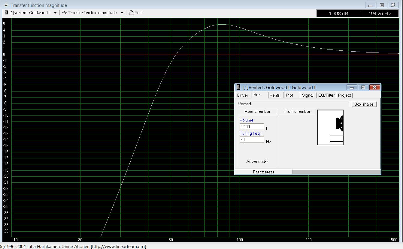

Thanks, I've done the baffle step sim, it does change things somewhat, as expected. I also remembered I had a motorola piezo horn tweeter in the garage, so tried to do an impedance measurement.

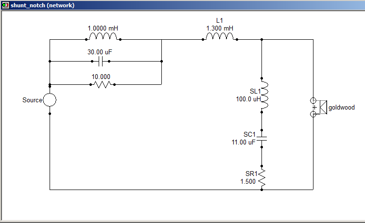

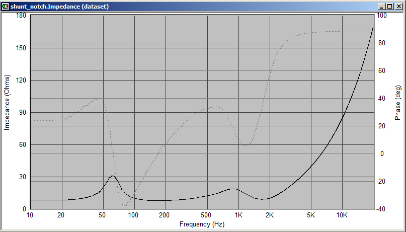

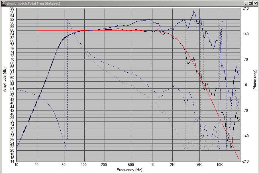

OK Getting somewhere now Note that until I do the tweeter however, this is just a progress report.
The blue curve is the adjusted for full baffle step. Black is with the crossover network (as you can see I've done full BSC!, but as this is a boom box that is probably best).
I took the same aproach to dealing with the baffle step that I did with my MTM's ie a notch filter. Perhaps not the most conventional approach but it worked ok for them, and seems to work ok here.
The first couple of iterations had an unacceptably low impedance around 2Khz (about 3 ohms) this variation has no such problem. I've also made sure that all caps and coils are standard values.
I changed to a 4th order L/R acoustic slope.

Note that I think that this baffle step adjusted curve was with a 53Hz tuning (spliced in) for the lower part of the curve. 53Hz seemed to be the best I could find in between the original 42Hz I was thinking about and Chris' 60Hz tuning.

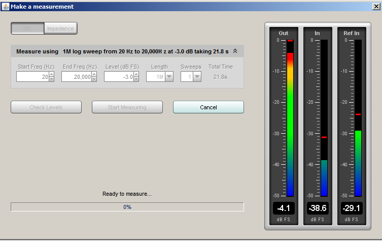

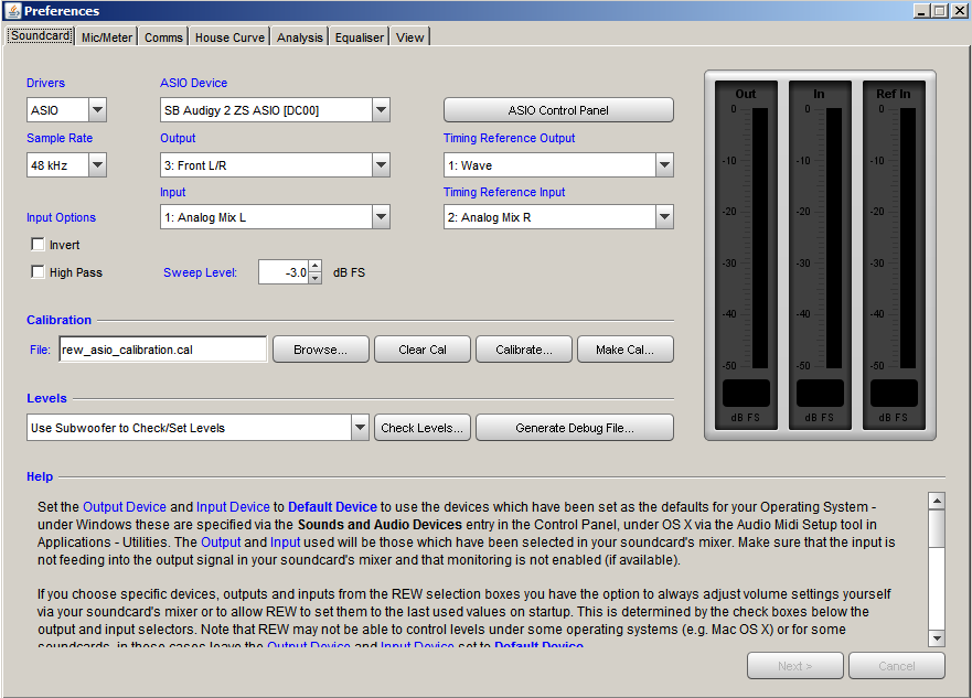

I'm using my computer's onboard sound hardware, and after struggling with a feedback loop for a while I managed to get a semi-normal curve after calibration.
Looking at the online help for the program, the next step is level adjustment. When I check levels the returned curve is way off - much too loud. Also, when I tried my new impedance cable, I got the test tone going through the tweeter, but measurement never really completed - I got an error / warning message saying that the level was far too low (-99db) and that I should check to see if my right / left channels were reversed. I'm pretty sure the channels were fine.
Perhaps I'll try to get a cheap(ish) sound card and give it a try not running off my motherboard.
Any thoughts?

On borad sound should be ok for impedance measurements. I actually can't remember if I calibrated (I think I did) but I definitely didn't worry about the spl calibration.
I've used trial and error to work out what settings seem to give the best measurements. For my sound card, I set the record levels to 50% Line in to about 60% and volume to around 10% I think.
If your card has an option for record without monitoring then make sure it is ticked.
Did you go into the preferences for REW and make sure that what it has for playback and recording seems to be what you expect? relying on windows defaults may not work.

OK I have had a look at REW. Apparently I did perform the calibration as I have a cal file enabled. I haven't done an spl calibration though, and it is not necessary for impedance measurements.

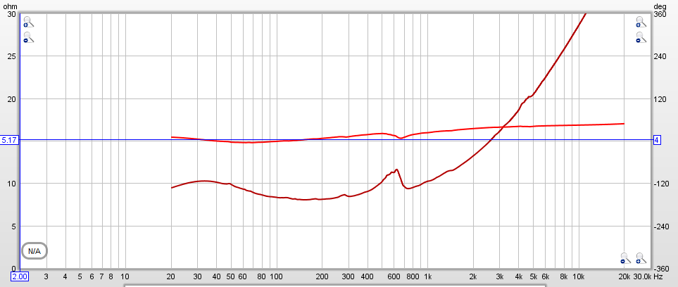

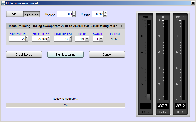

I've attached a screenshot of the settings I use for doing the impedance measurement. and also a plot that I just did of my little bass reflex project that has stalled....
Also I attached a picture of how the levels looked when I did a check levels.
You should get a pretty smooth result like the attached.
My levels were set at 50 for recording, 50 for line in, 20 for volume. All other inputs muted.
Are you using the java drivers? I'm using ASIO but they were a PITA to set up! What is working for my Audigy II sound card is also attached. Java drivers should be easier to get going though.
When I measured the tweeter the other night it took me a while to get things working. In the end I realised that the problem was I had my input and output mixed up The speaker still made noise, and the levels sort of showed but the reference level showed nothing.
I think by default it only outputs on one channel too, so if you are getting nothing on the recording levels try switching the input channel

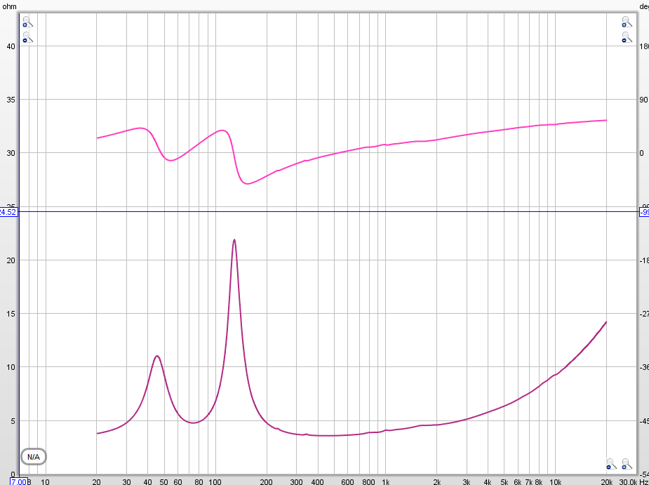

I put in a cheapo Sound Blaster Audigy 2 SE card and had some success with the setup. I'm not sure if I've managed to get anywhere with the impedance graph.
link to tweeter measurements are attached.

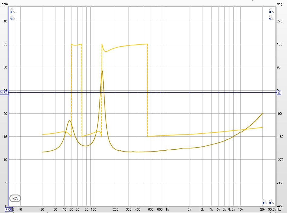

Hi Shaolin, you are almost there. It looks like you have the left and right channels (recording) reversed. The impedance is reading higher and the phase -180 degrees as a result.
I just tried myself to make sure this was the problem. See attached graphs. The one with the phase above the impedance plot and lower overall impedance is the correct one.
Try reversing which channel is on the reference resistor and which on the driver, and I think you should be on the money.
Tony.

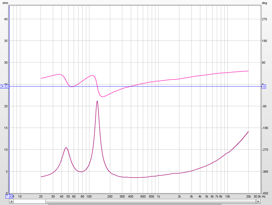

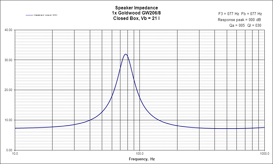

Hi Shaolin. I'm interested in that woofer measurement, it doesn't fit with what I would have expected. Is the driver in the original box. ~21L sealed (0.75 cft)?
I've attached your measurement, and also what the sim predicts the impedance should look like in a 21L sealed enclosure (with heavy stuffing).
The main oddity is the lack of an impedance peak around 77Hz. There also seems to be something going on around 600Hz, probably a resonance of some sort, but I'm not sure what. If it was ported I'd say possibly a port resonance, but otherwise it could be a cabinet one. I suspect it is unlikely the actual driver.
A measurement of the driver in free air will show whether it is inherent to the driver or something to do with the box. A free air measurement can be done by clamping (or screwing) the driver to an open frame of some sort, or suspending the driver from a wire in mid air.
