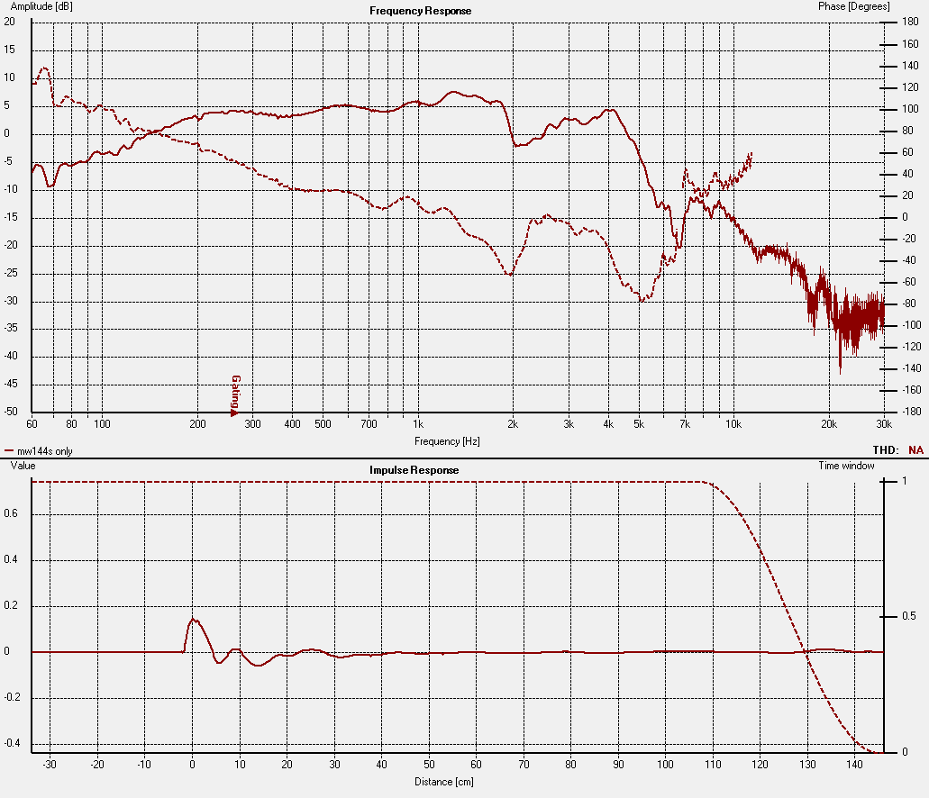

A notch filter at arond 4K on the woofer looks like a good starting point. that should tame it a little, and may allow (with suitable tweeter) a cross at somewhere between 2 and 3 Khz.
Having been through an exercise of trying to deal with a driver that presented a similar response (though not as peaky) and coming out with a good result, it is surprising what you can actually achieve (though I will certainly not claim it is easy!!).
Below I've attached a response plot (in box) of my MW144's which are not dissimilar to the OP's woofers SPL curve in a lot of respects. I've attached these to show what is possible even when things look bad. Second pic is the tweeter that was mated with it (a DMS37), and third pic is the final result. Completely passive crossover. But designed with good measurements and simulation.
So what might at first look terrible can be bent into shape, and at least in my case it does sound good. crossover is at 2.8Khz 4th order bessel.

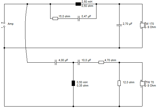

Having had a play with the similar Visaton W170 woofer ( a parcel shelf car woofer....) and a TW-70, I fancy the 4" Goldwood GT-25 cone tweeter.
It all works rather well. The Woofer gets a typical 6" woofer's 5kHz notch. Lots of bafflestep for bass and a gentle rolloff. Crossover's a tidge lower than I would like ideally, but I don't think it'll sound too bad in a cubic foot or so. You adjust the attenuator on the treble so it stays around 9 ohms overall on a 6 ohm DC tweeter to get the treble level about right, but it won't be far off anyway. This tweeter is so cheap, what have you got to lose?
BTW, I assume it's a sealed unit, otherwise you build a tiny little box for it.

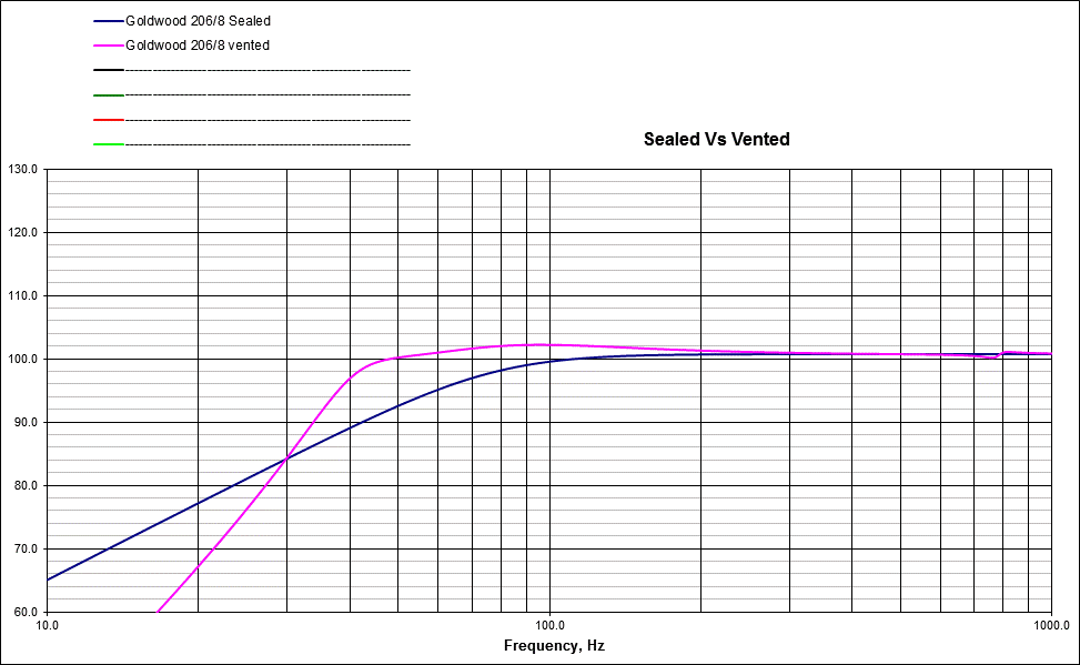

As was suggested earlier the woofer (if you want bass) would probably best be put in a vented enclosure. I modeled it sealed and vented in 22L (your 0.79 cubic feet) If tuned to around 48-50 Hz you might get something ok. But it will not handle much power (sealed won't either under 100Hz)
You may need to put in a high pass at 50Hz. It could probably handle about 20W if you did.
Anyway attached is graph comparing vented to sealed. bothwere using your cabinet size, vented tuned to 48Hz., sealed heavy stuffing.

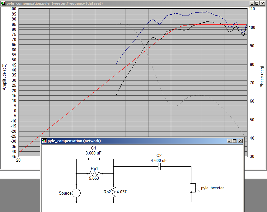

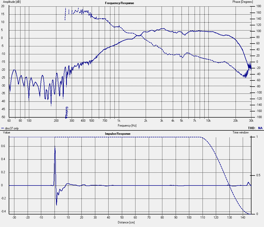

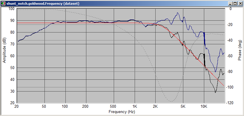

ok as I said pretty academic (I used my dms37's impedance curve) but the attached is what I came up with very quickly. Note phase has not been extracted from the spl trace.
The red target is 3rd order butterworth at 2.5Khz idea being that if the woofer were tamed a bit with a notch and given a similar accoustic target the nature of the butterworth would fill in the hole in the response a bit. I've not don anything with the woofer.
I dropped the tweeter down to 85db which allows for 3db of baffle step correction on the woofer. Not all is as bad as it first seems
Blue is the original tweeter response curve.
Tony.
Tony.

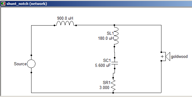

I spltraced the goldwood tonight. I just put it into speakerworkshop as is, no phase extraction, no baffle step modeling, no box model just to see what could be done about the breakup peak.
I decided to try a series notch (as it is something new for me). Results are promising.

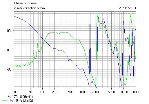

With baffle dimentions (to do a proper baffle step sim) and phase extracted properly, I think a quite workable crossover can probably be come up with. Something that should be far better than an off the shelf one anyway
Note this is for demo purposes only, not suggesting you should implement this as is
Tony.
Tony.

Thanks Rick when I saw the response of the woofer, I thought hmmm that looks familiar!! I also thought that it most definitely did not look newbie friendly, and the thought of it with an off the shelf crossover was not pleasant.
The response curve from 100Hz through 1Khz actually looks very good. I suspect that this driver would probably make a decent midrange in a three way.
When I bought my MW144's I was expecting an easy job with the crossover, as the manufacturers curves at the time were very smooth. The reality was quite different, so my introduction to designing your own crossover was rather harder than I would have liked. But I am a tenacious bastard and I worked at it until I got something I was happy with.
Now when I see a driver with some issues, I see it as just a bit more of a challenge The series (shunt) LCR actually worked very well in this case. Much better than I was expecting. It doesn't take out the peaks but does a brilliant job of fitting the response to the third order 2.5Khz target that I had arbitrarily chosen.

The reason your not getting any useful bass output is that this woofer you now have is not suited to a sealed enclosure....it works far far better in a Ported enclosure. The simulation you used is crude to say the least. There are more complex simulations that consider far more variables & are therefore more accurate.
I ran your driver thru my simulator WinISD beta.....a common FREE simulation & found your bass driver will work just fine in a 3.018 cubic foot enclosure. With a common dimension ratio this works out to 13.763" by 17.341" by 21.848".
With a port size of 102mm diameter by 165mm long you can expect the bass to fade off at 30 Hz, or -3Db@30Hz as it is commonly written. A much smaller port should be used, perhaps half that diameter. Note that these are INSIDE dimensions. Changing the port size is easily plugged into this simulation.
Do yourself a big favor & build your box out of at least 3/4" material......I like to build with 1" material......I am assuming you used MDF or what's called Medium Density Fiberboard...you can reuse your stuffing in the other box, lining the insides.

First up, you're giving a couple of 6" midbasses a 85L cabinet. Doesn't that strike you as at least a little bit excessive?
I'd go for 20L tuned to 60Hz. Gives a similar bass response to my boombox (which also has BSC), ~2.5dB peaking around 100Hz, -3dB around 60Hz. The alignment was recommended by Saturnus, and sounds rather good in practice.

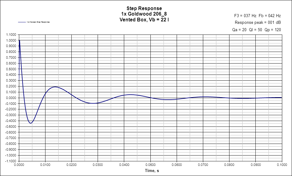

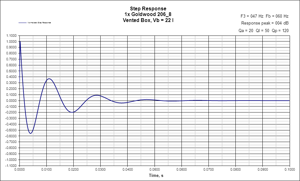

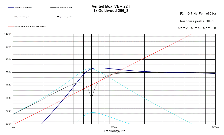

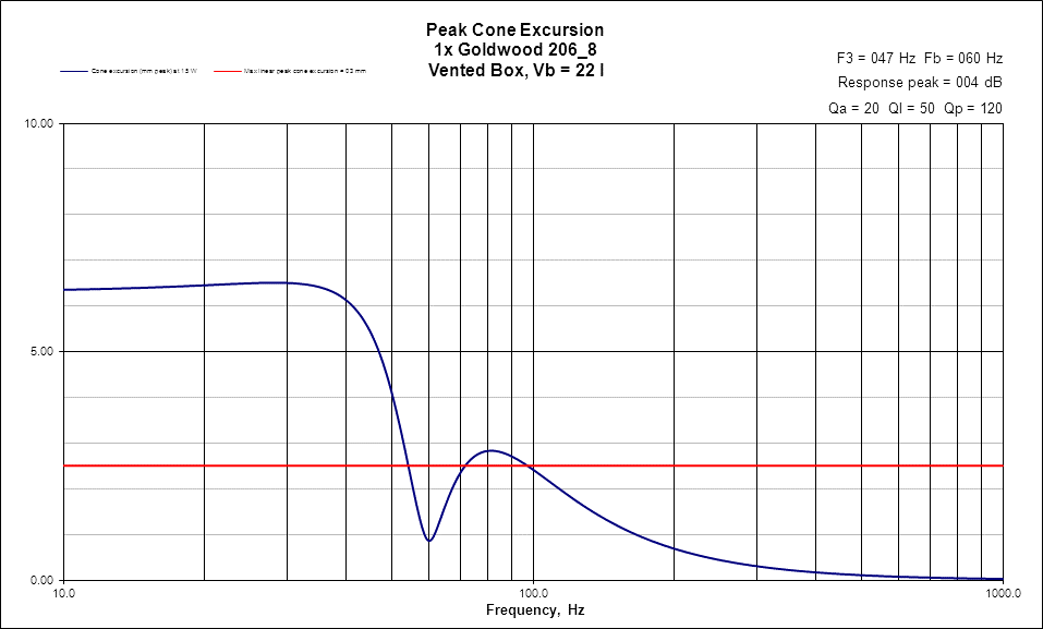

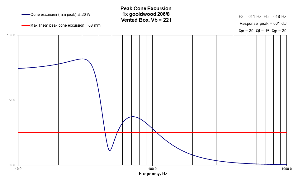

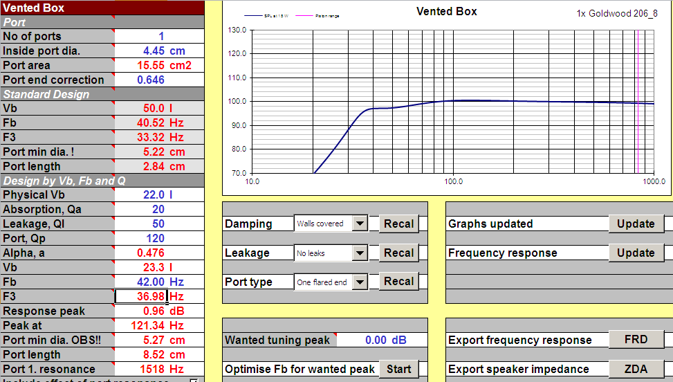

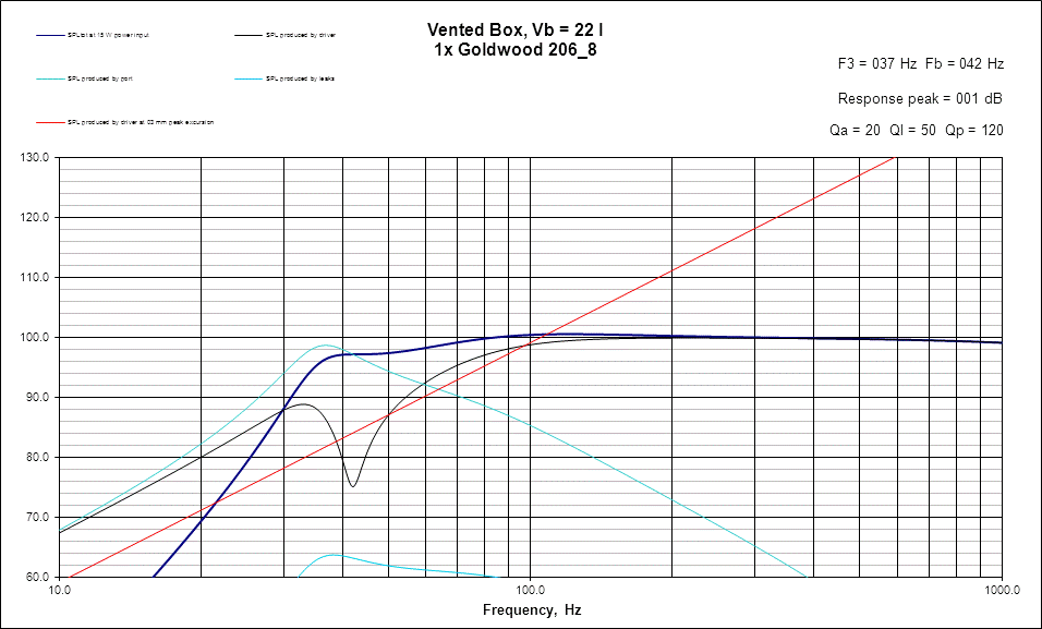

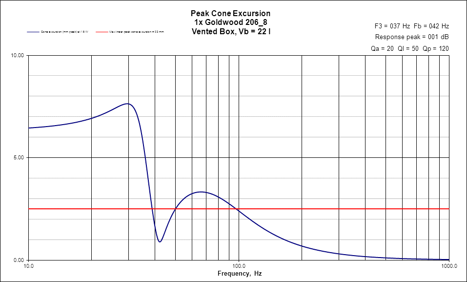

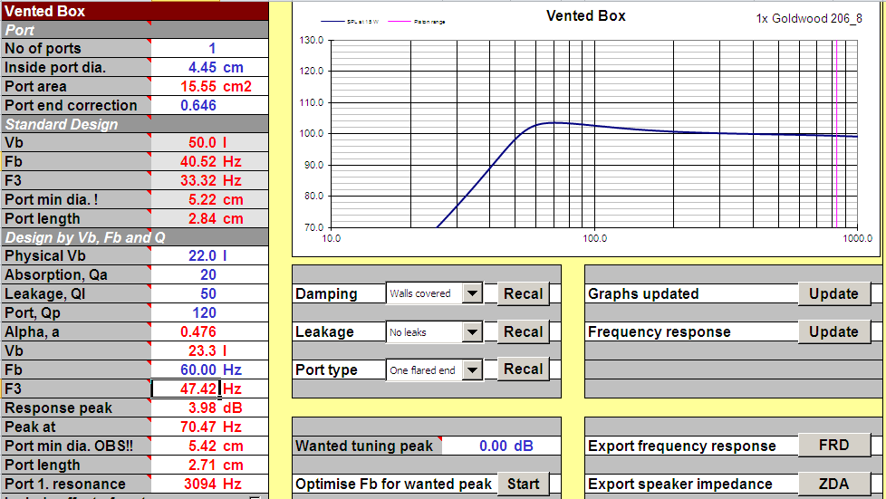

@ Chris, that looks pretty good actually! I was just playing around with unibox so already had it there. I have 22L as that is the OP's actual cabinet volume.
I was about to post 22L tuned to 42Hz as a possibility but I think that the 60 Hz tuning looks better (and the transient response certainly is). It would be interesting to see how that comes out adjusted for baffle step with the baffle dimentions.
plots for 60Hz tuning 22L cabinet below. Power handling (at the OP's 15W) looks to be good as well.
edit: I've just attached the 42Hz tuning plots for comparison.
