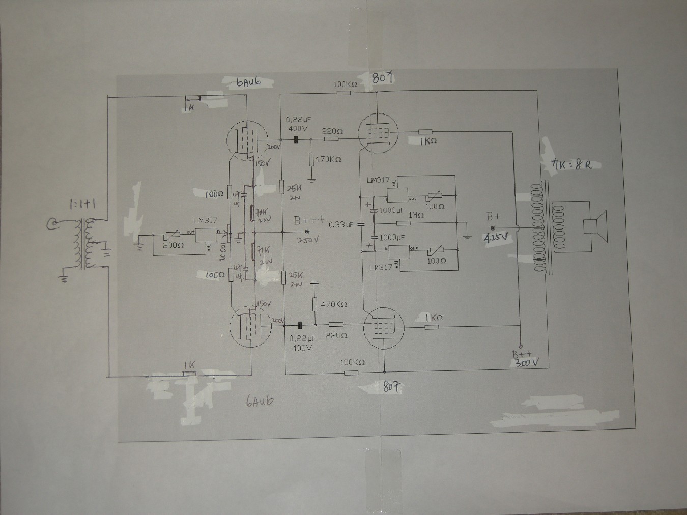

According to the formulas above - and assuming the 0.93V reading represents the 8-ohm secondary tap - the plate-to-plate primary impedance = (28/0.93)^2 * 8 = ±7.25 kohms.
Sounds like a nice start for a couple of 6V6's or EL84's...

I don't have the recommended tubes, but lots of 807. The size of the opts are kind of big. 3"x4"x3.5"H. What do you think ??
Albert
Albert
807's will work:
http://frank.pocnet.net/sheets/084/8/807.pdf
Scroll down a few pages and look at the examples for AB1 PENTODE operation. With a 7.2K PP impedance, use 425-450 volts for the plate voltage and 300v for G2. That should be about right.

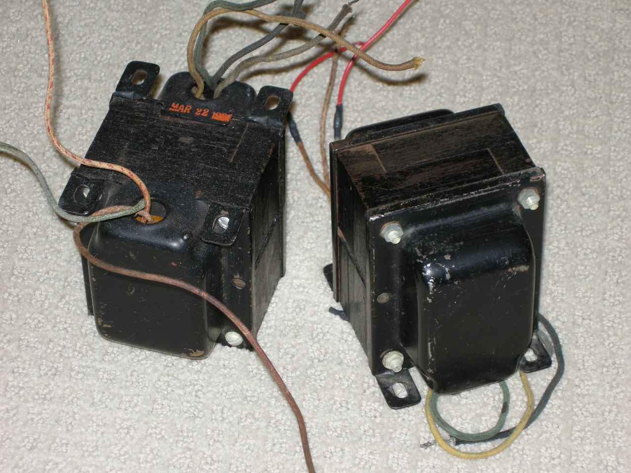

Can you post a picture of the transformers? See if your camera can take pictures at 640 X 480 resolution. Most likely the pictures you are taking are too big for this forum to accept.

Or use photo editor software to resize your pictures. Open source (free) GIMP works very well for this.
The recommended operating point makes sense to me, should end up with a pretty nice amp if the transformers are decent.
The fact that the laminations are assembled in blocks indicates they took some shortcuts in assembly.
I am going to go out on a limb and say that Bogen made those transformers. What tipped me off is their build "style" and the red/orange date stamp. I have several Bogen power and output transformers that have this exact same date stamping on them. They are quality made transformers; mostly made for PA service, but some of them work quite well in a HiFi amp.
As for the laminations... I have some Sansui outputs where the laminations are put together in this "block" style and they are EXCELLENT output transformers. They have multi-interleaved coils and have very wide bandwidth.
