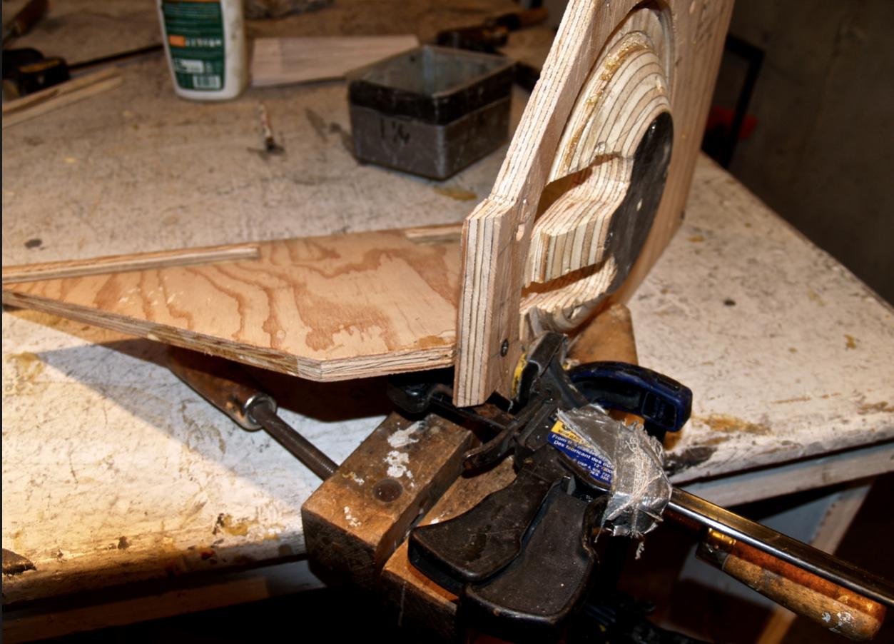

Unless I'm wrong, I can build at least a basic rectangular "horn" with butt joints and regular 90 degree cuts. Only two pieces need to be trapezoid shaped. Yes, the mouth and throat will not be flush but that is easier to smooth out. The important parts to join are the petals of the horn and I believe basic glue and screw will work?
[Sound effect of a head being pulled out of a dark, smelly place ]
The butt joints on the trapezoid shaped parts will not be 90 degree, they are closer to 45 degree for a 90 degree horn.Unless I'm wrong, I can build at least a basic rectangular "horn" with butt joints and regular 90 degree cuts. Only two pieces need to be trapezoid shaped.
Bwaslo's Synergy calculator (linked at the bottom of his post in #10) will give you all the cut angles of a two part Synergy style horn of any desired size and dispersion.
I'm probably misusing the term "butt joint." I mean that the trapezoid piece will be cut at an angle (to the horizontal) but the cut is vertical (correct term?) and thus can be done with a humble jigsaw or other entry level power tool
I'm not planning a two-expansion Unity style horn at first; I agree that the calculator is the way to go if I have a real horn built, but that requires a real shop with real skills
A butt joint is a flush connection of two parts. A dado joint has a cut out so one part fits in a slot or "L" shaped cut out.I'm probably misusing the term "butt joint." I mean that the trapezoid piece will be cut at an angle (to the horizontal) but the cut is vertical (correct term?) and thus can be done with a humble jigsaw or other entry level power tool
You can build square or rectangular boxes using all 90 degree cuts, but not a horn.
If your jigsaw blade angle can be adjusted, the angle required for a flush butt joint in a conical horn can be accomplished with it. If it is a fixed 90 degree angle saw, you would need to use expanding glue to fill the void.
In the picture below you can see side baffle angles are 90 degree (other than the end that attaches to the HF driver baffle plate). The angle for the trap shaped lower horn part is slight, but definitely not 90 degree. If cut to 90 degree, the left part of the horn would "lean in" at the top when assembled. If you could hold it at the proper angle while gluing and screwing (very difficult to accomplish when the cut angle is not correct) there would be a gap on inside of the horn, the parts won't "butt" together.
It doesn't really require much of a shop. I only have a $50 used craigslist table saw on a stand I drag out onto the pavement when I need to do some cutting. A tablesaw and a pair home-made sled boards can do amazing things even with my very ham-handed carpentry skills.
On smoothing the countours, keep in mind the wavelengths being effected and what parts of the waveguide control which frequency/wavelength bands. The higher frequency control is pretty much set in the first five or so inches of horn length (above 13kHz or so is almost entirely set inside the tweeter driver!) , so shapes further out only have much effect on longer wavelengths. The point being that shape irregularites that are small compared to a wavelength don't really do much out there. An edge that sticks out say just an eighth of an inch 6 inches down the horn is going to be pretty much benign and not worth worrying about other than maybe for cosmetics.

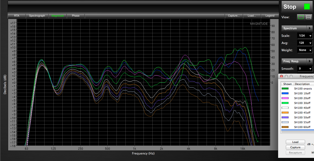

The SM100 and SH100 use a short horn extending the 8". Using a co-ax reduces the parts count and ease of construction, but still has the HF behind the LF, which with the Synergy passive crossover design still results in smooth phase response. The wide dispersion horn results in a shallow cabinet that fits it's typical application, down firing above a preacher for the SH100, or as a floor monitor (SM100).I had previously asked basically, of the DSL speakers that have a coaxial (cone) driver, why there is one that uses a variation of the Unity, Synergy patent (mids go through a port hole), this is the SM60M; but then there are others (e.g. the SM100) that appear to be a regular 8" coaxial with no special Unity magic.
Left unanswered is my question as to how the two variants of coax implementation fare in polar and other measurements.
Polar response of the SH100 narrows more in the HF than the more usual Synergy speakers due to the horn geometry, and frequency response is not as smooth.
Polar response for many of the DSL products are available on their website in the EASE format IIRC, which requires a Windows machine for viewing.
