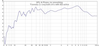

I did an actual measurement! DB level is not calibrated but the FR looks not so bad. I seem to get down to around 140 Hz near Listening Position.
THD (not shown) is around 7% in left, and well < 1 % in Right. Perhaps due to dodgy mids drivers ?
These are probably my "final" Travesty 2.x; I have exhausted my supply of "CTS-clone" for mids and I've added batts of insulation and rear panels to each speaker. I need to hook up my better (not the coroplast experiment) sub so I will hear some bass again.

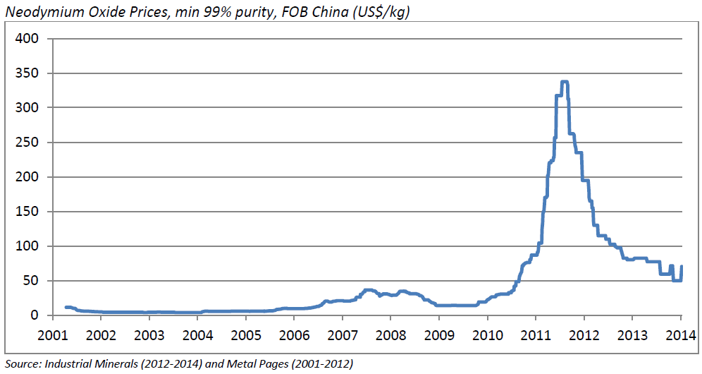

Another advantage of being a few years late. I had to look up the "neodymium crisis" [ca. 2011]. I am aware that Neo is used for magents in primo drivers. Based on this chart, Neodymium (and many other commodities, e.g. Gold) had a speculative boom and bust, just like happens in many markets every few to ten years... while I've not researched it, nor do I care to, Neodymium is probably at more reasonable prices lately, it follows that (say) BMS drivers are a better deal now too. Are BMS compression drivers a long-term investment, then? Maybe, but I'd recommend you stick to Kruggerands or American Eagles, Maple Leafs, etc.

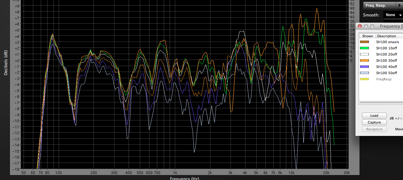

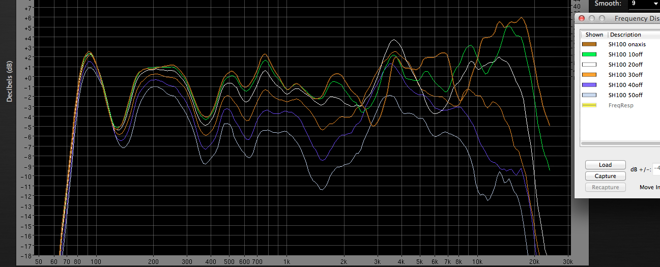

Also a matter of the smoothing applied to the frequency response curves.70 Hz- 20 kHz +/- 3dB is not "hi-fi"? Matter of opinion I guess...
No smoothing, the SH-100 is around +/- 8 dB, with as much smoothing as Smaart allows, +/- 5 dB, as the outdoor measurements below show.
The frequency response could be equalized nicely up to around 2kHz, but the coaxial 8"/1" polar response above that point is irregular, so equalization can only correct response at one listening angle.
This compromised polar response is typical of coaxial speakers that use the woofer cone as an extension of the HF horn. The same HF driver on a proper horn can have excellent HF polar response, and much smoother frequency response.

That would be true for co-ax designs using the speaker cone as an extension of the HF horn. Many co-ax designs use a separate HF horn in front of the cone, eliminating the frequency and IM distortion problems, but introducing diffraction problems.Good points. I've read today, too, that a problem of [all?] coaxials is that the tweeter can be modulated by the woofer, creating some type of distortion.

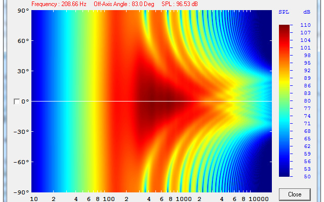

What specifically does this plot mean?
I'm sure this is an example of a horrible polar response, but I am not sure quite how to read the polar. This is a hornresp plot of one of my straight conical horns (all I am trying lately). Perhaps I should learn one of the other simulators, but since so far I am building with coroplast and gorilla glue, it's probably just faster to build a prototype. I should be thankful, no doubt, that I don't have the equipment, or at least, not the knowledge on how to do a polar response plot of a real speaker.

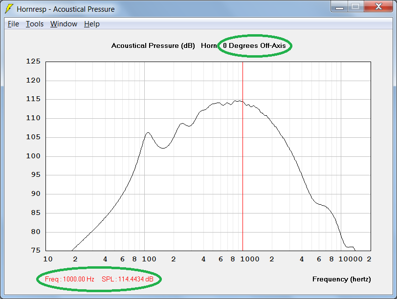

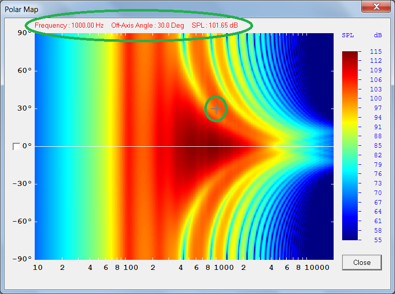

The Hornresp polar map is a three-dimensional chart - the third dimension is colour. It enables different aspects of directivity performance to be consolidated onto the one chart, as illustrated in the following example.

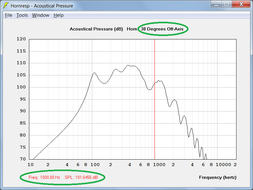

Attachment 1 shows that at a frequency of 1000 Hz, the sound pressure level 30 degrees off-axis is 101.65 dB.
Attachment 2 shows the pressure response 30 degrees off-axis. At 1000 Hz the SPL is 101.6456 dB, the same as that given by the polar map (rounded to two decimal places).
Attachment 3 shows the on-axis pressure response. At 1000 Hz the SPL is 114.4434 dB.

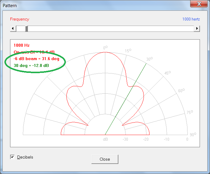

Attachment 4 shows the directivity pattern at 1000 Hz. The -6dB beam width is 31.6 degrees, and 30 degrees off-axis the SPL is 12.8 dB less that the on-axis pressure. The 30 degree off-axis SPL given in Attachment 2 is 101.6456 dB and the on-axis SPL given in Attachment 3 is 114.4434 dB. The difference between the two is 12.8 dB, the same as the value given above.
Attachment 5 shows the -6dB beam width response. At 1000 Hz the beam width is 31.6002 degrees, the same as given on the directivity pattern (rounded to 1 decimal place).

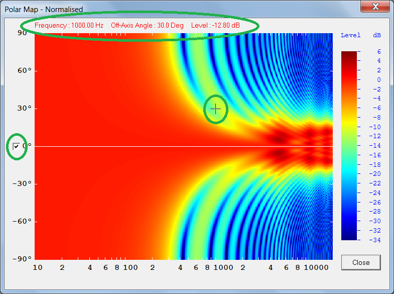

Attachment 6 shows the polar map pressure levels normalised to the on-axis values. At 1000 Hz and 30 degrees-off-axis the response is 12.80 dB down, the same as given in Attachment 4.
Directivity can be expressed a number of different ways. The polar map effectively brings the key indicators together on a single chart.
