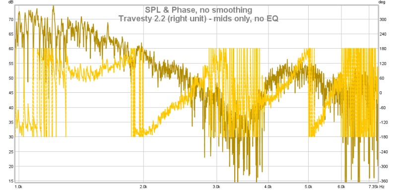

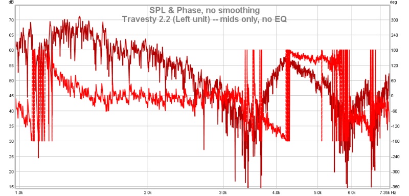

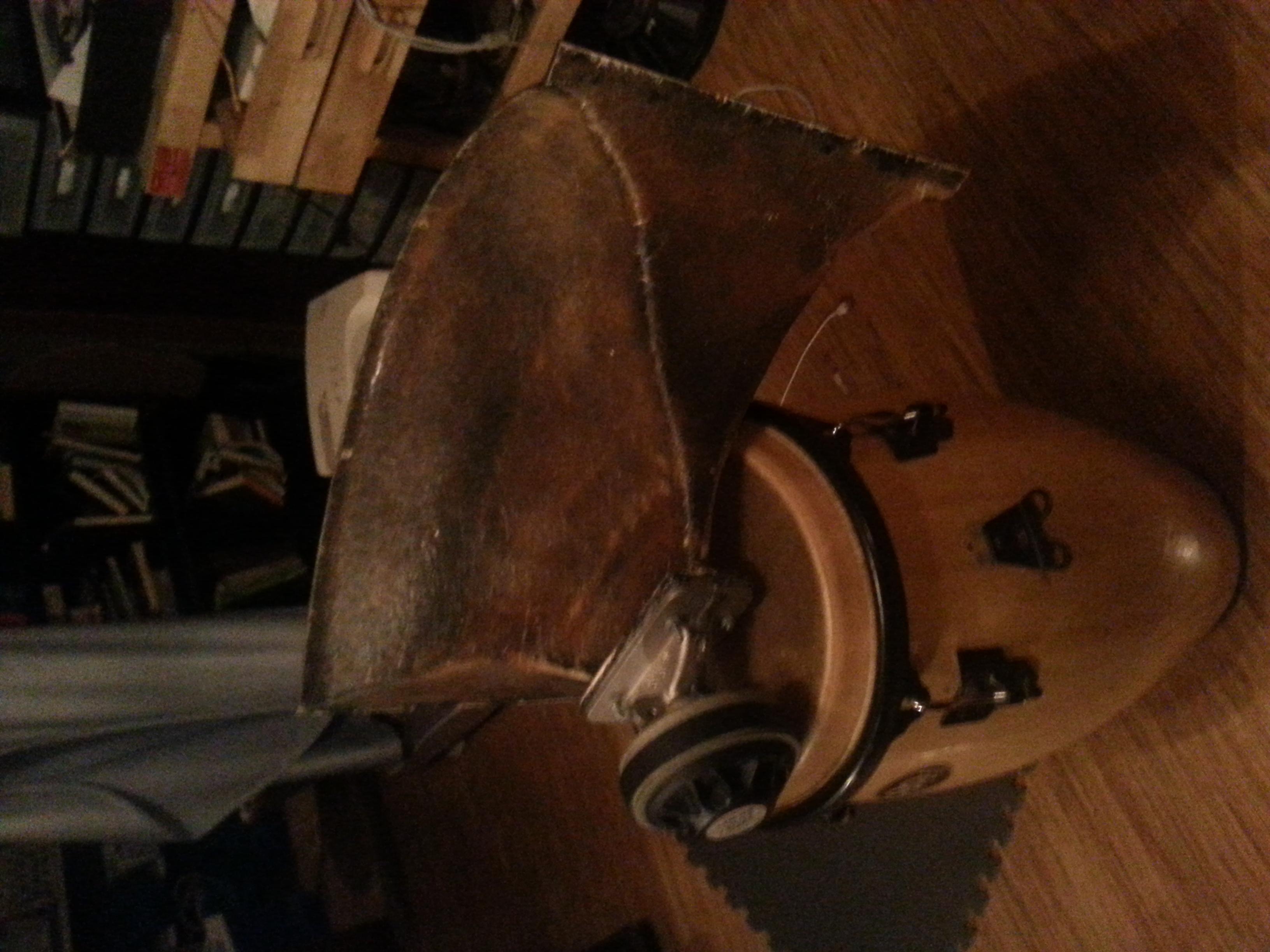

My current Travesty is now more braced and gorilla glued. Fresh towels taped to rear to damp back wave. I ran some REW sweeps around noon today, as best as I can (it's pleasant weather here in FL) with neighbor's circular saw running. Did I also mention I live a few hundred meters from a highway and a regional airport just past that
I "designed" the Travesty to have ~ 1 KHz crossover. The "lows" or "mids" (as you like, it's a two-way) are now a pair of similar-to-CTS 4C1077 (stock drivers in original Bose 901). All drivers are open to the air (except for damping in rear); Each "mid" has its port, loosely calculated at about 8 cm^2. Distance to tweeter is 8 cm +/- 2 cm. best I could measure.
Head-scratcher: I have tried to find the "crossover" between the mid and high in a speaker (level match each section, invert phase and run a sweep, look for a minimum) but I can't figure out where! Also the 1/2 wave notch of the mid in theory should be 2K-ish but seems more around 3.4 K. Where am I erring? Thanks.
Note these sweeps are just of the mids, no EQ, no delay, etc.

1) The towels probably have little effect other than reducing high frequencies. If you build some boxes, or find some cups to tape on as chambers you can get a better handle on the response. Some smoothing applied to your tests will also help see the tree within the forest.1)Fresh towels taped to rear to damp back wave.
2)I "designed" the Travesty to have ~ 1 KHz crossover.
3)Head-scratcher: I have tried to find the "crossover" between the mid and high in a speaker (level match each section, invert phase and run a sweep, look for a minimum) but I can't figure out where!
4)Also the 1/2 wave notch of the mid in theory should be 2K-ish but seems more around 3.4 K. Where am I erring?
2) 1 kHz is within the bandwidth of either driver you chose, good.
3) The depth of a reverse polarity null can be used to determine whether the delay is properly set between drivers for a given crossover frequency, or to tell if polarity should be reversed.
Assuming you are inverting polarity between the offset drivers and the driver at the horn apex, both run "full range", the combined response should largely cancel over a wide range, resulting in lower overall level, with peaks and dips scattered though the response.
4)Perhaps you are measuring along the side of the horn, rather than front to back for your theory, along the side is longer.

Oh, I should be doing time delay? Duh, ok more testing to follow. I honestly don't know the exact distance of my ports but I aimed for 6 cm (I think) ~ 1000 Hz 1/4 wave. Even if "exact" were possible to me, isn't this measured down the imaginary centerline of the horn | waveguide | rickety structure of coroplast and adhesive
