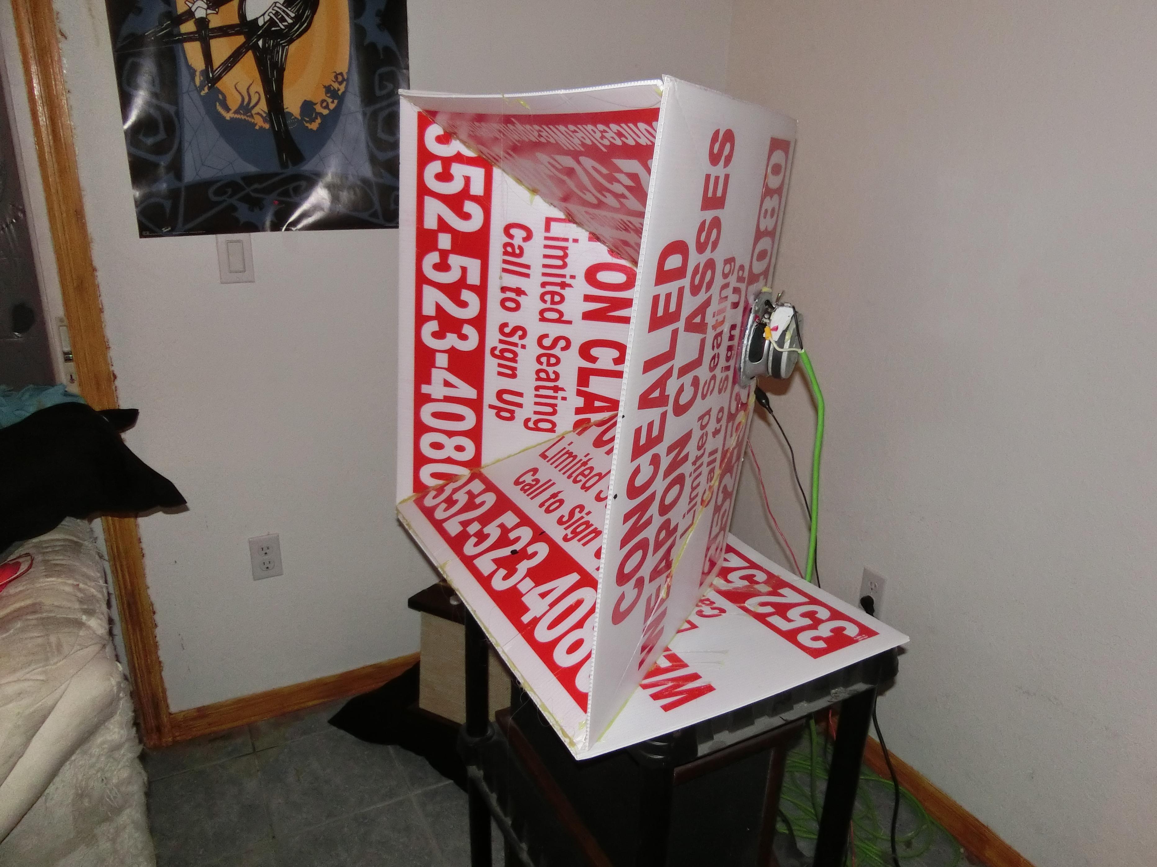

Here is the Travesty 2.1 with its mighty TC9 tweeter and single mid "injection" port, totally eyeballed, using a CTS (Bose) type driver of unknown pedigree, a cull from my Marimba build of 2015. Sounds "OK", haven't done any fine tuning yet. I'll have to put a cover on it, or at least blankets over the drivers before I run sweeps. Right now its sort of a waveguide open baffle dipole two-way :)
Not optimal except for ease of construction, this made from various collected advertising signs. They are either 24x18" or 24x24". In fact, I only have to make two cuts (scores, actually) on two sheets, the rest is fold & stick with hot glue, Gorilla or the adhesive of your choice.
Not sure this build is worth worrying about a throat adaptor :)

What, you would dare to question the details of my shoddy, slap-dash ***-embly techniques?
:D
Correction: the current build, plus the outside "box" in progress, is completely done with panels of size 24x18"; the only 24x24 that would be needed is if I add a rear panel. One is already boxed, so now I can stuff fiberglass, old rags, Spanish Moss, old birds' nests, and whatever else is on hand for damping :)
