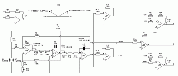

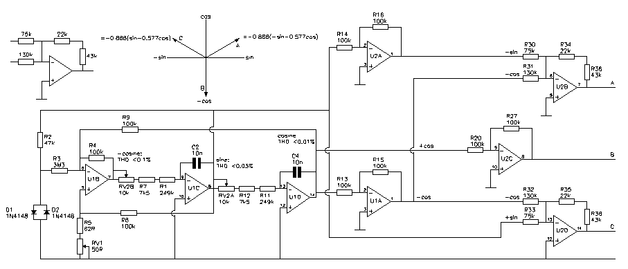

I will take some photographs and post them just as soon as I have something sensible. The composite motor will be driven by TDA2030 audio power amplifier ICs (chosen for their extreme cheapness) and the three phases will be generated from a quadrature oscillator as below:

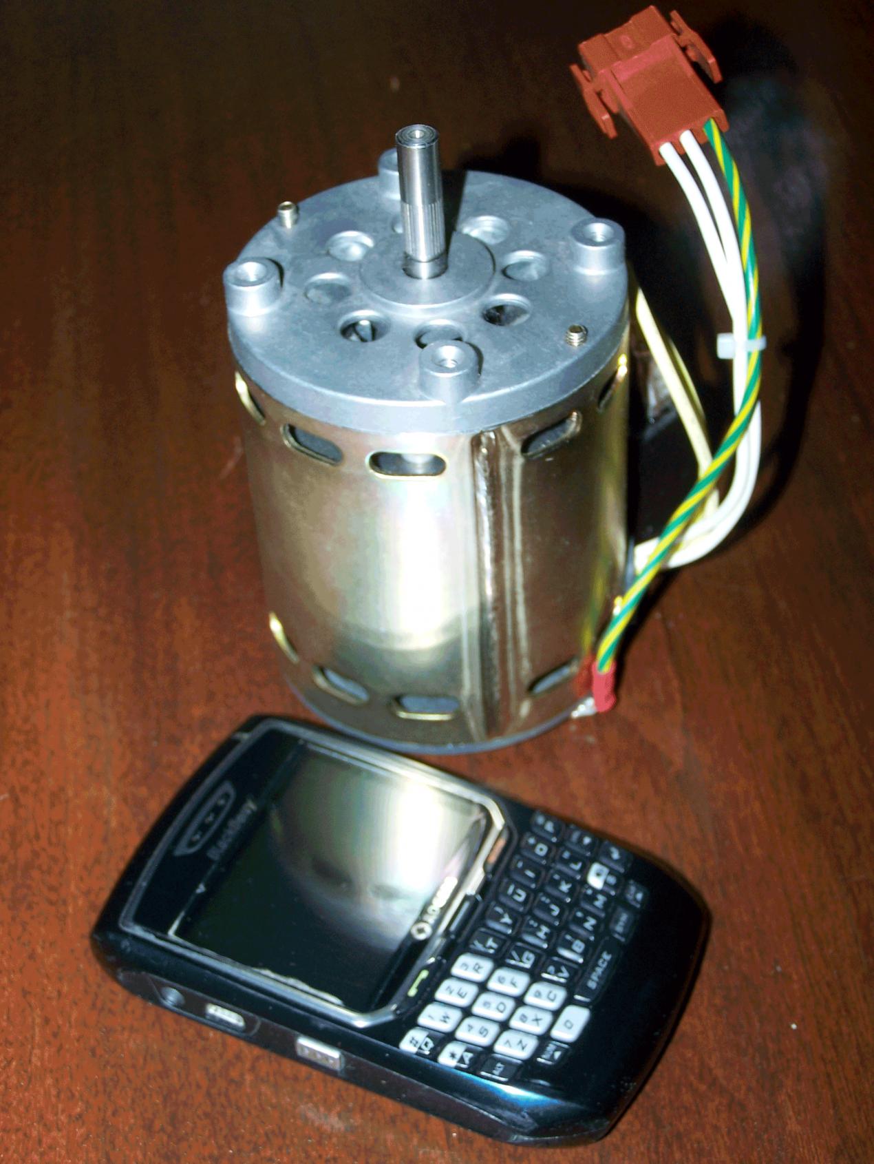

Me thinks an induction motor is the way to go if you yearn for something like a Garrard drive system. Attached is "my choice" for a nice big induction motor. Rated as 23 Watts output, 2850 RPM, 120V, .58A, so about 70 Watts input.
further induction motor information...
a few little calculations later and the result is 77.063 mN-m, or about 4X's the torque of the Hurst motors used in many turntables. Not efficient, but very quiet. Only thing is, how do I make it 300 RPM compatible? I guess a suitable 2 step pulley, Output shaft is 7.95 mm in diameter. so it seems that if the motor drives a 75.5mm diameter pulley or idler wheel, then 300 RPM is attainable. From there all that is required is a correct pulley size to allow a 2nd step to drive the platter. Or perhaps just attempt to drive a platter directly if possible

I'm fascinated by your circuit for a quadrature oscillator generating 3 phases, looking at it I have no idea how it works so will have to study it a little longer. I have a couple of CD motors and have been trying to figure out how to generate the 3 phases with adjustable speed control for a couple of weeks now.
The oscillators I've tried so far don't reliably oscillate at the frequency the matches my pulley, and having to change multiple resistors & capacitors at once is frustrating.

I'm fascinated by your circuit for a quadrature oscillator generating 3 phases, looking at it I have no idea how it works...
There are really three parts to the circuit. Starting from the left, the three op-amps form the quadrature oscillator. It's an oscillator because by the time the signal has passed through the two CR networks it has enough phase shift that when it is fed back it increases the voltage. Sustained oscillation is possible because the two 1N4148 diodes clip the feedback signal and prevent the op-amps going to one rail and staying there (saturation).
The oscillator produces sine and cosine, so if you invert each, you get minus sine and minus cosine - which show on the vector diagram as four phases 90 degrees apart. Once you have those four phases, adding proportions of any adjacent two phases will produce any angle between.
Thus, generating the three phases is easier than you might think. Just look at the single op-amp given as the example in the top left. It adds a proportion of sine to a proportion of cosine (90 degrees) to produce the sum at 30 degrees. Use your calculator to verify the arithmetic. Once you can generate 30 degrees, you just have to decide "30 degrees from what?" and repeat the trick to get the other two of the three phases.
