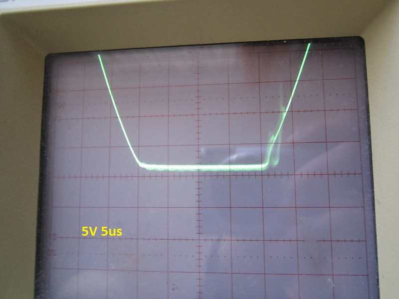

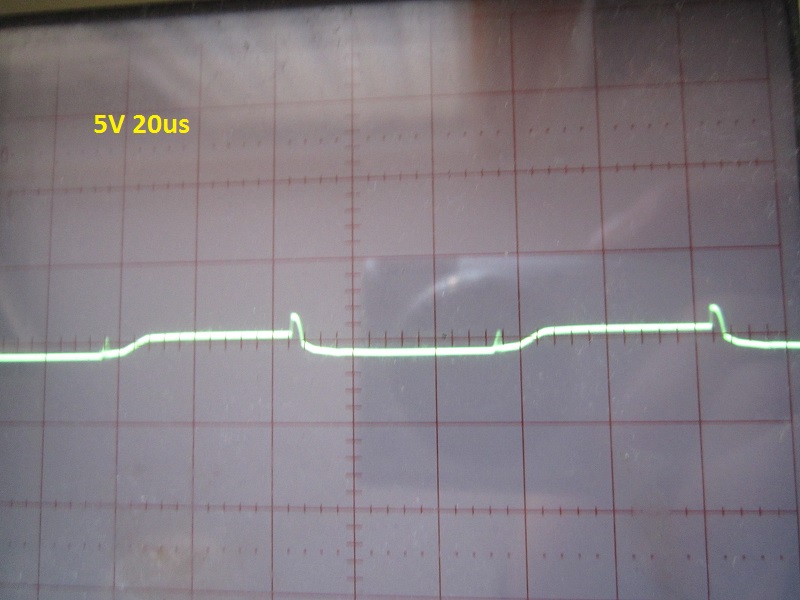

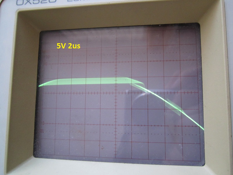

clipping behavior with 6Ohm load
(Hi all, I was on holiday but now I'm back.) I have made a 6-Ohm 50W load resistor, because so far I mostly measured with no load or 15nF capacitive load. Although 50W is not enough for the full output voltage of this amp, the resistor can take a few seconds of overload when it's not hot, so I managed to take oscilloscope images.
There was no oscillation problem on positive clipping when unloaded or with capacitive loads, but the 6Ohm load brings out that there's oscillation on positive clipping as well, even more severe than on the negative.
The strange thing however that the oscillation with the 6-Ohm load seems to be at much higher frequency, not at 1MHz (which was the case without load or with capacitive loads), but the frequency is now unrecognizeable on my 20MHz oscilloscope. Only an oscillation "fog" can be seen.
The first image is the positive, second image is the negative clipping with 6Ohm load. third image is an A-B measurement with two oscilloscope probes across the emitter resistor of one of the NPN output transistors. (Regard this A-B measurement only quantitatively, the oscilloscope is not calibrated, and anyway too high common mode voltage was present for this measurement to be accurate.) All images were made with 10kHz heavily clipped sine signal, and Miller capacitance (C5) was changed from 47pF to 33pF for this measurement.
In image 3, it's fairly well visible that when the the amp tries to get away from positive clipping, the current through the output transistor is about doubled for a short time period. This makes my overcurrent protection kick in. So I would like to get rid of this problem if possible.
My questions: how would you kill this OPT current increase during the positive rail sticking? I tried to clamp the CCS of the VAS with two diodes, as shown in the fourth image, but it does perfectly NOTHING. I even used two 1N4148 diodes in series to make the clamping effect more pronounced: no use. It seems that it is not the CCS that saturates which is very surprising to me. What else can saturate?
Also, can this very high freq. oscillation occur in the OPS? If so, what could be done?

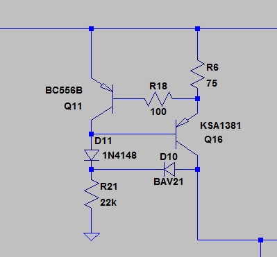

Have you tried increasing the power supply rails to the pre-stages rather than having a voltage drop in the filter sections you originally showed?
Clipping can be caused by voltage or current limiting.
I still have a concern that active current control involves a second transistor that will generate an additional phase shift at some point. As this is a ccs, you could try replacing the BC556 with two 1N4148's just to make it passive and see if that has any improvement.

That type of constant current circuit should have a ~10n cap across Q11 C;E to stabilize the feedback to Q16. It also improves the collector impedance of Q16 by shunting the Miller capacitance of Q16. R18 is maybe not a great idea. Maybe it's an alternative to the cap on Q11 but not as good. ~R18 plus another resistor Q11 C;B can reduce the minimum voltage drop by say 0.3V, which can be important for low voltage (12VDC) amps, where you struggle to get rail-to-rail output, or you just want to squeeze every watt possible out of your amp. An extra Volt swing can add ~10 Watts to your speakers and off the heat sink.

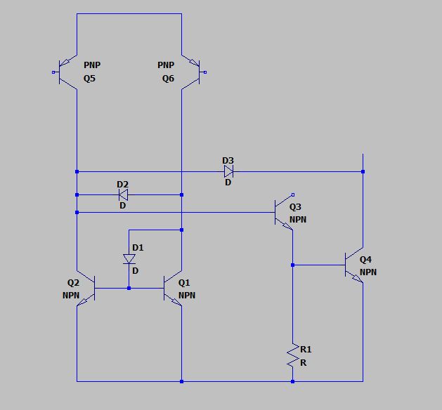

This partial schematic illustrates a way to avoid positive rail sticking. Add a diode D1 to the raise the current mirror base voltage to match the base voltage of Q3. Then put a clamping diode between collectors of the diff amp. So when the diff amp swings too far towards Q6, it shorts out the current mirror and clips before Q4 is completely off.
For this to work, the average voltage on both collectors has to be the same or very close. It also improves the accuracy of the current mirror, which improves the diff-amp and output DC offset.
  • Draft6.asc
