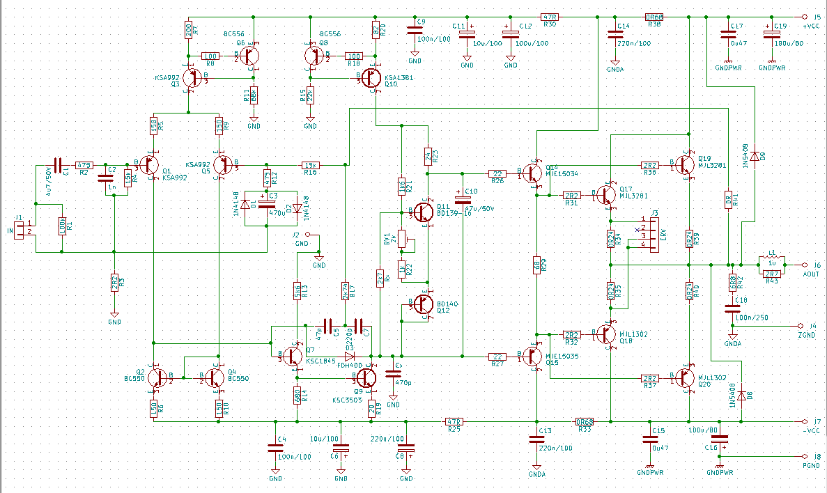

The following changes have been made relative to my original schematic so far:
D4 shorted
D5 shorted
R21 changed to 1k6
Rx (2k7) installed between B of Q11 and B-C of Q12
Cx (470p) installed between collector of Q9 and GND
R19 changed to 20R
R43 changed to 10R
Also decided to remove the two capacitance multipliers because they behave very nastily as soon as the difference between the ripple on the HT rail and the average voltage on the HT rail comes near or exceeds the built in voltage drop of the cap-muls. So I had to choose whether to omit them or make them drop a much bigger voltage. I decide to remove them and use only simple RC filters. The associated changes:
Q13 removed
D6 removed
R24 removed
R25 changed to 47R
C8 top end connected to where Q13 Emitter was
Q16 removed
D7 removed
R28 removed
R30 changed to 47R
C12 top end connected to where Q16 Emitter was
So here is how the schematic stands currently (see attached image).

As suggested by R Dijk in post 29 to resolve this situation the current mirror emitter resistors need to be reduced in value.
Reduced them to 47R, but not the slightest change is visible in the clipping behaviour.
I chose the value of 150R, which is higher than 68R in the original Blameless amp, because my amp was meant to be a 200W one, so it has higher closed loop gain than the 50W Blameless, and noise considerations come into play.

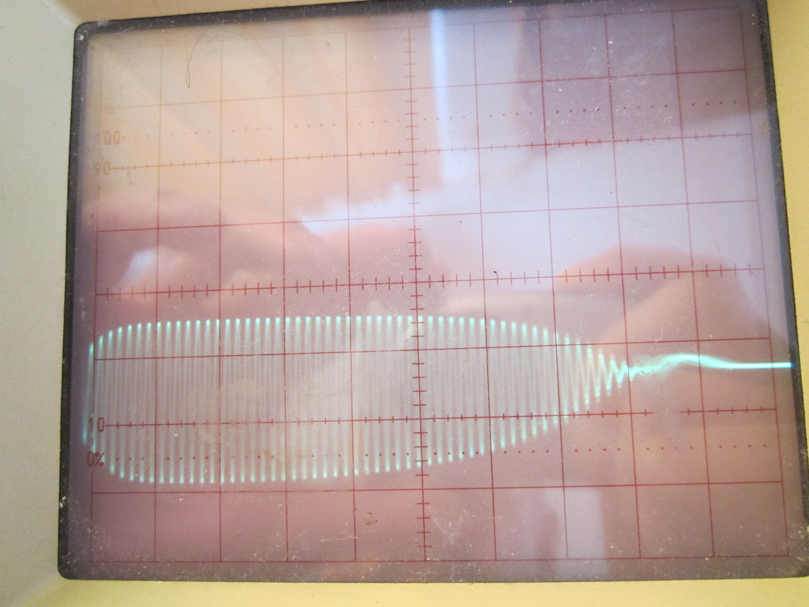

I use an old Onkyo chassis to house this prototype amp. So it came handy to use of one of its speaker terminals with its little PCB that had a 10nF cap across the speaker hot and ground. I totally forgot about this little cap thinking that 10nF is too small to cause any problem. Simulation showed that the most "dangerous" capacitive load to bring the amp into oscillation is about 100nF.
When I removed this 10nF cap, the oscialltion amplitude was further reduced from about 3V p-p to about 1V p-p now.
However the sound of the amp didn't change. It was just as "edgy" as it had been before. Then I removed the TMC resistor R17 to make the amp into "normal" Miller compensation. I did this a few times during testing, and saw nothing different on the oscilloscope with or without TMC. Miller comp. shows the same oscillation on clippping. But have never listened to the amp with normal Miller comp. Well, now I did: the sound is very different: much more natural, with much less "edginess".

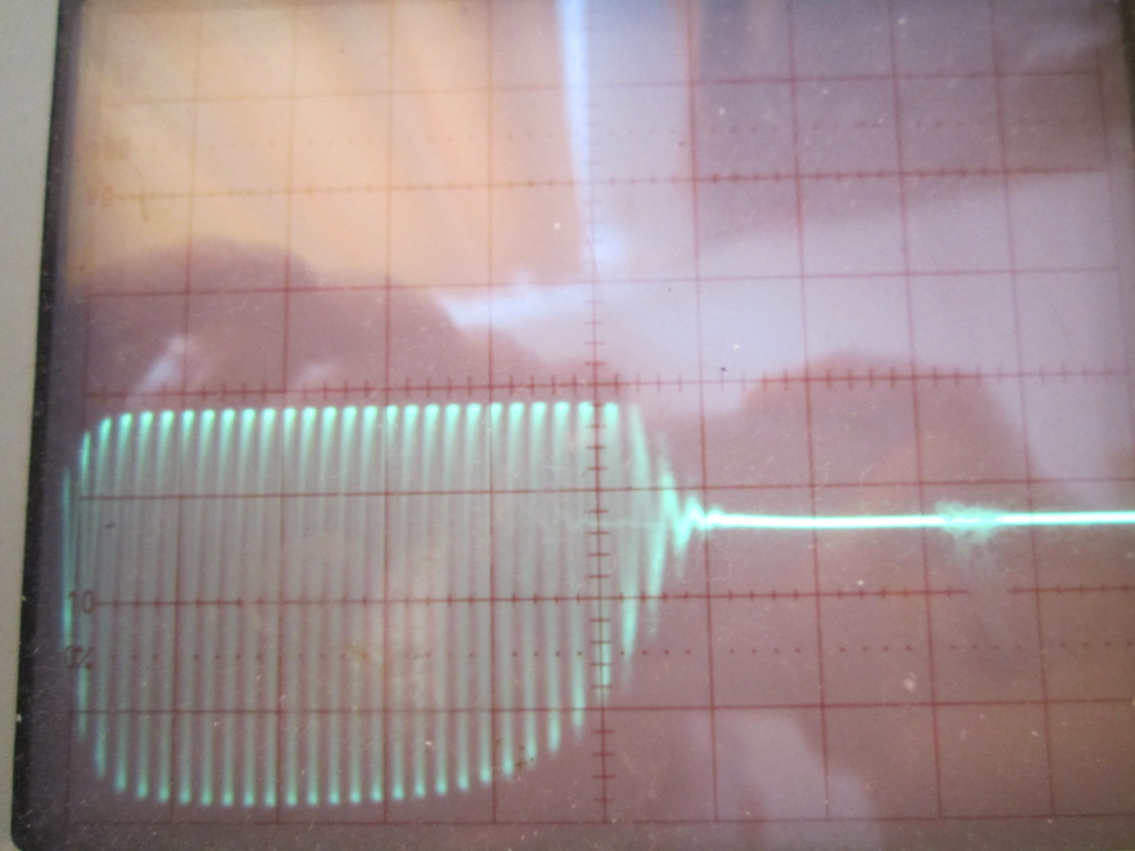

If this is a 200 W amplifier into 4R the supply rails would have to be around the 60 volt mark. The changes you made to the CCS suggest an operating current around 7 m.a.
Run a test using the same settings that induced the 1 V p-p anomaly you reported but this time monitor the voltage at the collector of Q7 with respect to earth and advise the result.

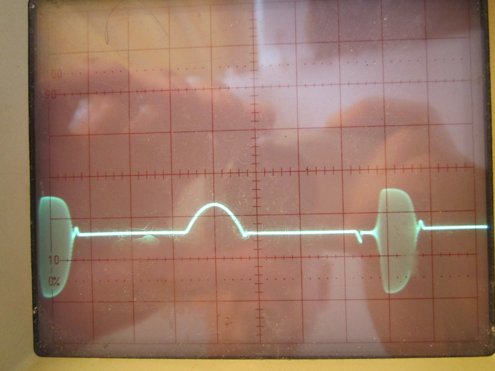

Sorry, the first image in my previous post was 5V 50us...
Here are two other images, this time I removed the LTP current mirror and instead placed a 820 Ohm collector load onto the input transistor. Same measurement (Q7 collector): First image 5V 50us, second image 5V 5us.

I would suggest that, if you have not already done so, omit (short) the "base stopper" resistors in the OP transistors (2.2 ohms) and drivers (22 ohms).
Tried, no change.
Then, reduce the base-base resistor between the output stages (68 ohms =>33 ohms) and add a 1 ... 10 uF capacitor as mentioned before.
Tried 1 uF and no change. In fact LTSpice shows that significant cross conduction through the OPTs occurs only above at 30kHz. Is there any other reason for this cap? I can't decrease the 68 Ohms, the drivers are on a separate small heatsink, and it can't take more heat.

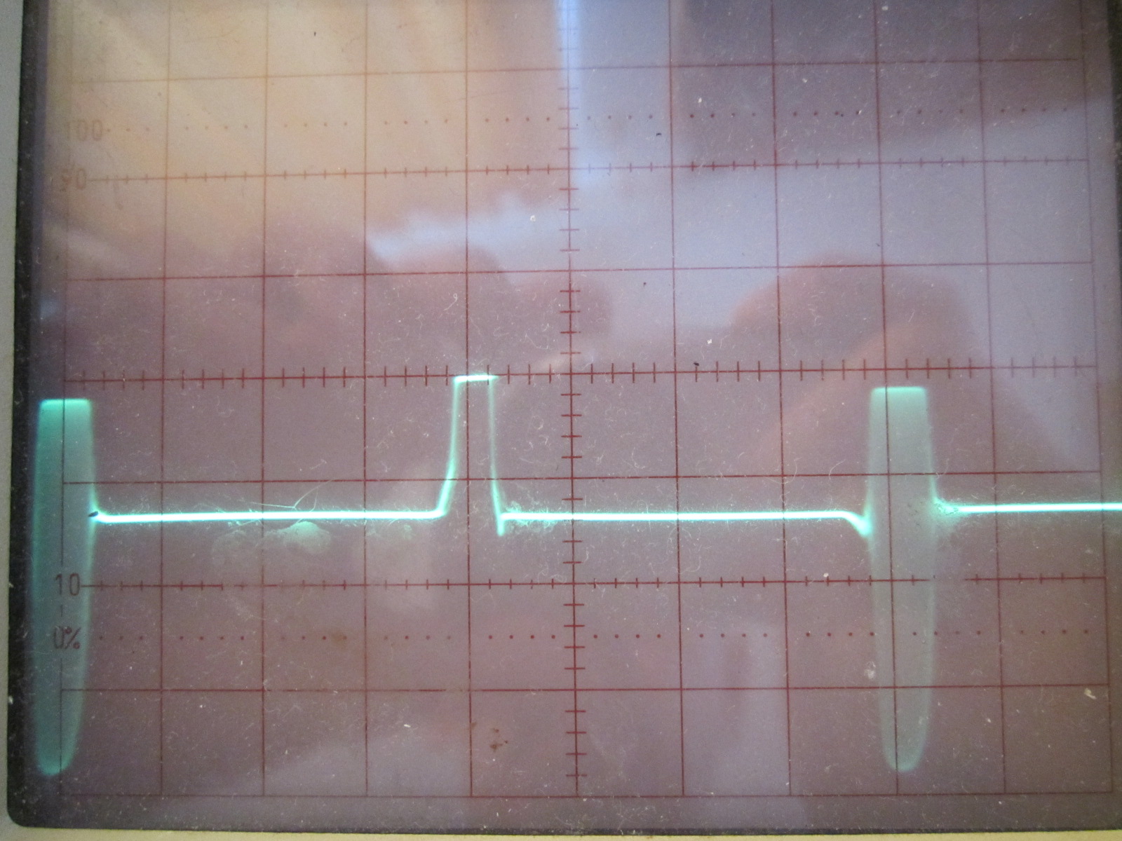

Don't try changes to other areas.
From the voltage drop across R13 (5.6K) there is 8.9 ma flowing from the collector of Q7 through this component.
The amount of collector current in a transistor depends on the gain but for arguments sake lets say 99% of the emitter current ( for a transistor with the % equates to the current gain divided by the current gain plus one).
Accordingly you have about 9 m.a. of emitter current available from Q7 to drive Q9 base which is causing Q9 to saturate. To remedy this the values of R14 and R13 have to be increased in value.
If you want see that you are on the right track in the first instance increase the value of R14 to 2.2k and re-run the tests.

And your last point, I now suspect it could be the negative rail (de)coupling/impedance causing the problem. TO add to my previous reply, if you short out the filter transistor connect all the decoupling caps to GNDPWR and see if that works.
Haven't investigated with LtSpice but it's probably worth to note what the current mirror is doing during clipping.
Negative clipping: the bias to the mirror is lost because the back side LTP transistor cuts off, causing both mirror transistors to cut off. All the 3 mA tail current is dumped through the front side LTP transistor, clamping diode, and the VAS transistor.
Positive clipping: front side LTP transistor cuts off but back side LTP transistor remains conducting. The bias to the mirror is never lost. Both mirror transistors remain conducting, although the bias side transistor gets all the tail current less base current to the "business" side transistor, while the latter stays in saturation due to collector current starvation.

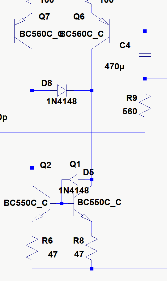

I have seen similar amp circuits having a diode across the current mirror transistor collectors that I suspect was for the purpose of keeping the mirror from cutting off during negative clipping. D8 in the attached pic would keep the mirror conducting and sharing the tail current during negative clipping.
I'd wonder if that diode could make a difference to the oscillation mechanism or hopefully a cure.
I might add that care should be taken of the bias circuit of the current mirror to ensure the cross diode never conducts during normal operating conditions.
Just a thought.
