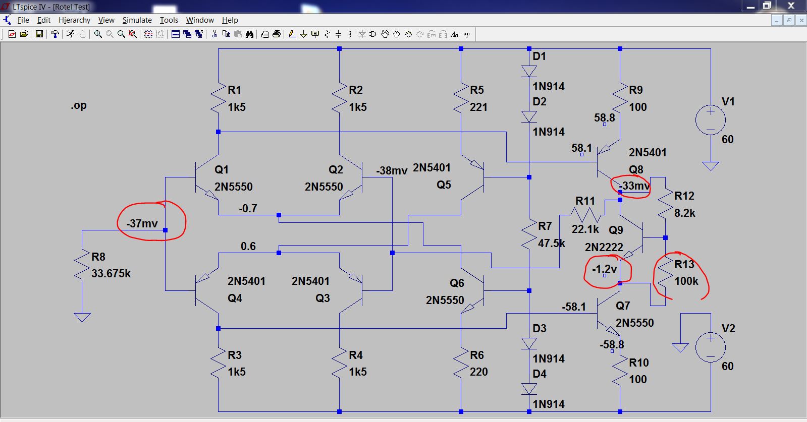

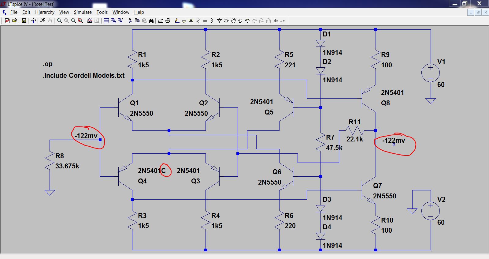

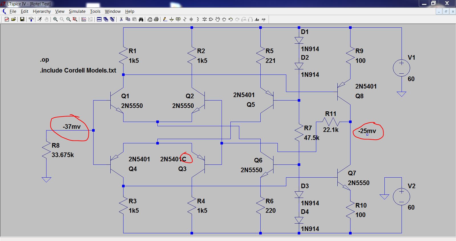

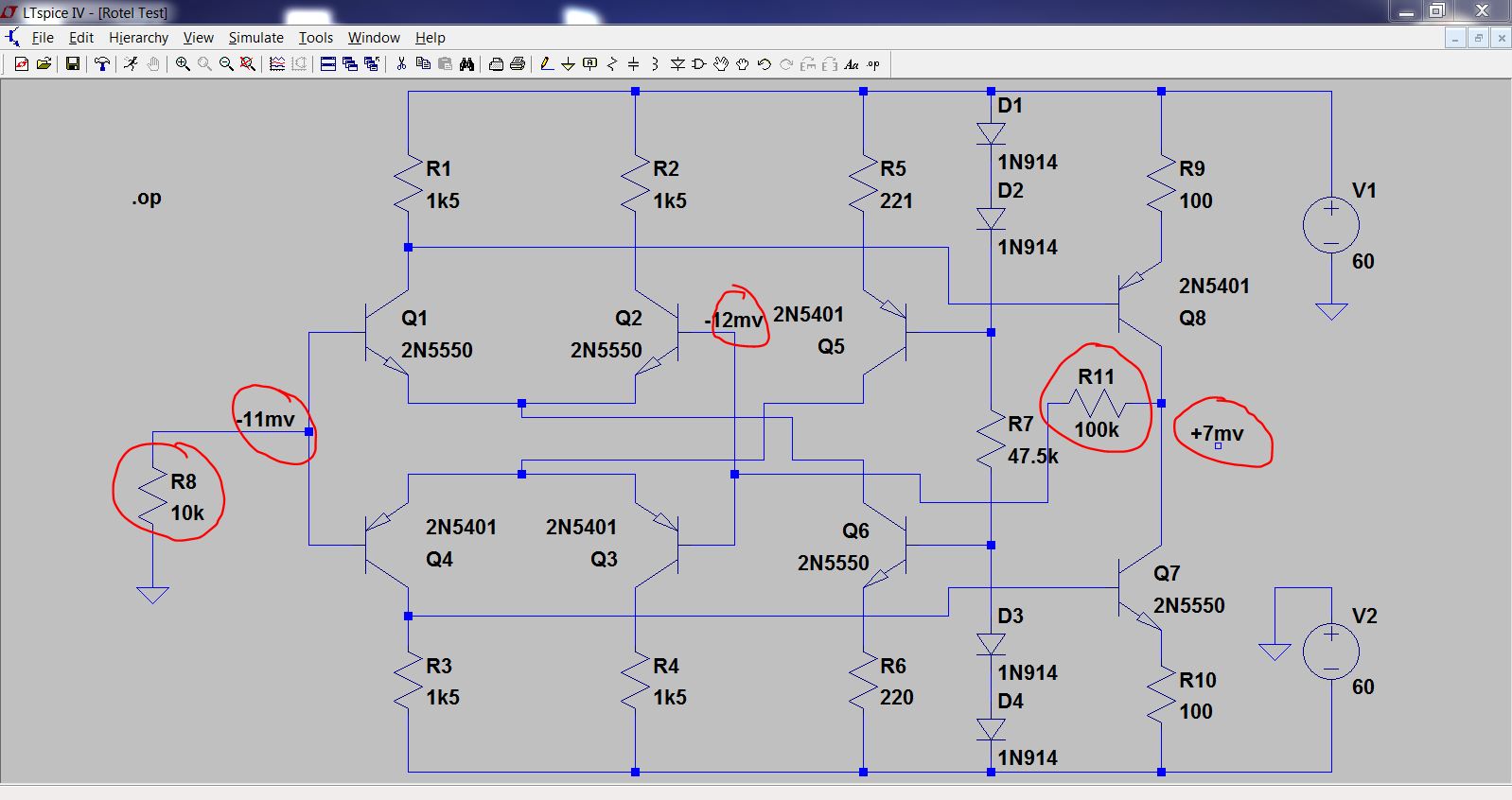

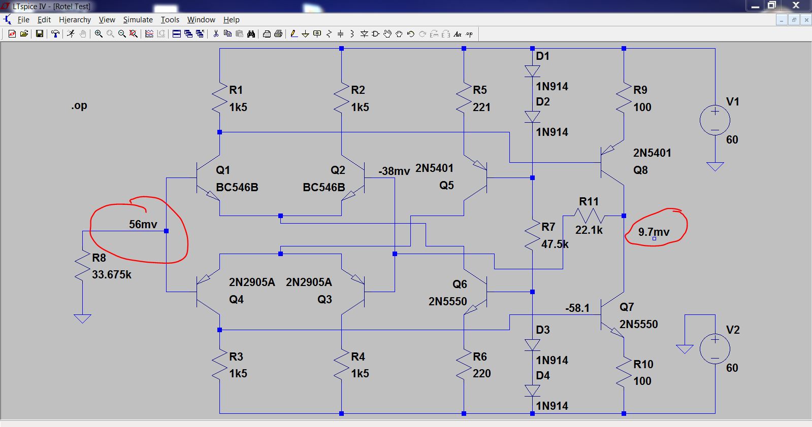

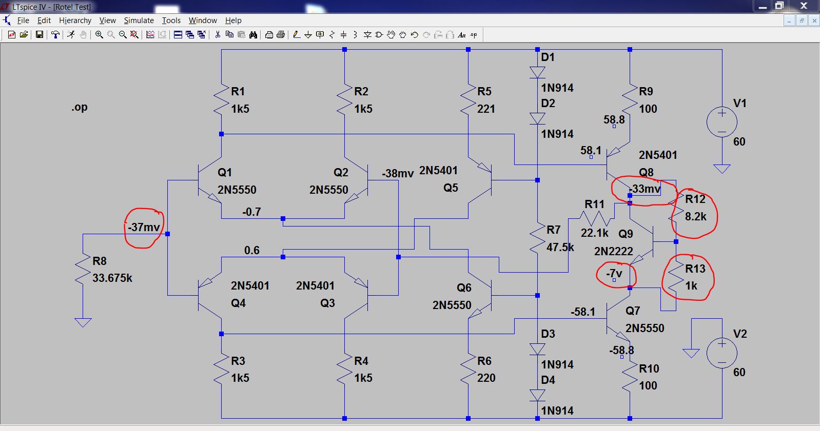

Well simulating with different devices just gives a low offset as expected. Change any input device and the offset alters.
Here the C version is the same transistor but a different model (done by Bob Cordell).
I think the best you can aim for is to match the PNP and NPN pairs as best as possible and then try swapping each pair over one at a time.
If you felt confident you could swap the devices from the other channel to this one and see if the offset is lower.
