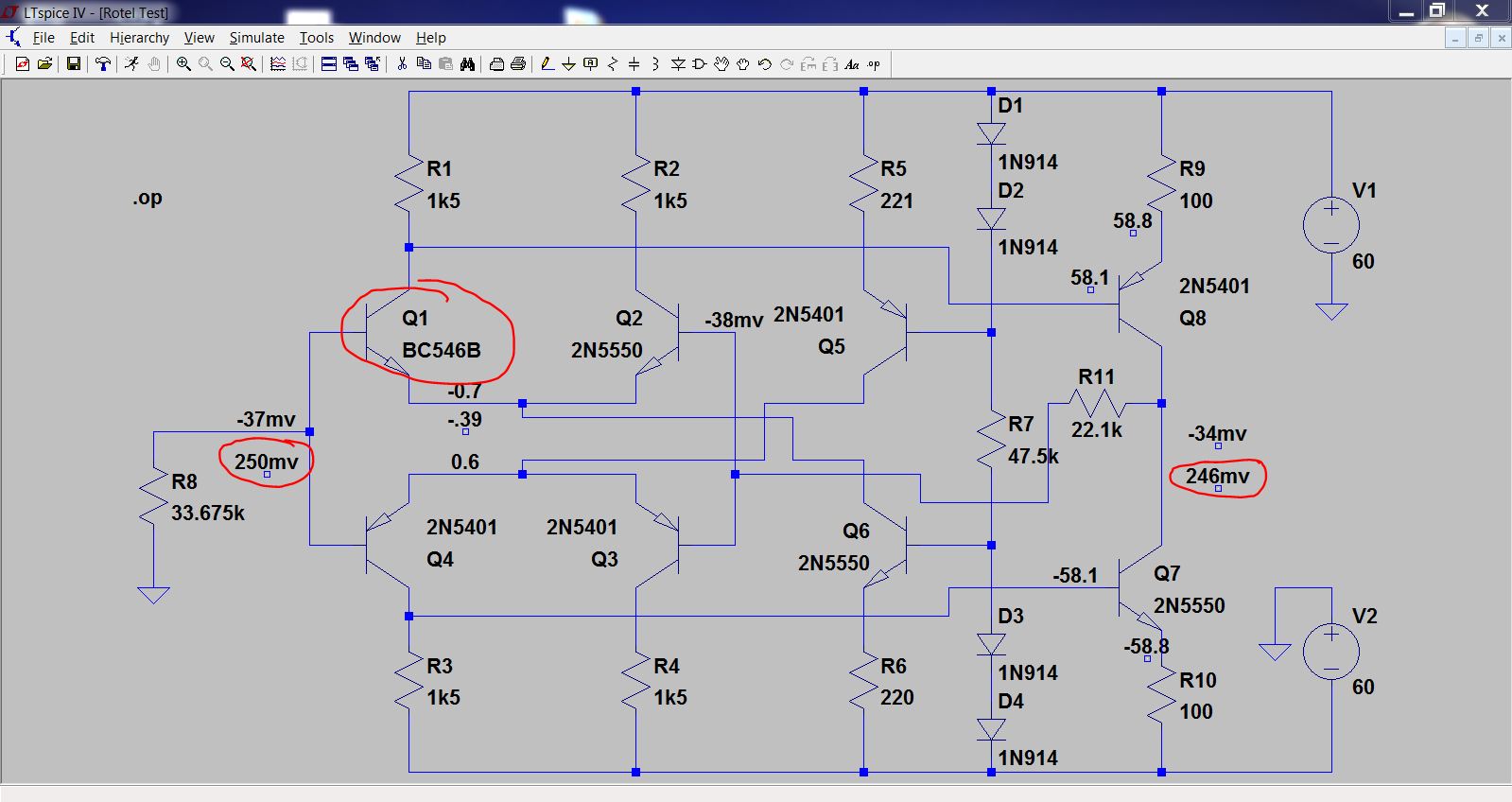

Administrator
Joined 2007
As a quick test I threw changing Q601 in spice and this is the result. The two figures in red are the offsets with Q601 as something different (as in not matched) So yes, matching plays a big part in this configuration... but even if your offset is 180mv its not detrimental to the amp or speaker. Just nice to get it lower :)
Just noticed your simulation... I will consider this a potential path
forward.
Thanks again
Stay tuned
Administrator
Joined 2007
Good thinking :) but in practice the offset is independant of the bias settings and component values. It is all down to the balance of the input stage. Some amps would include a trimmer between the emitters of the input transistors to trim the offset out.
