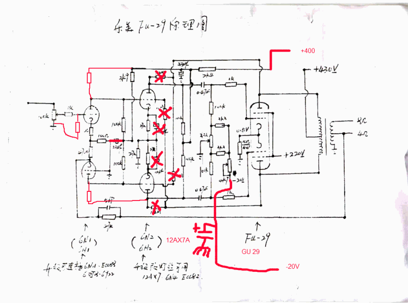

Kevin, understood. I have two meters so no problem. As already suggested, both valves are likely okay -- just a matter of adjustment, since the amp was not setup by the factory. Which was the spec for the amp as ordered, so Prime amp cannot be blamed --- .except for that crazy illustration! Thanks again for all the replies and moderators for helping! steve

In addition I found another great source for modifications and hint´s. I modified my audioromy already and implemented the LM317 modification which limits the bias of the FU tubes to constant 53mA. No more bias adjustment, no more red plate ! Easy to change the output tubes - the only adjust you have to do is balance.
