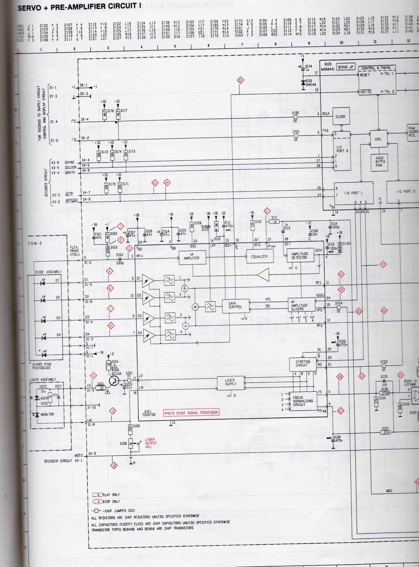

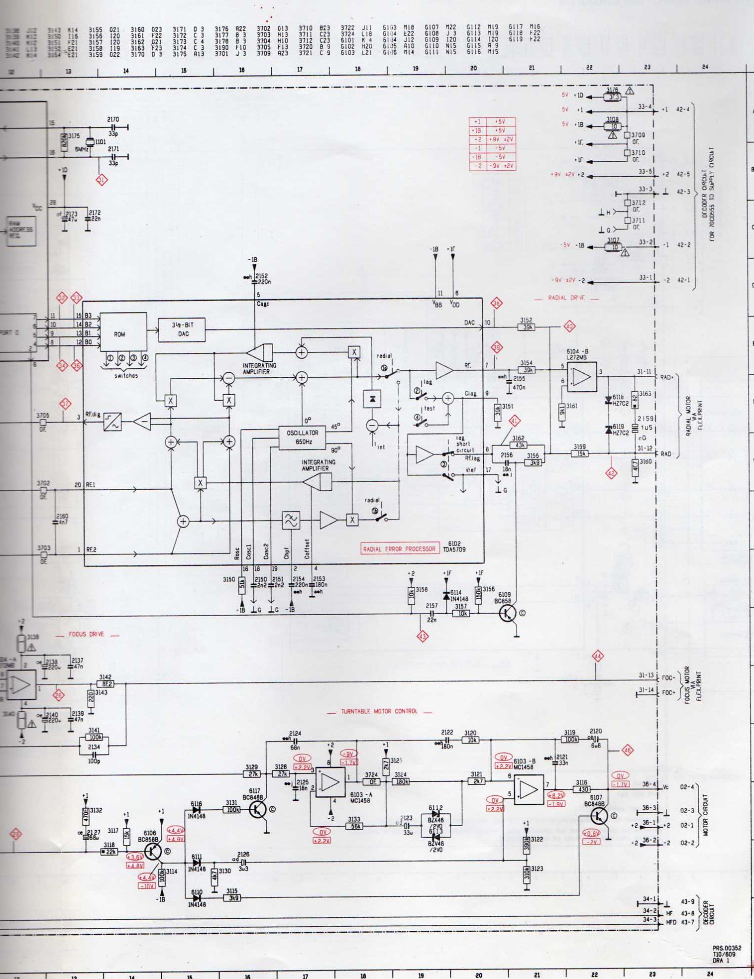

You have it all in bits then... I was looking at the motor circuit, and see it uses a Hall effect sensor for rotational info and feedback. There is also a pot on the motor PCB to optimise the "drive waveform"... the motor is AC.
I think the real test is just to see if it still rotates when the VC line is grounded.

The VC line is from the output of the final opamp in the last diagram I posted... one of the four leads to the motor. Just apply a short across collector and emmiter of that transistor that mutes that line and see if it kills the motor rotation.
... ... The VC line is from the output of the final opamp in the last diagram I posted... one of the four leads to the motor. Just apply a short across collector and emmiter of that transistor that mutes that line and see if it kills the motor rotation.
Yes it kills !
But nothing appear from pin n°21.
And your diagram is wholly different.
Incomprehensible.

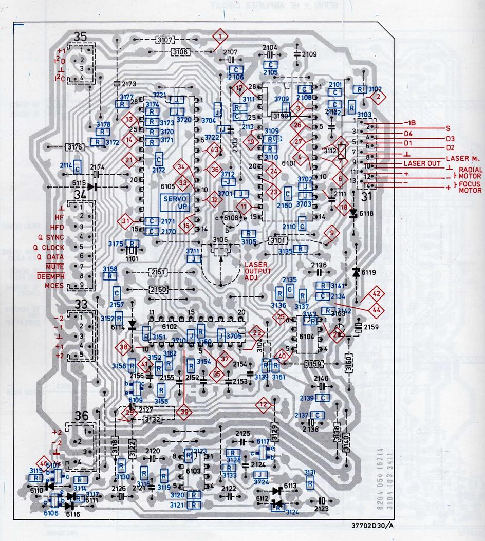

Why is it different ?
This is the underside view of the PCB in your photo.
If shorting the VC line kills the motor then the same should be true if pin 21 is low... and you say it is "nothing on pin 21" so the fault has to be in the mute circuit as I described.
So you need to recheck/confirm... pin 21 low.
Do you see those three diodes... D6110, 6111, 6116 that have there anodes connected together. There should be 5 volts on the anodes if pin 21 is low. If so that then turns on the mute transistors killing the VC line by shorting it to ground via the transistors... maybe one of the diodes or transistors is OC.
if not and no 5 volts on those anodes, then the logic invertor transistor is OC

Hello Mooly,
I do what you said me :
- pin 21 ( IC6101) is as previous, either +5volts, or 0volt
- but after...
- and if I put VC = 0volt, CD motor stops
See below I make all these voltage measurements :
What do you think now ?
The best would be to change Q6106 ( BC858B ) but not sure
About this servo card, I have no diagram ( your layout was a good thing for me !! ) for my understanding
Thanks to You again,
Raymond

Q6106 appears faulty. I can't see there being any "contributing" cause as it's all high impedance stuff off the collector.
As a further test, if you apply a short across C and E of Q6016 the motor should stop.
You can use an "ordinary" transistor if you can make it fit, something like a BC556 etc... just watch the pinouts.
Just to go back to the readings, and the voltage on points B and D. D is fixed at 5 volts. point B can never go lower than around 4.3 volts due to the Base Emmiter volt drop of the transistor. So you having 2.9 volts on there is a sure guide it's duff.

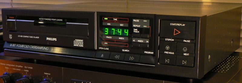

- The only bad thing surviving - before it was - is one problem with led display on the faceplate :
See the number " 5 " with its median bar missing ( also for 2, 3, 4, 6, 8 and 9 ).
One idea Mooly ?
You know all the responses.
I would think this is a failure in the led display block and then nothing better to do.
Raymond

The display itself is faulty, it was a common problem on the Philips machines.
You really don't want to read this, I had one and sent it to another DIY member down under. Post #13,
http://www.diyaudio.com/forums/digital-line-level/101748-lcd-readout-broken-bad-joints.html
So you must keep a lookout for old scrap Philips players... don't know if they would still be available new as a spares item and if they were at what cost.
Really pleased you have fixed the main fault though.

First congratulation to your troubleshooting and error remove. This failing I would not have believed as the most likely cause.
Unfortunately the display driver IC and the seven segment displays here is one module (one unit):
Type NSM4202A Philips code: 4822 130 90262
used e.g. by cheap to get Philips "CD-160" (CD160), additional by CD-350 and some other models (in this aera industry standart, not custom made device, available in green, yellow and red - as I know)
here some other links, perhaps useful:
http://www.diyaudio.com/forums/parts/152991-anyone-know-source-nsm4202a-led-board.html
Re: Assistance with obsolete parts
philips cd 160 display, Suche - HIFI-FORUM
http://www.okdatasheet.com/datasheets/ATMEL/NSM4202A.html
An other possibility it could be to find out the IC type of the internal display driver IC. Then you can buy this and 4 pieces of 7 segment displays to clone this. The advantage is here to get a part in a new condition, the disadvantage the great effort.
