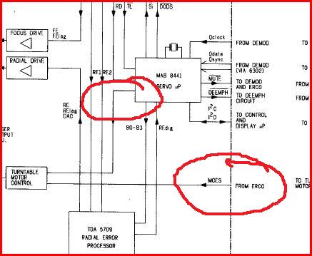

Hi Mooly,
I do it :
- mecansm is a Philips CDM-4/28 ( march 1989 )
- pic of servo card located just behind mecanism, with one MAB8441P-T012, one TDA5708 & TDA5709 ... But I am still thinking this MAB -T02 is for CD reading operation ( no problem with that ) only
- pic of MAB8441P-T042 on control/display card located behind the faceplate and dedicated for mains switches circuit : THERE are issues ( no stop, Error program )
And I am begining to understand a bit more.
If I refer to your picture :
- MCES ( from ERCO SAA7020 ) is OK because no reading problem,
- top line ( from the MAB-T02, servo microP motor control ) has problems due to, either I²C/I²D line ( to control & display card, with its MAB-T042 ) or MAB-T02 servo microP itself.
Professor, your advice !!!
Raymond

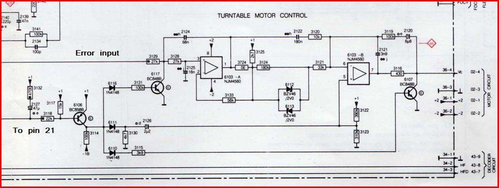

Look at the attached diagram... you need to understand how it works. The plug just up from bottom right goes to the motor. Four connections, ground and a plus and minus 9 volt supply where it says +2 and -2. VC is the control voltage to the motor... more volts, motor goes faster basically.
You will see three transistor, Q6106 is just a level shifter/invertor. Q6107 and 6117 "short" the motor signals to ground... so that will be the condition for the motor not to run. Pin 21 of the MAB ic needs to be low for that to happen.
So you need to check... and it might be easier to solder some wire to the appropriate points if acess is impossible with it on... that VC which is pin 36-4 on that plug is at zero when the disc should be still.
If it is we are looking at a possible motor problem.
If it isn't you need to check that pin 21 is low (a leaky C2127 would give this fault too I think, holding that control line high... depending on whether the ic can source the current) and take it from there.
When pin 21 goes low that turns on Q6106 which in turn switch on Q6117 and 6107.
So you want pin 21 low
Collector of Q6106 will then be at +5 volts which turns on Q6107 and 6117. Colle ctor volts on both these will then be at zero volts.
