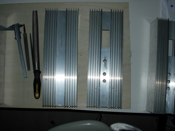

I have been gnawing away at the chassis, working on them when i have time. I have atatched a preliminary image of the heatsink with some rough holes cut for posts and sockets. Still much work to be done but there may be an end it sight.
I will post images as i get further along and no doubt more questions

Insulating Mosfets???
I had read in antoher post that the Mosfets need to be insualted from their respective heatsinks otherwist there would be a shorting problem.
The mosfets I have used have a metal back, do i need to electrixcally isolate these from the heatsinks or can i attach them directly with a threaded screw and some thermal grease?
If they do need to be electrically isolated, what product should i use?
