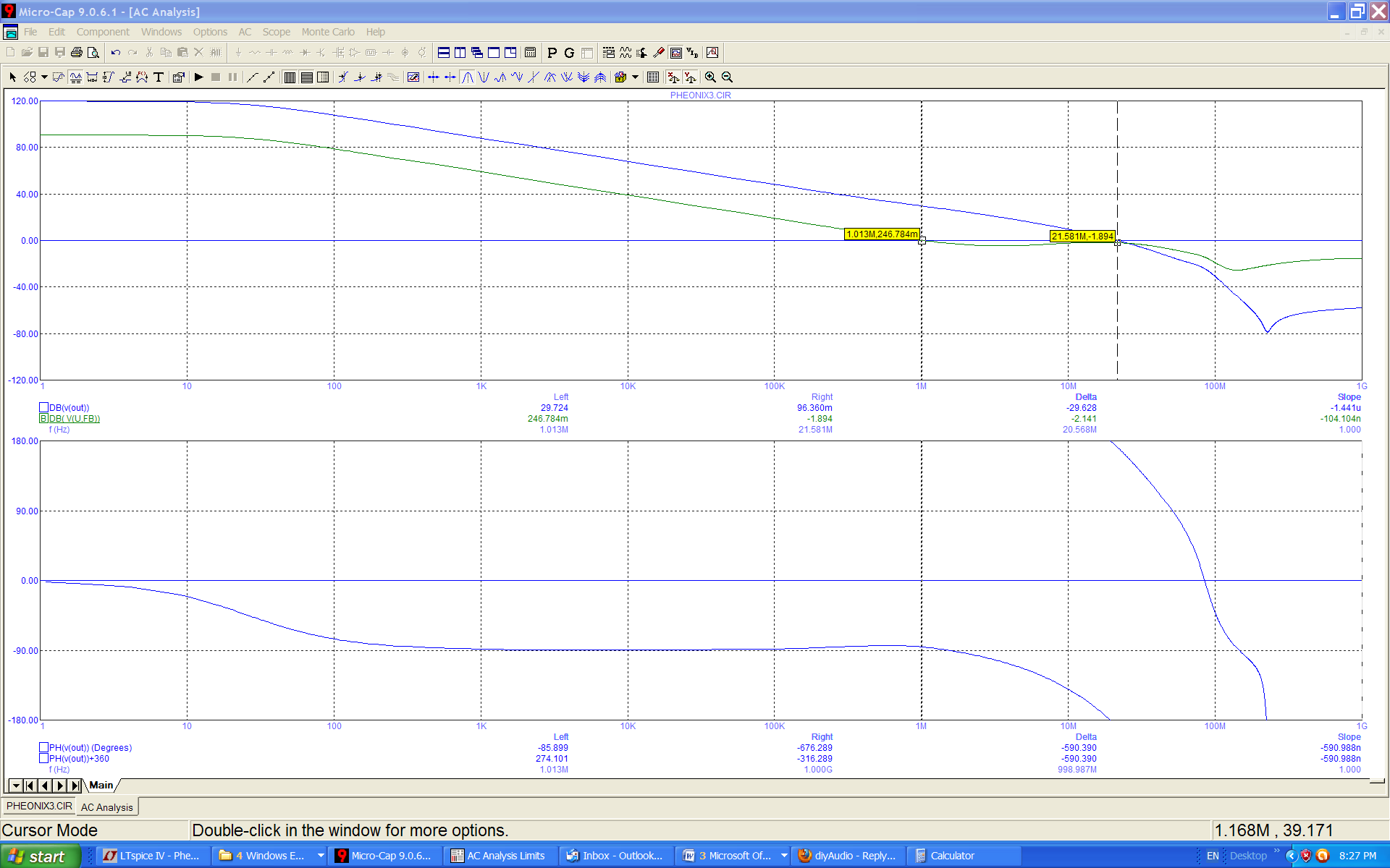

The open loop response
Hello Edmond,
I am looking over the Pheonix circuit modifications and will need a couple of days before I make any comments ( busy with work) .
But I have one outstanding question in posting #219 of this thread I attached a file which was my attempt at the open loop gain , using this approach on Pheonix3.cir I get the following Phase margin , which seems a bit confusing. The DB(v(out)) is 21.58MHz at 0 dB which seems a too high, where as DB(V(U,FB)) at 0db is 1MHz PM=85 degrees which seems a bit more like it. Am I looking at this information the right way? is this the open loop response of the amp. I am just curious on how to get the combined loop gain of the whole amp and in fact if this is how to do it.
With regards to the 22R as apposed to the 4R7 (for the base resistors of the output transistors) I have found that 22R eliminates parasitic oscillations which can occur with the Sanken 2SC2922 and 2SA1216 in practice (my experience). Another person who does a similar thing is Bruno Putzey.
Regards
Arthur

loops
Hi Arthur,
Although it is the open loop response of the amp, this is not what we are looking for. Admittedly, the terminology is a bit confusing, but 'open loop response' (of an amp) is not the same as 'loop response' (of a loop), that is, the gain and phase response of a specific feedback loop. The latter is roughly equal to the open loop response divided by the closed loop response. But I never use this relationship, as it it prone to errors. I always look at the properties of a specific FB loop itself.
Hmm... difficult question. I don't know the right answer. The problem is that the amp has several separate loops, so how on earth you define the response of the combination of all those loops? For the time being, I think the best you can do is breaking the loop at the point that determines the overall gain of the amp (=closed loop gain). Normally, this is also the most outer loop. In this case between node 'out' and R3. (see & run: pheonix3-outer-loop.cir)
E.

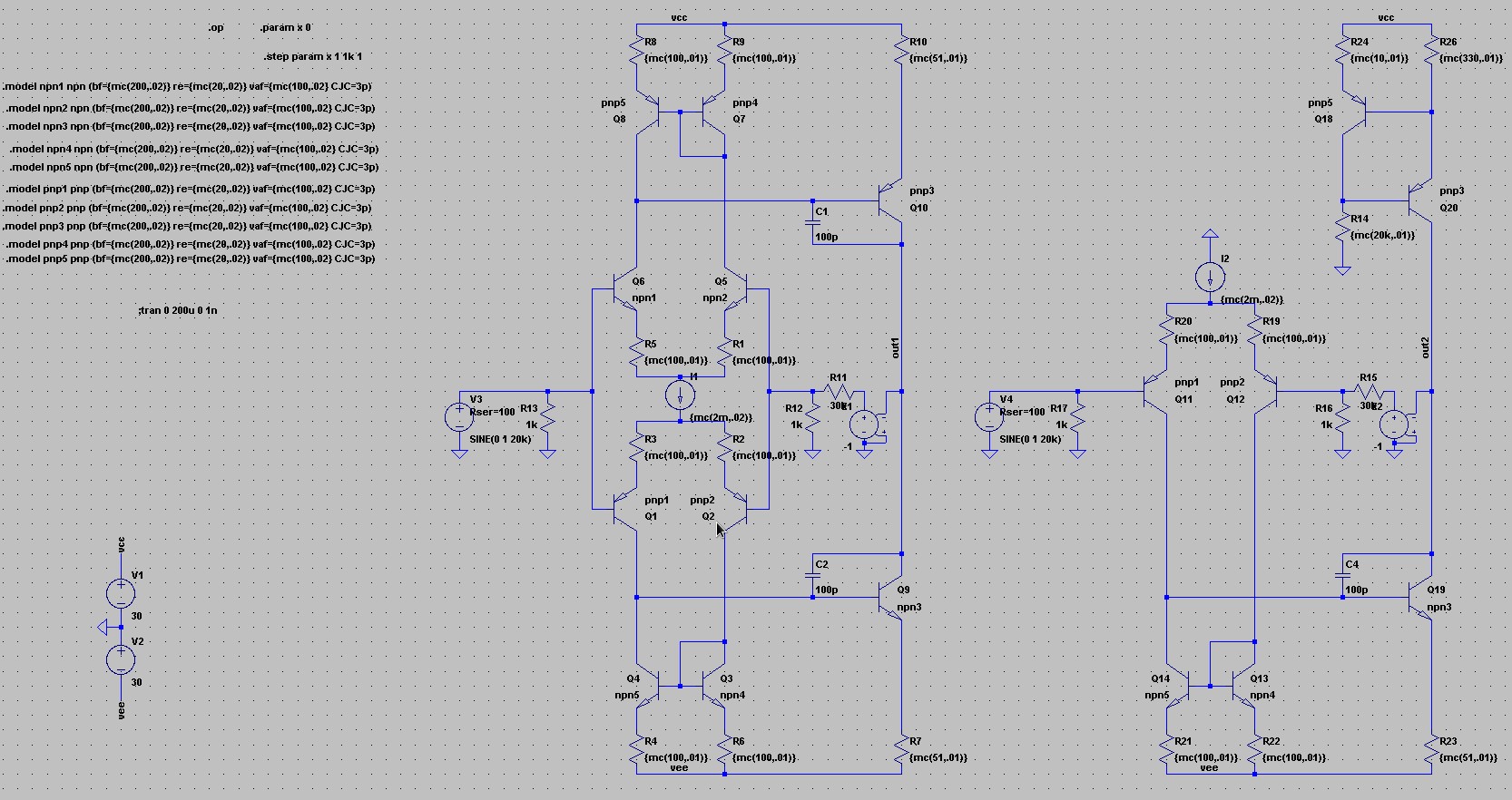

Hi Wahab,
OK. This can be explained by the (nonlinear) loading effect of the drivers.
1. By how much? 1dB or 10...20dB?
2. Due to what? The unloading effect or increased loop gain?
Therefore, may I suggest to use another test circuit, that doesn't suffer from DC drift altogether?
What about this one as shown below? An idealized 'blameless' amp, except the VAS, which is a 'real' tranny. The IPS is a transconductance stage with a gain of 20mA/V and the OPS is a simple voltage follower with a gain of 1. THD20k-TPC = 32.7ppm; THD20k-TMC = 29.5ppm.
Since the effect of TPC vs TMC is only marginal, I think that the slight improvement should only be attributed to the unloading of the VAS. If the VAS has benefited from TMC to the same extent as the OPS, then the improvement should be much higher, in the order of 10...20dB, which is not the case.
E.

The current is not stable because the bias volage is not stable.But why is it not stable? In simulation you have always stable voltage and current for the VAS.So it must be a problem with transistors and not with design.And it's possible to make it working, but you must use good parts.Close matched transistors and resistors.

no!it must be a problem with transistors and not with design.
Slone's design is flawed.
There is some speculation in this Forum that he never built this design to find the flaw in it's design.
And yet he built a reputation as an amplifier designer and author and still recommends a flawed amp design!
It doesn t work because the current mirrors transistors
drop voltages are lower than the necessary threshold to
make the two VAS darlingtons conduct..
The DC loop will try to balance the whole amp,
but unfortunately, it will do so abruptly , generally by oscillating.
Using a single device as VAS doesn t fit either, as the
current mirrors device are almost saturated and therefore
the once necessary threshold is reached only thanks to
devices dispersion, i.e, if the saturation voltage of the mirrors
transistors is higher than the said single VAS Vbe. Very unlikely..

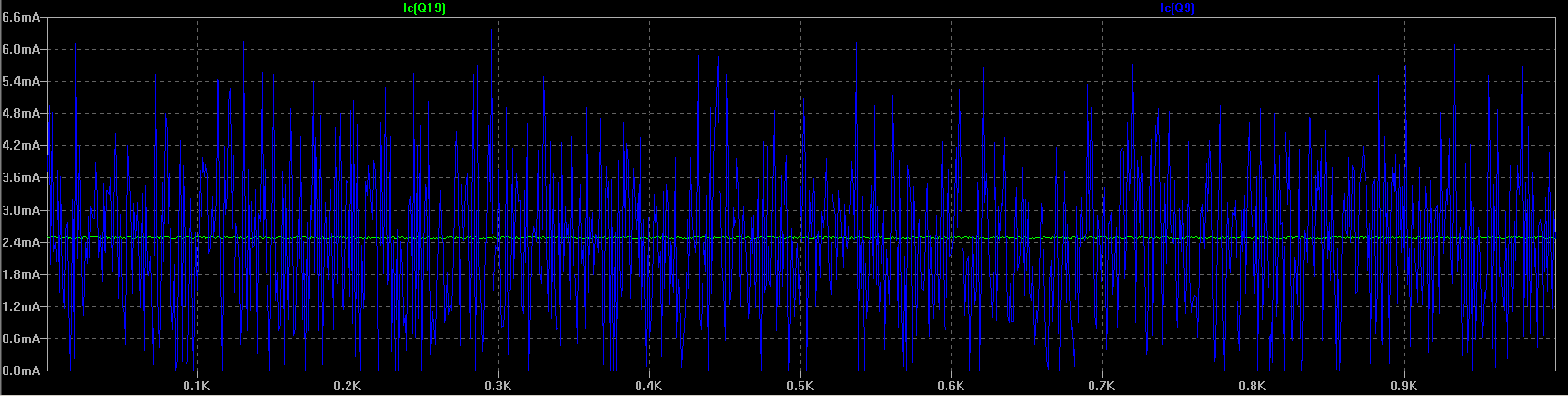

O.K that's your opinion, that this design is flawed, but it works in simulation and even in real life.I've build this amp, so I know what I'm talking about.Even if there are some problems with unstable voltage, it's not that big problem and I think it's due bad transistors.
Leon,
Believe me, read this thread and you will be convinced it is futile to continue with that schematic. I already lost over 1000€ and it still is unstable. Do me a favor. In your amp or in the simulator. Change just the left upper emitter resistor by 1% up or down. Tell me how the VAS standing current behaves?
In my case (that is with Darlington) it varies from 0 mA to 300mA whereas it is 40mA in the simulation if both emitter resisters are identical.
One day it worked in real life with a standing current of 60mA (a bit high but it could work for some minutes). I did the same test raising 1 resistor +1% -> current goes to frying mode -1% -> current goes to zero (or class C operation)
I took pictures an dposted them here.
Go for the CMCL solution Edmond is talking about ...

Slone's design is extremely sensitive to component tolerances. Normally, we call this bad practice.
Yeah, Monte Carlo analysis easily confirm this.
Then we should consider all designs with current mirrors futile, but Sony for instance has build a million amplifiers wich have current mirrors and cascode VAS, but are not simmetric and all they work very good.
And there are users here wich have build this amplifier on stripboard and it worked.So it's apparently not bad design (if you are lucky enough).
