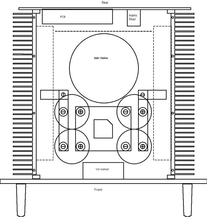

100W chassis (2 Conrads).
Hi
This is an overview of the chassis from topside. Very simple drawing. Two Conrads MF-35-151. One on each side of chassis (one for Pos rail. and the other for Neg. rail). My intention is to use MJ15003/4 for my design. Front panel is 10mm. This drawing shows an included VU-meter at the front panel.
Rear panel will be punched for all in/out connectors including all fuse-holders and switches (bal/unbal, VU: 0dB/-10dB) I could post pictures for rear panel if you want.
Chassis will be build with two ventilated bottoms, one inner and one outer bottom plate. Its purpose is to hide all cables inside the amp, all screws, also hiding some small PCBs for VU, soft start and DC-protection circuits).

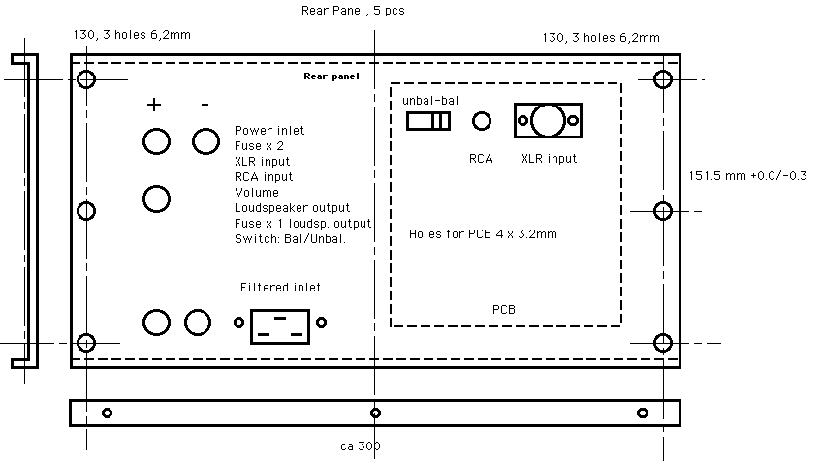

Rear Panel:
This is v-1.0 of the rear panel (do dimensions yet) only panel will be approx. 300 mm wide and 151 mm high.
All panels, top and bottoms will be black anodize in color. Rear, top and bottoms should also be punched for ventilation holes. Material would be 2-2,5 mm Alu plate I think. (have problem to upload pictures)
