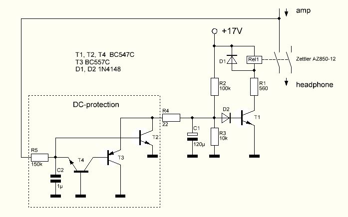

Andreas I´m interesting on you delay startup an DC protection.
Please, Would you say me something about this?
Yes of course, it´s a very simple circuit consisting of 4 Transistors 2 caps and a couple of resistors.
Delay time is approx. 1,5 sec ( short, but time enough for PSU to settle to stable voltage), so typical power on pop won´t occur.
Threshold for DC protection is about +/- 0.5V, that means any DC above 0.5V (+ or -) caused by a fault will switch off the output relay immediately to protect the headphones ( and ears ).
Tomorrow I will post the schematic and some explanations. ( Sorry, but not time enough now)
First I have to say that there are many ways to realize such a circuit, my goal was to keep it simple and to have only clean voltages on the amp board, so the circuit is supplied by regulated pos. rail. This has the disadvantage that the relay switches off not immediatelly after power off, it needs at least ca. 0.5 sec ( it depends on the value of psu caps and the current draw of the whole amp.circuits)
In a few words:
Power on delay time is determined by the time constant of R2/C1
T2 will pull down Vbe of T1 if pos. DC voltage exceeds ca.0.5V, T3 is doing the same for neg. DC voltage.
R4 (possibly not necessary) limits just the discharging current (C1) if T2/T3 switch.
I´m using +/- 17V supply for my amp, for different supply voltage some values have to be recalculated, also R1 might not be necessary with another relay.
For T1-T4 any small signal transistor will be sufficient with current gain of >400 ( C-types)
I used the whole circuit in each channel ( consequent dual mono), but it´s possible to use just the second relay contact for the other channel. But the DC protection circuit must be duplicated for the 2nd channel.

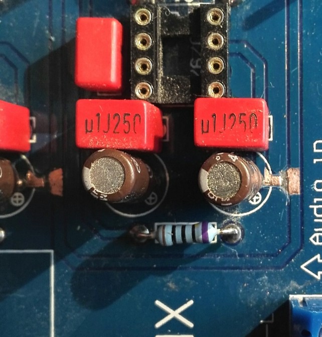

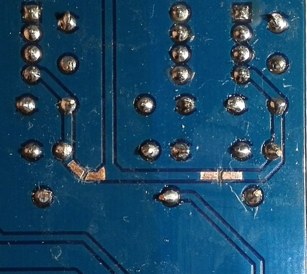

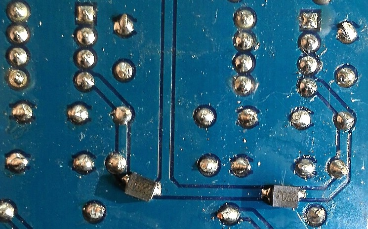

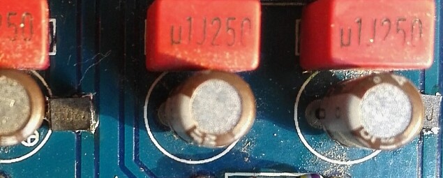

Not a BCL but...
...long over due update about something I wrote that I was going to do.
I dusted off, well almost lol, the second XP-7 board I have and did the "inductor mod".
I will replace the XP-7 board in my PC headamp with this to see if the simulated improvements translates in to real world ones.
Pics attached of cut traces and the mounted inductors.
