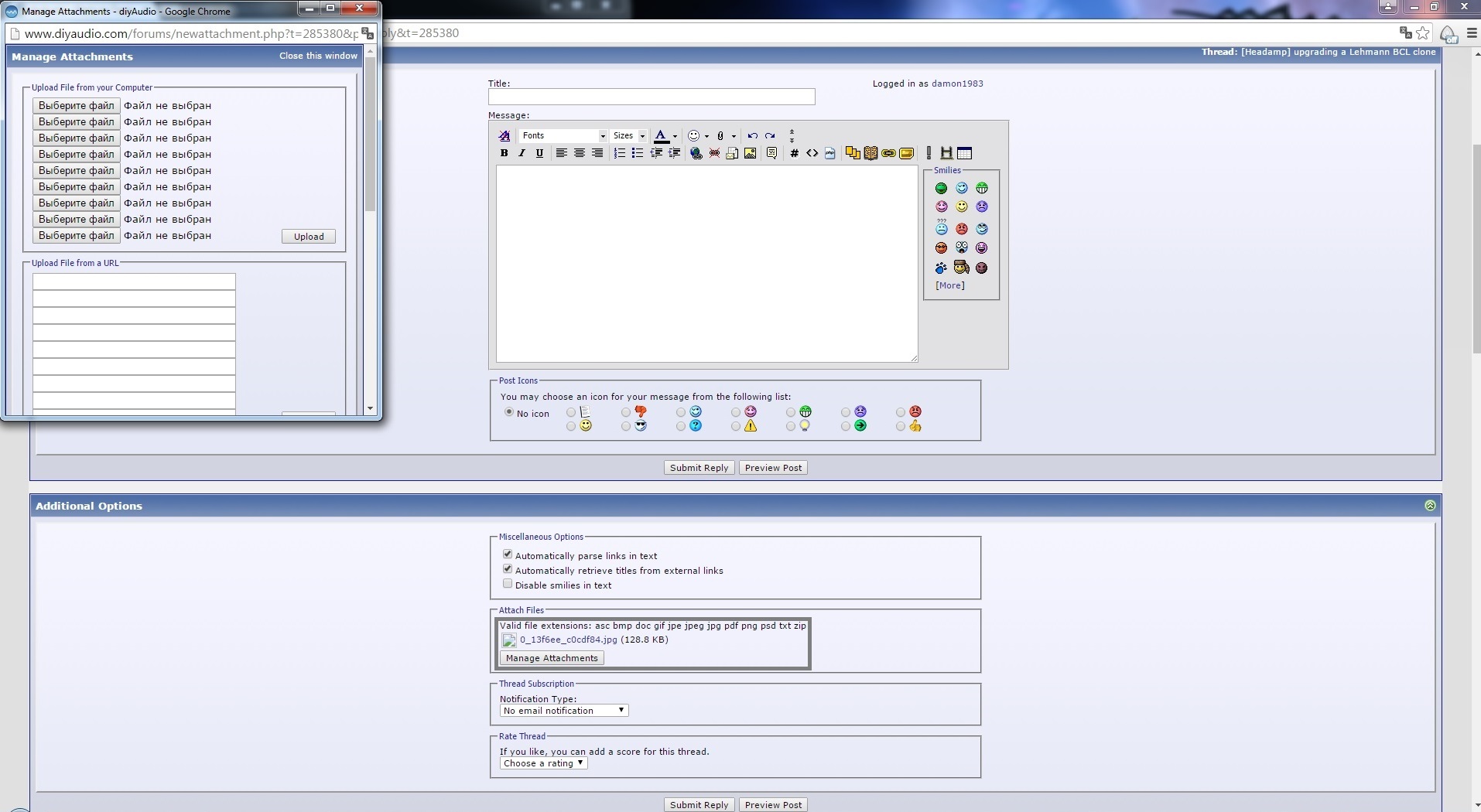

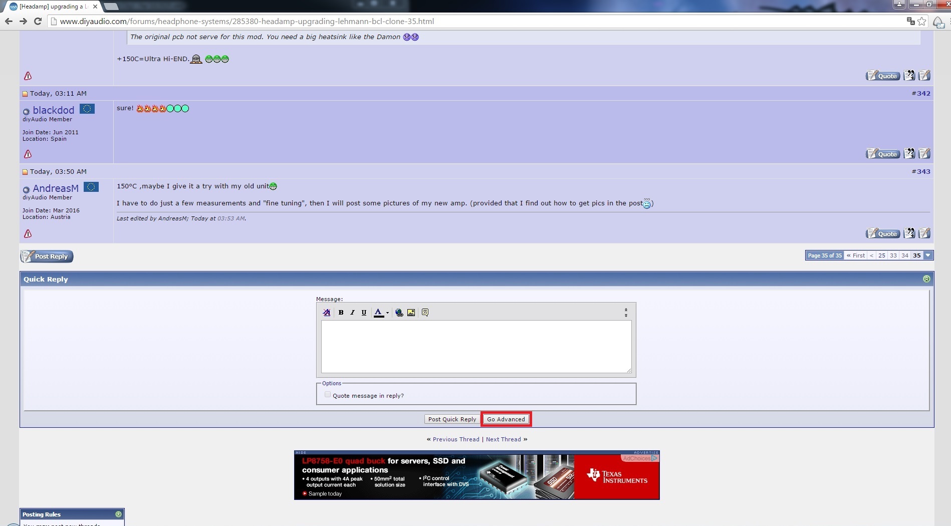

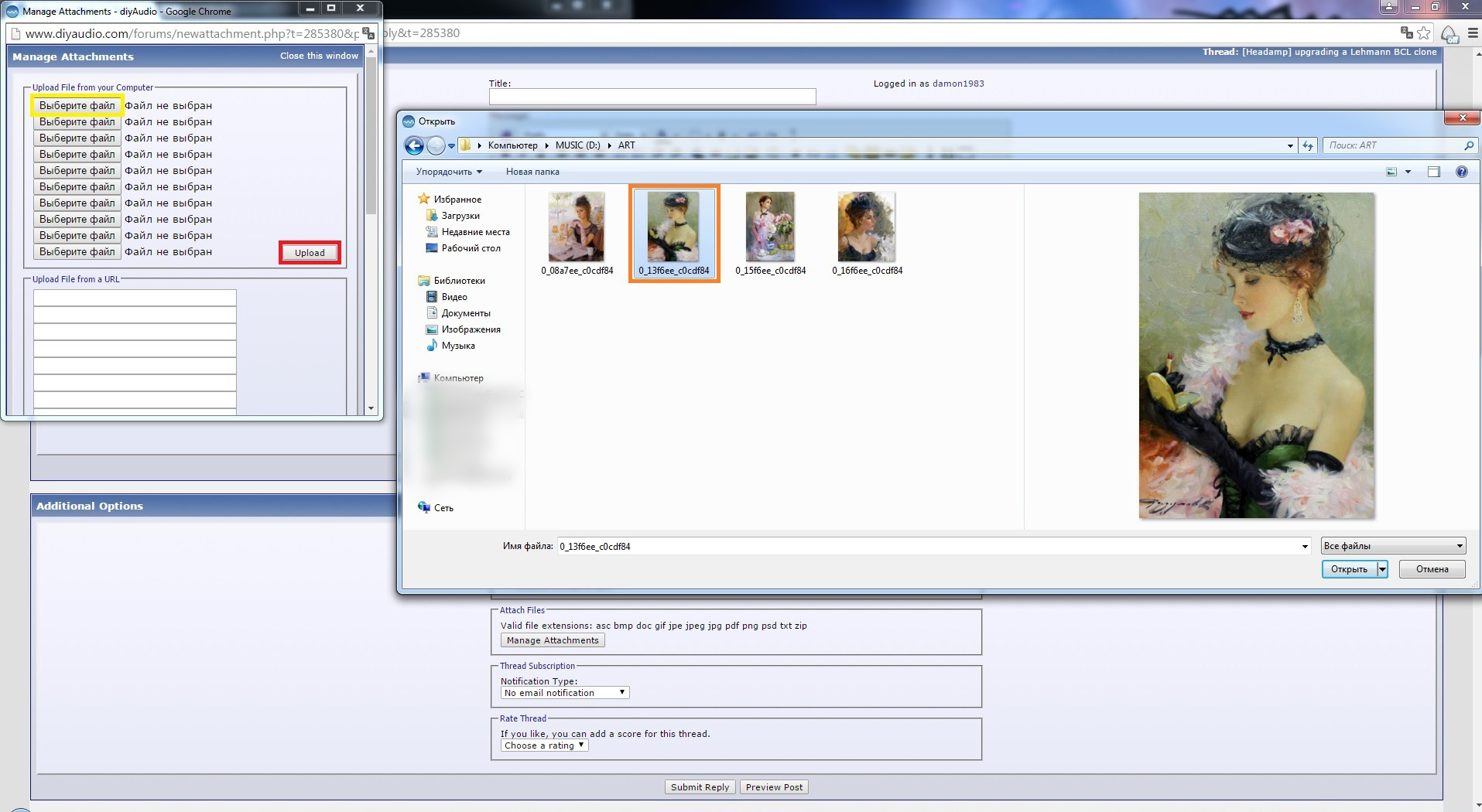

I have to do just a few measurements and "fine tuning", then I will post some pictures of my new amp. (provided that I find out how to get pics in the post)

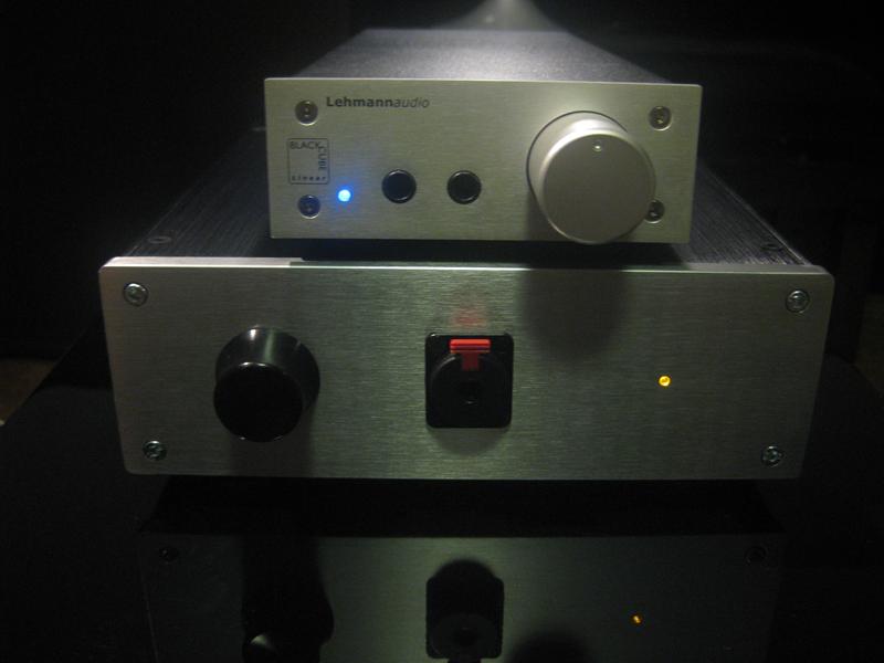

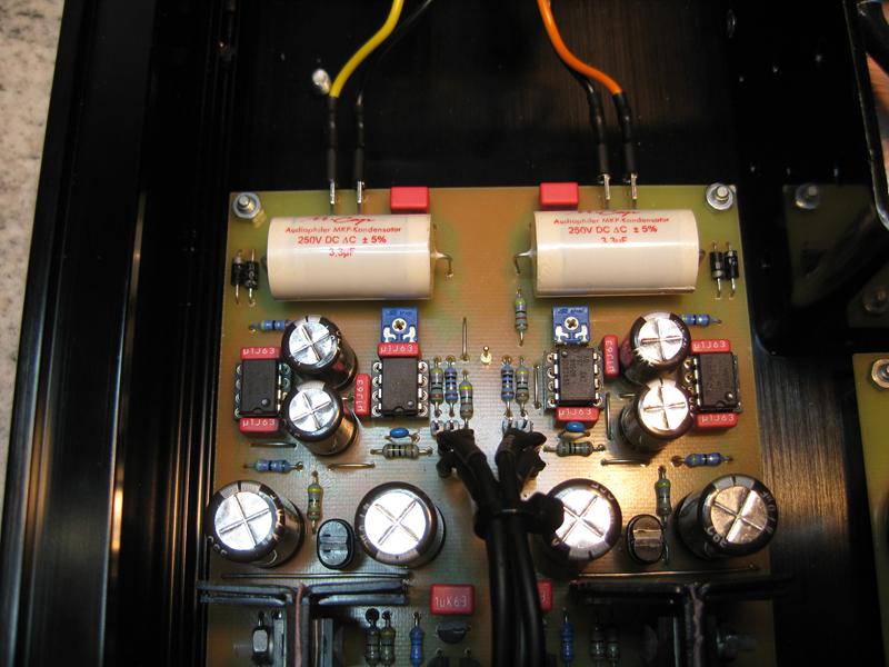

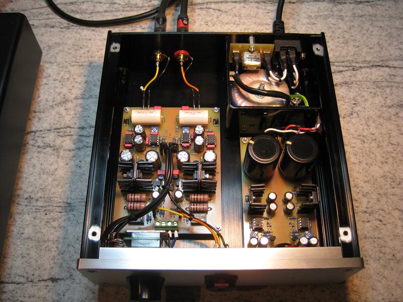

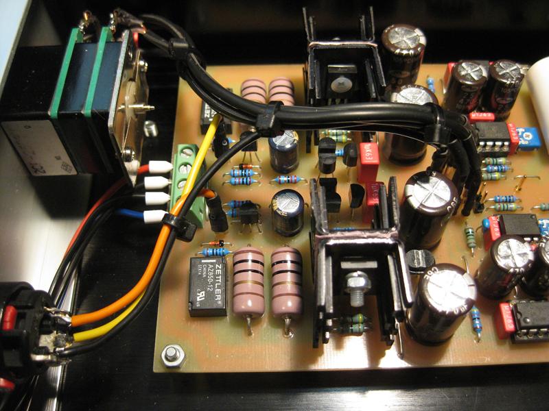

Some pictures of my just finished redesigned BCL? The only thing which remained unchanged is the output buffer, every thing else is very different.
Please be tolerant regarding my home etched PCBs (single layer), they dont´t look that nice and of course you can´t compare them with manufactured PCBs.
1st pic.: you can see that my enclosure is slightly larger than the original.
2nd. pic: I divided the project into 2 PCBs, PSU and amp , the transformer is a toroidal 15VA and mounted in a séparée
3rd pic.: PSU caps Mlytic 6800µF/63V, for the voltage regulation I adapted the marvellous Jung/Didden superregulator to my needs ( I hope Jan won´t bite my head off therefore)
4th pic.: coupling caps Mundorf Mcap 3.3µF -> AD797 gain stage +10dB -> volume pot. 10k TKD CP2500 -> LM4562 unity gain follower (I can hear you damon - "very crappy opamps") this arrangement gives a noise improvement of 14dB (source impedance 200R, gain +10dB, volume -6dB) compared to the orig.
5th pic.: output buffer, complementary transistors thermally coupled - BD139/140 as well as BC550/560, DC offset remains stable ,right <1.5mV ,left <1mV
output relays, including delayed startup an DC protection
The layout is designed consequently dual mono, so I wasted some parts ( e.g. relay, LM4562).
The result is an excellent crosstalk figure of -102dB (200R source) at 10kHz, my orig. BCL measures about -75dB.

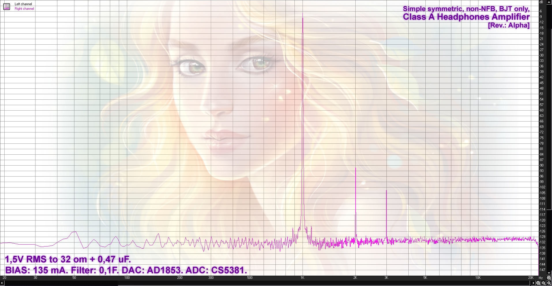

Old Alpha version.
(As I remember here was little mistake, I'd used 1 uF cap on load instead 0,47uF).

good looks, but I have some stupid questions.
Thanks, I will answer every question (except the right lottery numbers for next week).good looks, but I have some stupid questions.
Thank you blackdod.Andreas your "clone" is on other level. Very nice
Well, during soldering the PCBs I recognised things I would do different in my next attempt, also I used only a low number of "boutique parts", so there is still potential for further improvements. But for the moment I shouldn´t be too obsessed.
I would like to say a few words about the sound.
I directly compared my own build with the Lehmann (same sound levels of course), it´s a matter of a few seconds to replug the amps.
I must admit that my amp is a big step forward (not the right place for modesty), it`s easy to recognise a clear difference.
The sound is much more open, plenty of "air" between the instruments. Mainly with classical tracks I can really "feel" the recording location, with the Lehmann I can´t experience this.
But I should stop with the self-laudation now and be just happy about the result.
