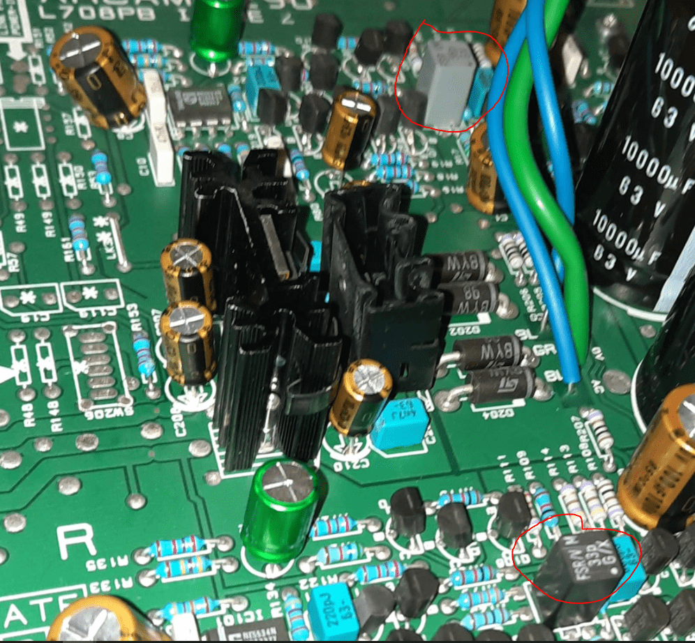

ya i know but i had 2 of the 3 amps that needed to be fully taken apart 1 needed new main caps and the other needed new speaker terminals and had one cap not looking very happy and was under rated compared to the other channel so i thought i might as well do the hole lot.
according the the service manual there meant to be 56pf and the grey one is 33 so i need to change that. also what type cap is that?
i couldn't compare with the 3rd amp as it was an earlier revision and the pcb is completely different using a glass looking cap?
