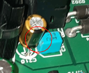

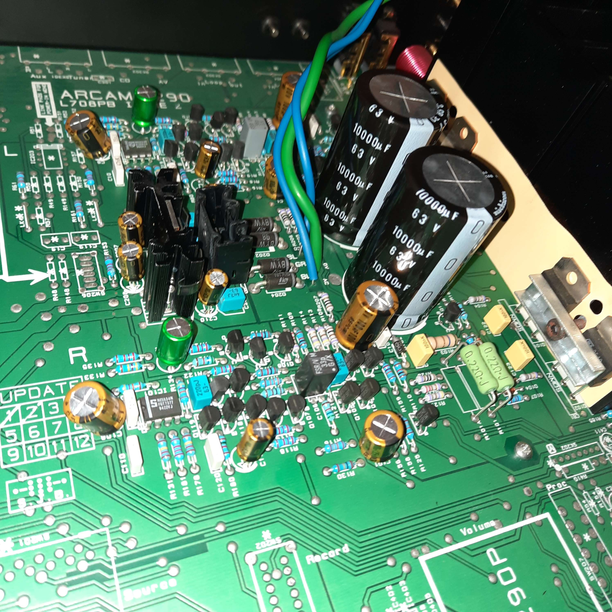

I'm currently recapping my arcam delta 290p (started on 1 of 3)
i am having an issues where once the small cap is out the hole get filled with solder that i cant get out or melt
i have used a desoldering tool
it just keeps getting worse the more i try.
has anyone get any tips i have thought to get a 0.3mm drill bit but i really dont want to go down that road.
thanks for any help
Also i use the hakko FX-888D and EDSYN DS017 DESOLDER TOOL

ya I'm new to soldering i did a arcam alpha 6 recap with new mosfets and recapped a sub that had that horrible rubbery glue over everything but this delta is a nightmare took me 30mins for 2 caps and got the caps hot HOT but I cant do that 2 again.
took off a pad for one and yes the solder was melted and everything was free moving.
i think the traces go to both sides so i might just solder from the top if it comes to. and this pcb was made around 1991 to 93 so its using leaded solder and I'm using lead free solder so it might not like the mix. (i do clean off the old solder as much a possible)
i have checked that my soldering iron is hot it melts solder instantly.
For a really stubborn hole, where neither the desolder pump nor wick works, I've used a pair of fine tip tweezers. Place one tip on the hole, heat the pad while pushing the tweezers into the hole, pull the iron back first and then the tweezers. You have to get the timing right, but it has worked well for me.
I agree with those that said add fresh solder to the clogged hole and suck that up. It works much better than trying to suck that little but out of the hole! If you use a solder sucker and have any air gap around the tip it will suck air instead of solder. A juicy blob of solder let’s you put the nose of the sucker down in it and it just pull the solder and not air. Be very careful using a tiny drill but in multi layer boards as you can damage the middle layers and not know it until the thing doesn’t work and you say dirty words! If you can’t clear the hole no matter what you can place the leads of the new part on the hole and heat the lead very close to the board and slid it through but this is a last resort. You can also try heating one side of the hole with a little extra solder then sock from the other side. Find an old piece of junk circuit board and practice before you ruin a good board.
idk if its a multilayer pcb but i think the pads on top make a connection to the bottom.
also its was either floating caps or too big caps.

i didn't want to use the drill bit but I'm very careful with it ,im slow and make sure that I'm centred and i think the hole is 0.7 or 0.8 mm as with a clear hole it can wiggle around a bit. plus the board was not designed for the heat of unleaded stuff so the board's solder mask on the traces just come off with the iron too close. so im trying to stay away from high heat atm.
also the film caps say 100u is that just 100uf?
