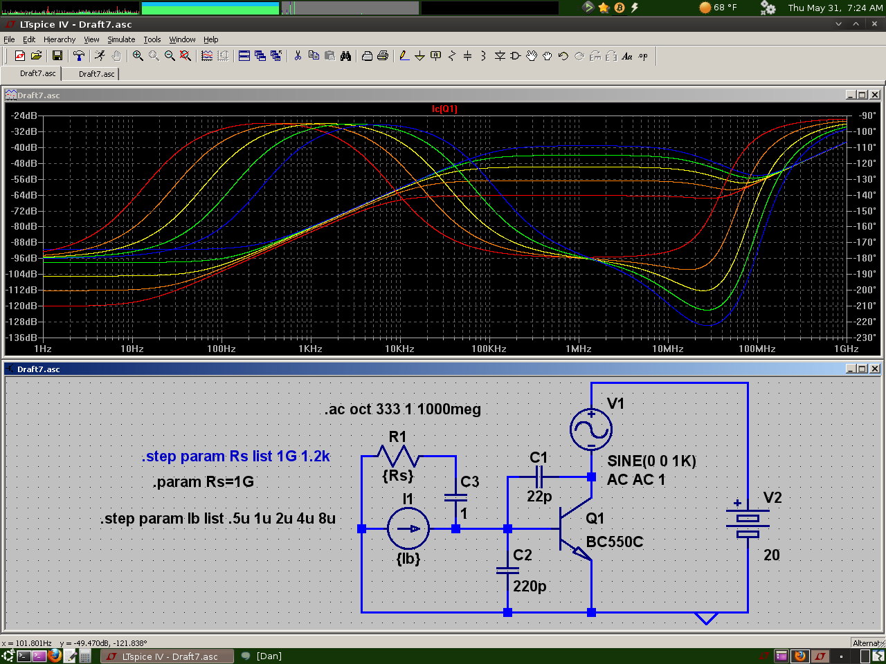

I know that some of Boraomega's designs have a 4.7nF capacitor across the BE junction of the VAS. It is an interesting design decision.
I've been told the BD139 has wildly changing Cj parameters depending on the manufacturer so I'll hazard at say, MJE243. Modern transistors have less Cbe, this may matter.

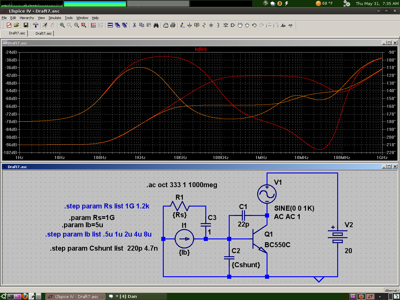

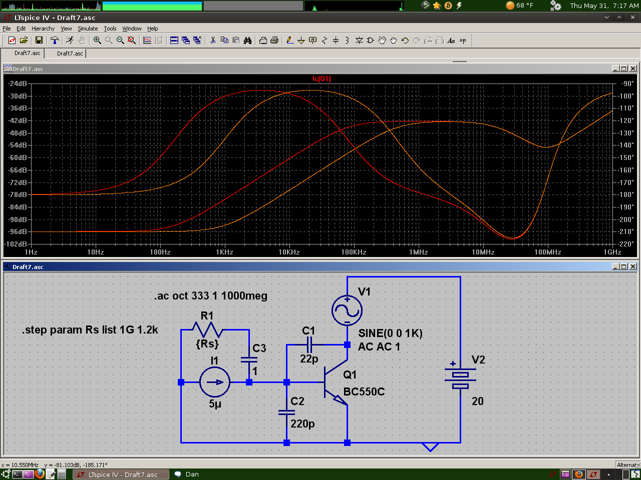

Here is an example. I use the BC550C model because it has very low internal capacitance, allowing me to add my own.
With the added Cbe and Cbc values forming a divider, you can clearly see the resistive collector impedance at RF, is different than that at low frequencies. If I take Cbe away, this does not happen. Red trace is with infinite input impedance and orange trace is with 1.2k input impedance, like some amps.

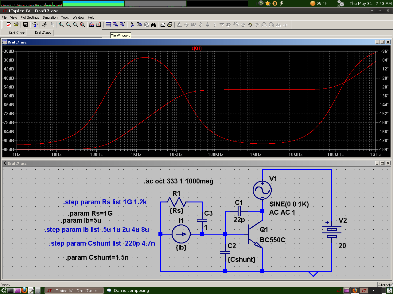

If we make Cshunt, or Cbe, very large, say 4.7n, the RF level gets lower, closer to the DC level. Judging by the anomaly at 10MHz it seems there is an optimal value here.
Red trace is collector response with 220pF Cshunt. Orange is with 4.7nF Cshunt.
Now I would guess, that in this cause, because both Cbe and Cbc respond proportionally to Vce, that in the capacitive divider configuration their nonlinearities will cancel. But this relationship is broken when you give the transistor a low-impedance input. Thus maybe making a case for a non-buffered or even current-drive VAS. Maybe I'm just crazy.
