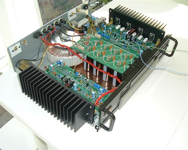

Update,
I received my power supply parts, and started wiring things up. Here is Randy Slone’s new low impedance power supply board, I’m using 8 10,000uf caps but the board can hold 10 caps. The transformer is an 800VA 50+50. Anyway back to work!! I will let you guys know how it sounds very soon!!!!!!
Looks great!OPTI-MOS PAT said:I received my power supply parts, and started wiring things up.
Where did you get your chassis and heatsinks from? Can you give me specific pointers and prices please?

The case I'm using for now used to be a Kenwood 5 disk CD player that never worked well from new, the aluminum plate is from a car amp, and I added the handles to it. This is a temporary case, as I plan to build a 4 or 5 channel amp in one enclosure. As for the heatsinks they came as a kit, which consisted of PCB all components and heatsinks. This is my first attempt at building an amplifier, so I decided to buy it as a kit form. He does sell things separately at his web site (seal electronics). I just finished setting the bias and it is ready for action! I will be connecting it up tomorrow morning, and see how she performs!!!! It’s too late now kids are sleeping.

Good job! Looks great and this just might be a reason for me to start building a case for my amps
Make sure that you tighten those blue connectors properly , and let us know how it sounds. You may also try to up the bias current a tad bit (have my OPTI-MOS kits running at 80mA instead of 40mA) and everything is better sound quality wise

Thanks for the advice, I will start with it at 40mv first for a bit and then I will try to raise it so I have something to compare it too. Does raising the bias only affect the sound quality or will it affect other things as well? I am hooking things up right now!!!!!!!

What's your power supply voltage? I have mine on +/-63V and the heatsinks ran warm to the touch at 100mA (around 40-45 deg celcius) so I backed it up to 80mA just to be 'safe'. It also depends on your speakers, mine are 4ohm, 86dB/1W sensitivity and they tend to 'suck up' more power than 8ohm higher sensitivity ones.
The OPTI-MOS highly benefits (sonicly) from the input tantalum caps removal (shunt with a piece of wire here) if your preamplifier permits (does not have any DC offset larger than 5-10mV). The preamp DC offset shouldn't be any trouble because the 470uf/35V in the feedback loop assures unity gain at DC.
Also solder the fuses in their slots (use a 100W soldering gun) to avoid excessive resistance causing rail dropping on heavy bass passages
The higher bias shouldn't cause any problems except for the 'small' additional heat; the amps are stable as a rock and do not run into thermal problems due to L-mosfets use (of course, if you get to mail Mr Slone about these he will tell you that is totally unnecessary and the fact that everything seem to sound better is just a subjective claim).
Just hook everything up, paying attention to the blue connectors that do not stand much fiddling around (I ended having the PS lines soldered because of this), run the amp a couple of days at 'defaults' and then up the bias/remove the input caps. If you feel there's any difference, leave it like this. If not back it up to 40mV between the two test points and remove the wire
Oh, I also tried changing the green mylar caps for metallized polypropylene ones and the sound got more congested in the dynamics department so leave those as they are, they do their job good.
