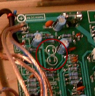

Checking my limited knowledge: to decrease gain you need to increase R17 to say 470R (and maybe increase R2 to 22k)?
There are 10pf caps on the mosfet gates in the latest OPTI-MOS rev. (oct 2003), c16 has a series 270R added, input diff pair changed to MPSA56, input protection D1&D2 are gone, and some more layout/resistor changes. I only have the schematic on paper, can't post it here...
Did stripping the protection circuit out had any benefic effects? I guess I can find out by myself by just removing q17 & q 18.
I'm also very curious about the mosfet source followers... if you keep the prot circuit in, decreasing source res values to .22 will get you more current capability before the prot kicks in? What if I increase R25 & R32 to 100R? Any other considerations here? The mosfets are not that well matched (Randy said it doesn't matter if the mosfets are matched or not) so I don't know if this would be a good idea...
Gain is simply (R20 + R17) / R17
R2 and R20 determine the input resistance and need to be the same value.
I can't say if there's any sonic benefit to removing the protection circuit becuase I took it all out during my process of elimination and have not put it back.
Do you mind describing the other layout and changes you've hinted at, I would really like to know!

millwood said:did anyone see the tantalum caps on the input?
I must confess that it sounds lots better without those.
In another context, I ran some SPICE models where the oppossed zeners (see the ealier Opti-MOS schematics) at the input plus 10uF of input capacitance dominated the noise floor and swamped distortion until you reached fairly high frequencies. Objectively, it didn't mater much since the figure were so low anyway but it just felt irritating that after a certain amount of effort to layout very low noise and distortion design that these two unglamorous items would be the limiting factor. I figured out that increasing the capacitance (or taking the brave step of removing it) and removing the zeners made a big percentage inprovement in THD+N. But to reiterate 50% of very, very little is still very, very little. If you get my drift.
On the new schematic it looks like Slone moved the function of the zeners (over-voltage protection for the input transistors) to the switch diode pair between the bases of the same transistors. I'm not convinced yet that the low noise transistors selected gain you more than you loose by having to add protection components.
It also appears that protection transistors have been added to the VAS. I somehow thought that was only needed with an enhanced beta design. Maybe not . . .
Overall, as Slone tries to get this closer to commercial production it looks like he's trying to mitgate even minor and improbable problem areas.

sam9 said:(...)It also appears that protection transistors have been added to the VAS. I somehow thought that was only needed with an enhanced beta design. Maybe not . . . (...)
It looks like when there's a short at the output, and if the current limiting transistor Q13 weren't there, the max current in Q19 (and Q14 and Q15 as well) wouldn't be reached until Q19 saturated. Since the base of Q15 is at half the supply voltage in this case, its collector can't go much above that. So the max current in Q19 would be about (32.5 - 0.7 - 0.3) / 150 = 210 mA. This assumes Vce(sat) of Q19 is 0.3 and the voltage across D6 is 0.7. This would probably burn up Q14, as it would be dissipating about 6.3 Watts (since it would have about 30V across it). So Q13 saves the day in this case by limiting the current to about 26 mA.

Can anyone explain why R6 is 2k7 whereas R18 is 1k, I don't understand why they are not the same.
It has to do with the VAS (Q14) loading the input stage. By having R18<R6, the designer is trying to maintain equal current in the two legs of the differential.
Thanks mcp. I did some simulations on Spice and that works, but the change is small about 6uA difference change or 2.1%, going from 1k to 2.7k, however the greater difference seems to be the ability to supply more base current to the VAS stage which is up 60uA or 337%
Hello Nick
Yes, your Spice modelling is correct - an improvement in base current to the VAS.
What is happening in circuits of this nature is that the VAS is "zapping" the diff leg. By making the legs asymmetrical, more current is able to flow through the R1K leg, thus compensating for the "loading" on the 2K7 side.
This technique tries to emulate current mirrors.
