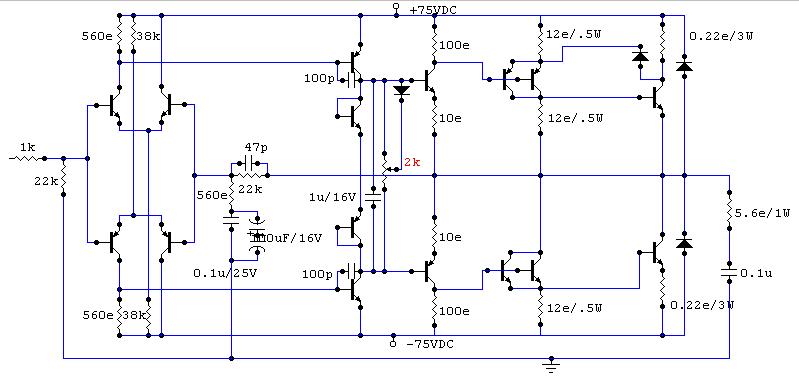

Then I can now move to amp with following specs
Supply+-75VDC
600WRMS@2 ohms
output devices=MJL21196 only NPN are permissible in my designs
drivers=MJE15032/15033
pre drivers=MJE340/350
filter caps=6 X 10000MFD/100V atleast
4 X 55V @2.5KW Pure IRON CORE (no toroidals are allowed in my design)
2 X 4.7" AC mains voltage Fans for cooling (no variable speed DC fans are passed in my authority)
Every body agree upon it or not??:smash: :smash: :smash: :smash: :smash: :smash: :smash:
Reply
ThanX to PETER for reminding everybody!
SO FOLKS here is the proposed schematic:smash: :smash: :smash:

HELLO HUNTER The metropolitan city man!
Where u been around these days, quite busy indeed man.
NOw regarding the current sharing of MJ's
"I have passed a written order under my authority to MJ'S to share the current which will be given to them or unless there is a risk that they can be eliminated from my schematic"
So dont worry man , MJ'S are my loyal PETS Since2001 , they are sharing current in equal amounts .
