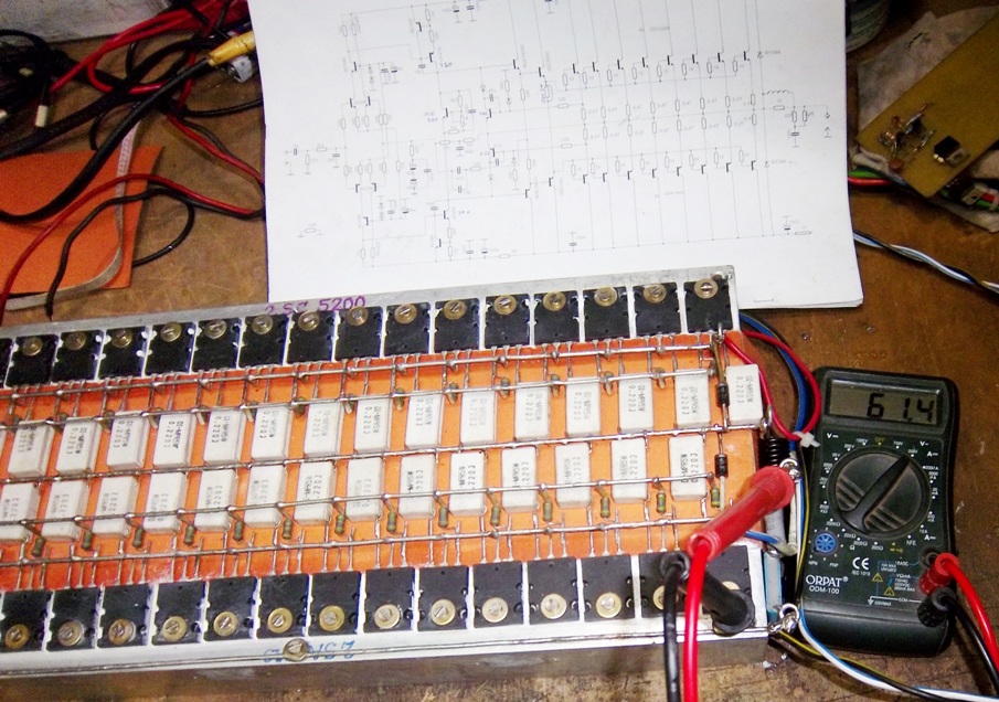

This is just a theortical design,I also know that if I make a 20kw per channel and even if I use 15024-25 I will need minimum 2000 of them,in class AB, practically not possible,Just wanted that if seniors like you can check the circuit to make an amp of 4 to 5 kw per channel will be a great help for me

For you Information let me tell you I have already practically made class AB amps up to real nondistorted power of 1400 watts per channel in to 2 ohm, see the photo attached, I have tested it in field for 6 hours with 8 speakers 15" direct and has passed the test.8/8 the load was 1 ohm, the meter in picture showing peak voltage on 2 ohm.with speakers in field it was 44 volts and 29 amperes.
my 1400 watts per channel class Ab amp
Picture of my amp
