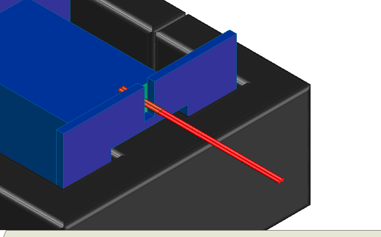

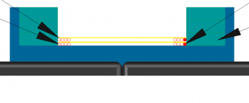

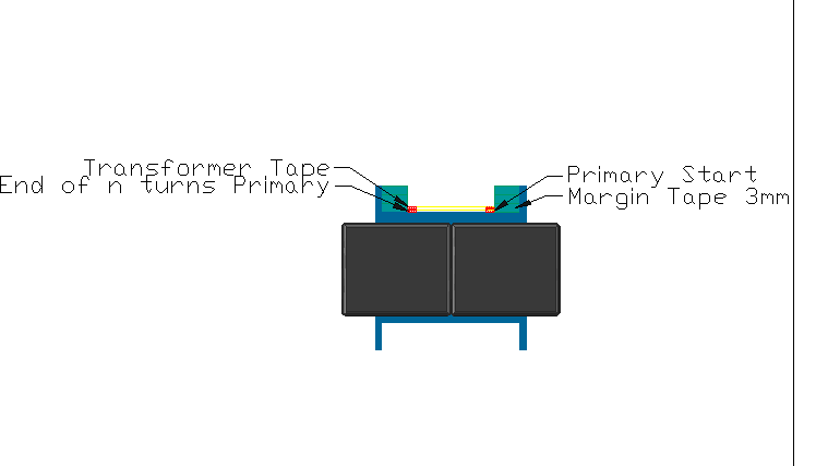

Here's a little bit about transformer construction...
To reduce the leakage further, try this. Cut a small slit in the sidewalls of the bobbin on both sides of the bottom of the core. Then wind all the primary turns on a single layer against the bottom of the core. Pull the return wire through the slit on the end of the bobbin as we will return it at the very end. This also helps keep the leakage down. Add a layer of tape then add another layer of primary on top of the first layer. Next Bifilar wind the secondary so that the secondary wires fill the entire length of the bobbing bobbin. Leave the windings of this hanging out the slit in the bobbin. Add another layer of primary. then another secondary and primary. Each primary/secondary layering will halve the leakage. Now add a layer of tape and return all the primary wires. Now add 3 layers of tape and the secondary wires.
I hope that helps.

I think that's the hell of a winding technique that will help a lot, since it's nothing else wrong on the supply, in fact, it works fairly good at designed power, but only for a while, when output diodes begin to get really hot and I have to turn it off.
I'll try this technique, but... to know I'm doing right if you could upload a pic of it, real better

james, I think I understand it, but a pic wouldn't be bad
I understand that the thing's to make a "plane hole" in the opposite side of the begginning of the primary, when you wind the whole layer and then you leave hanging enough wire to weld it to the begginning of the other layer of primary, and the wind a layer of secondary and do the same and so on, think it's the hell of a technique since all the windings will be pretty plane and smooth and will not return over itself, to the current will look like it's always going in an infinite spiral, never returning

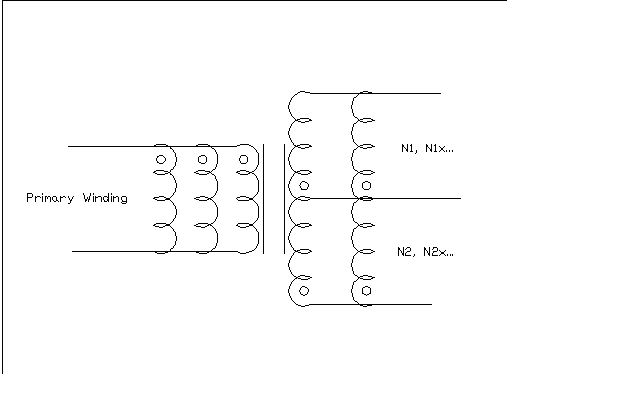

My apologies... I've been out of touch a couple days... I'll try and get something (a picture) posted today.
Now for the layering... I'll supply a transformer symbol in a minut but essentially the construction for the secondary is for a center tapped transformer N1 is one winding to the rectifier and N2 is the second winding to the other rectifier. N1x and N2x are however many additional parallel windings needed to cover the full width of the available area. This means all teh windings will see the same viltage differentials, and the paralleism means that they are very well compled. This technique should yield a leakage/primary inductance ratio of about 0.5% or about 5uH for every 1mH of primary side inductance.
At the end you will pull the wires through the slot in the other side of the transformer.
After you have completed the layering you pull the wires back across the transformer and terminate the wires on the pins.
All views are from the bottom side of the transformer (the side the lines are on).

I think that's pretty clear now, I think it's a really good method!! thank you for all, I'll get it done on monday and post back with the results

Tony: I wound the transformer using the technique you depicted the best I could, the results where significant over the amplitude of the unsnubbed spikes, working at D=60%, at 82W output power, the spikes did not last until the other cycle and where approximately half in amplitude than they were, the freq of the ringing is still beetween 5 and 6 Mhz, guess I can still improve this by winding better because I did not do a really great job, I was eager to see what happened...
