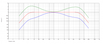

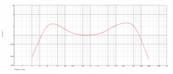

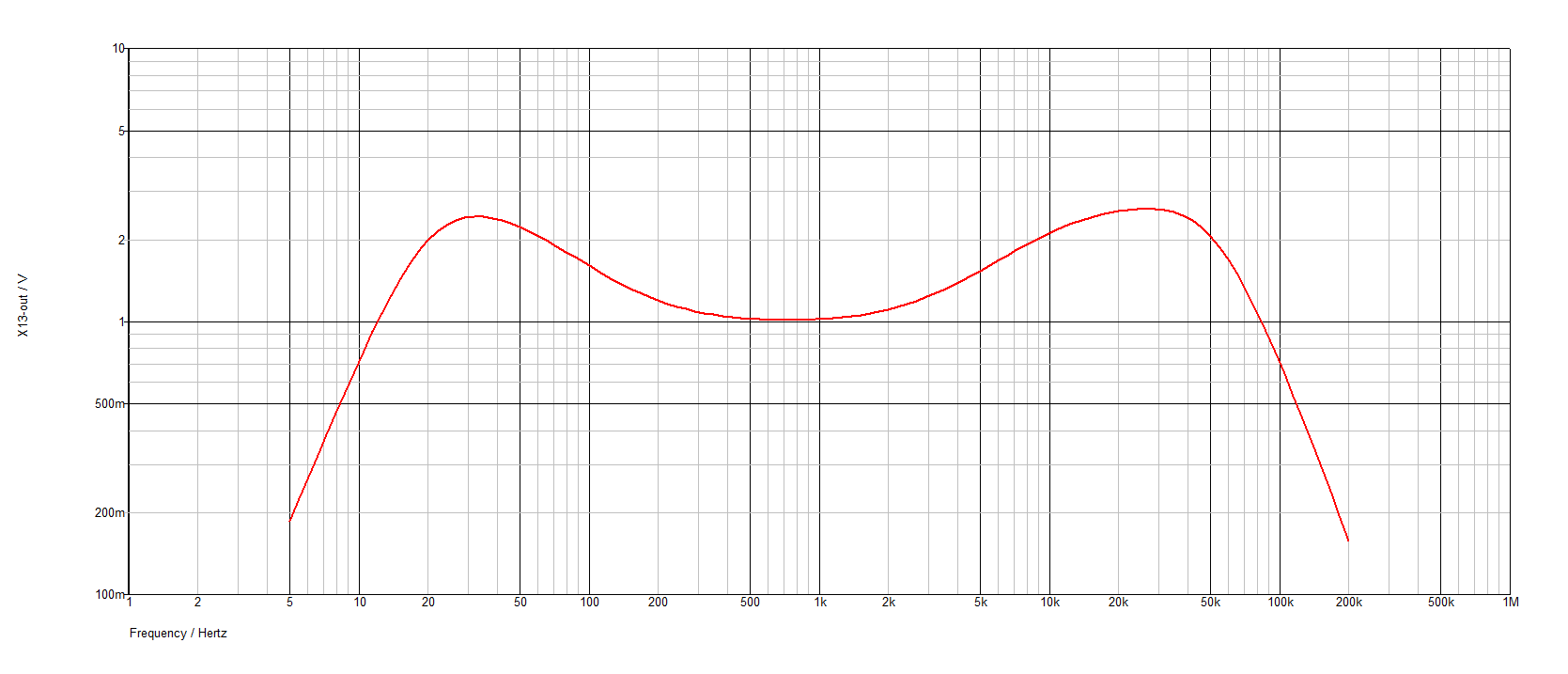

Hi Stratus46,
Maximal boost is about +-12dB. At 100Hz the boost is about +6dB . At sound studios they have wonderful almost flat line response systems from 20Hz to 20kHz. The sub-woofer as well as the high frequency response is corrected. When the product get to the consumer, well they could have an equivalent setup or they may need some adjustment at the fringes. The assumption here is that the consumer has more than a one way driver. Assuming mid-band responses have no issue then what we need is a fix for the fringes. Even for a one way driver some very interesting phenomenon takes place the points at which the impedance rises in the bass region is also where our hearing also increases in hearing 'impedance' ;) . Our ears have a resonance 3- 4kHz, so the single drivers increased impedance is compensated for by the ears decreased hearing 'impedance'. We also need to take care of the high frequency fringes due to increased hearing 'impedance'.
Translating a hypothesis into reality is another issue. Reality confirming the hypothesis is a break through.
Kindly correct me where my assumptions are wrong :)
kind regards,
Harrison.

Look at Hi-Fi Preamplifier by ESP. This design gives a more sensible and subtle tone adjustment range of +/-10dB whereas the more "traditional" designs use +/-20dB.
I built this circuit using LM4562 op amps, have used it for around 18 months and find the quality and adjustment range excellent. The gentle tonal corrections it offers seem perfect when compensating for the room acoustics.

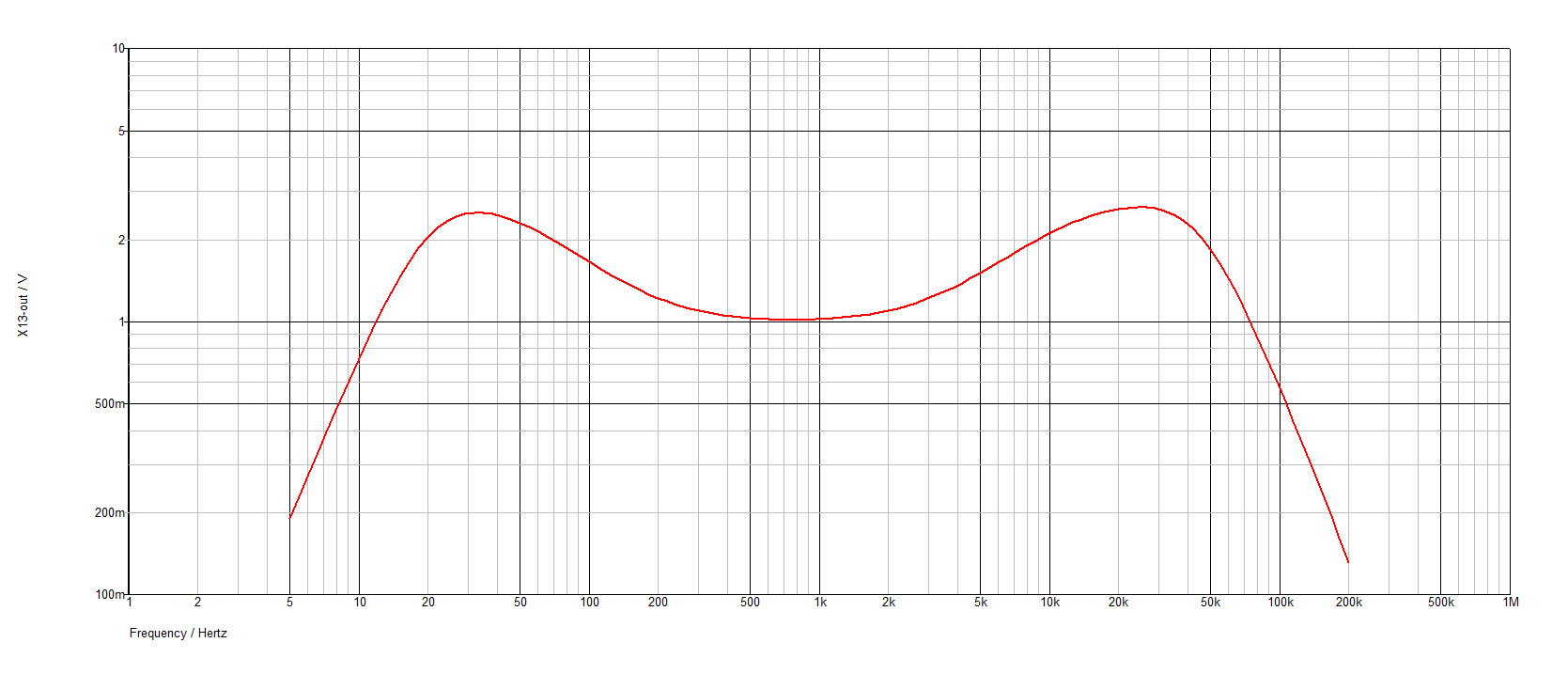

Hi Currentflow,
Thanks, took a peak :) . If you look at the #13 . The peak of the LF is about +13dB.
kind regards,
Harrison.

Hi OnAudio,
The treble end of your graph in post #13 peaks at around 45KHz. At the upper audible end of 20KHz (a slightly higher frequency than most can hear) the adjustment range is still about +/-7.5dB. There would be no reason not to build it and experiment.
currentflow

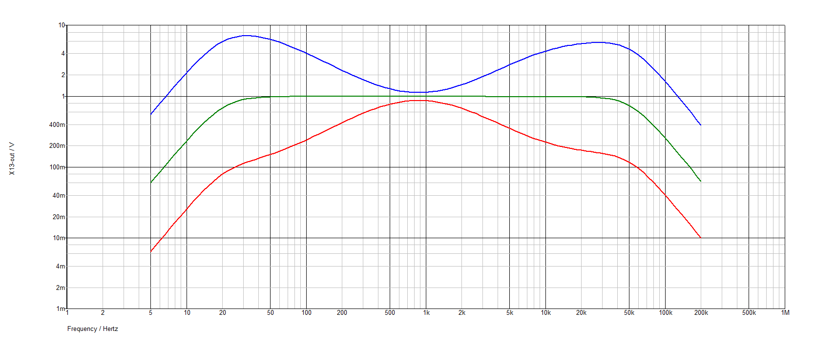

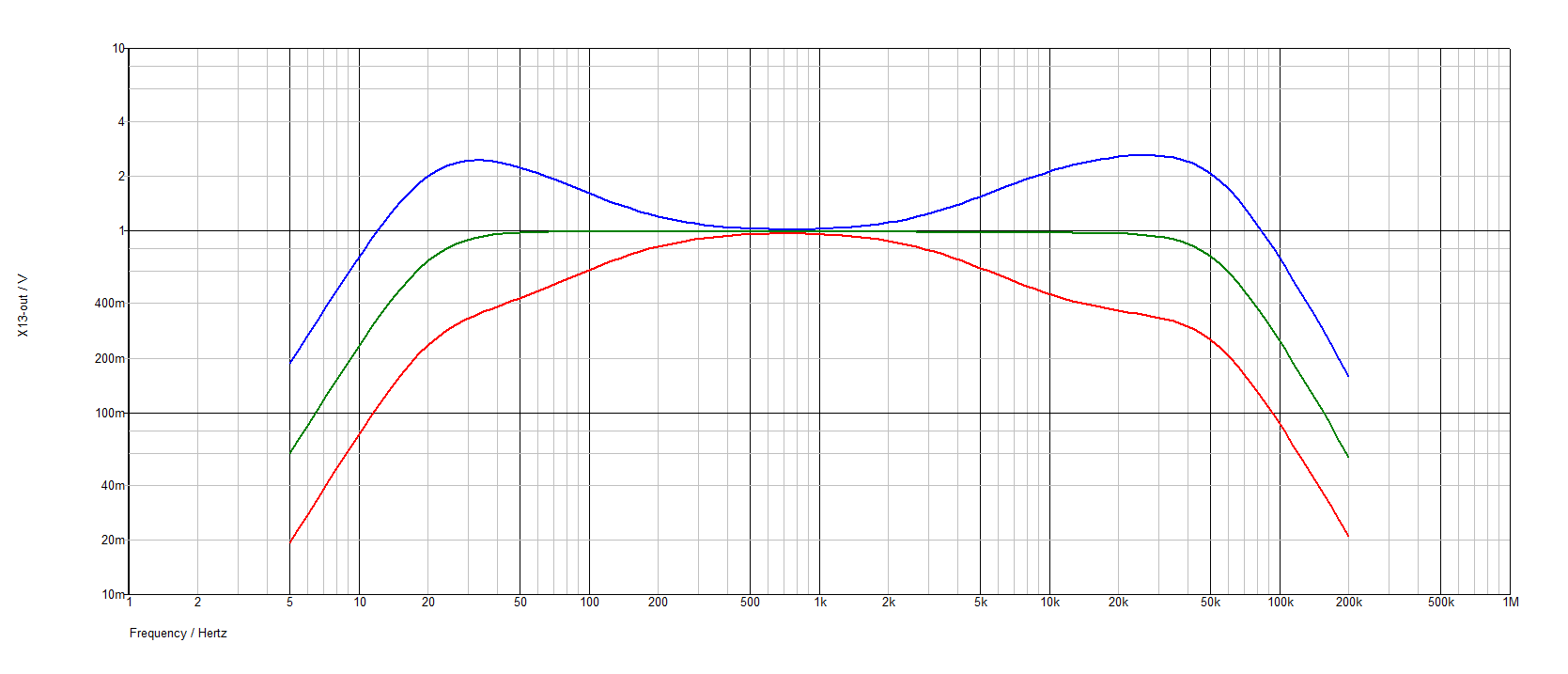

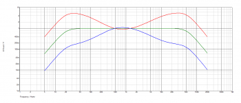

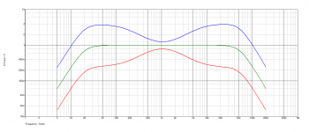

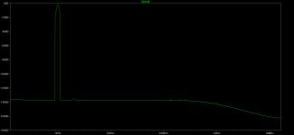

more curves
Curves from one of the mods. Comments welcome.

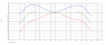

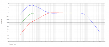

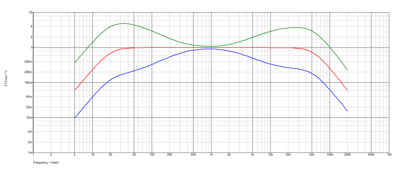

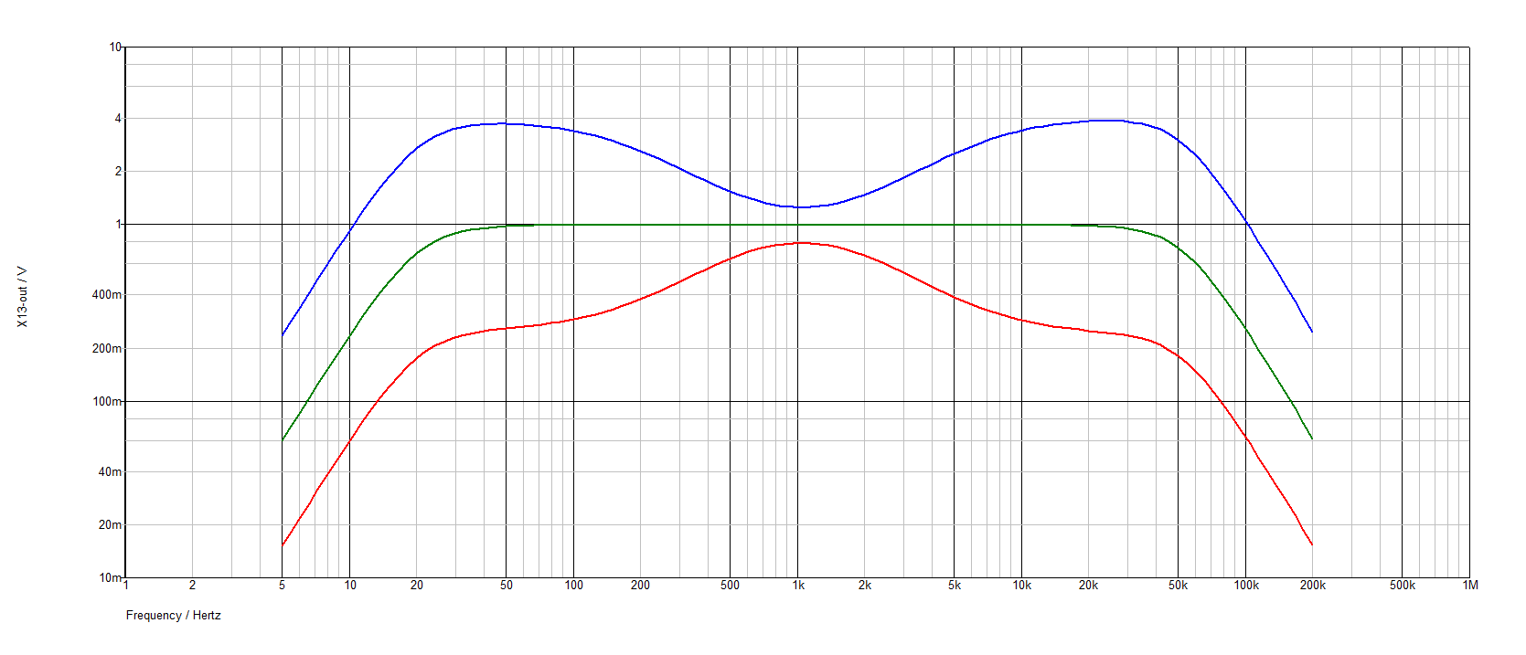

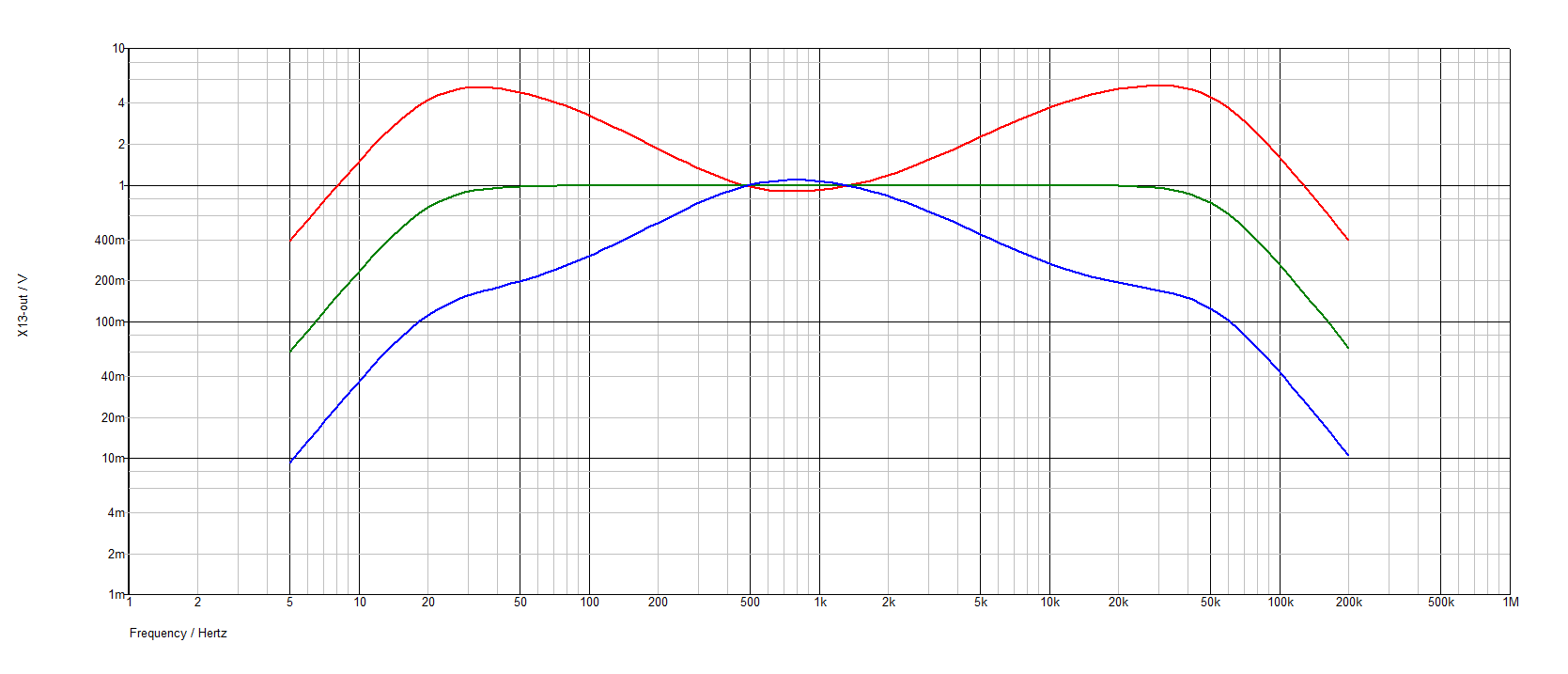

Mirror mirror on the wall ...
Am thinking 200Hz and 3.75kHz
Who is the prettiest of them all ;) . Taking some parameters into consideration,
The recording environment, hearing characteristics of the mix master, the studio monitor, the room acoustics at the studio, humidity etc.
And the consumers gear, hearing characteristics, room acoustics etc
These curves might just get the job done ......be generous with your comments

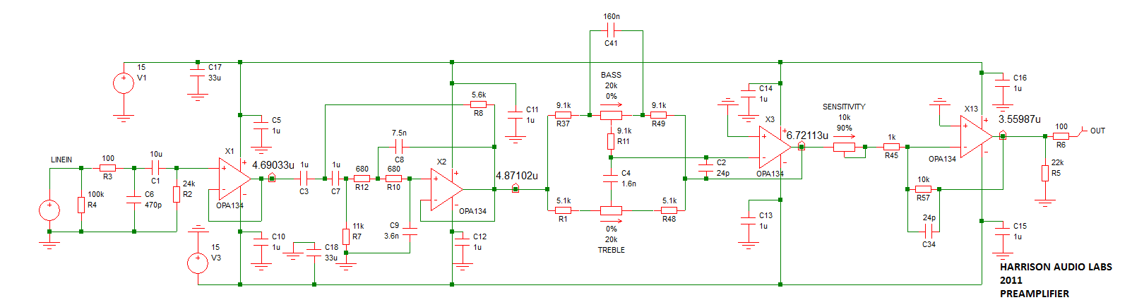

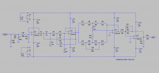

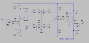

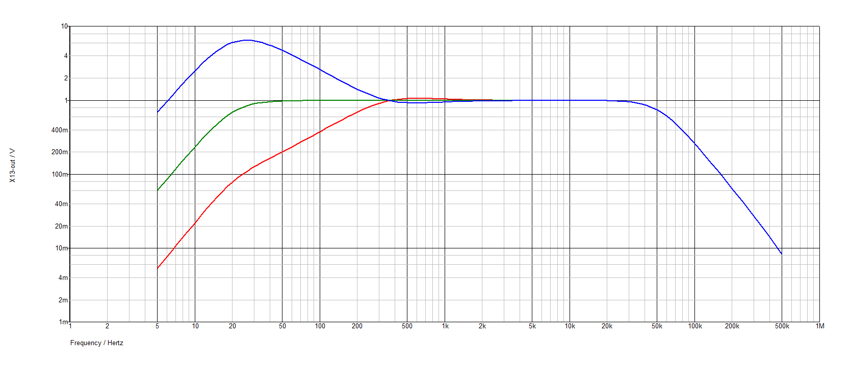

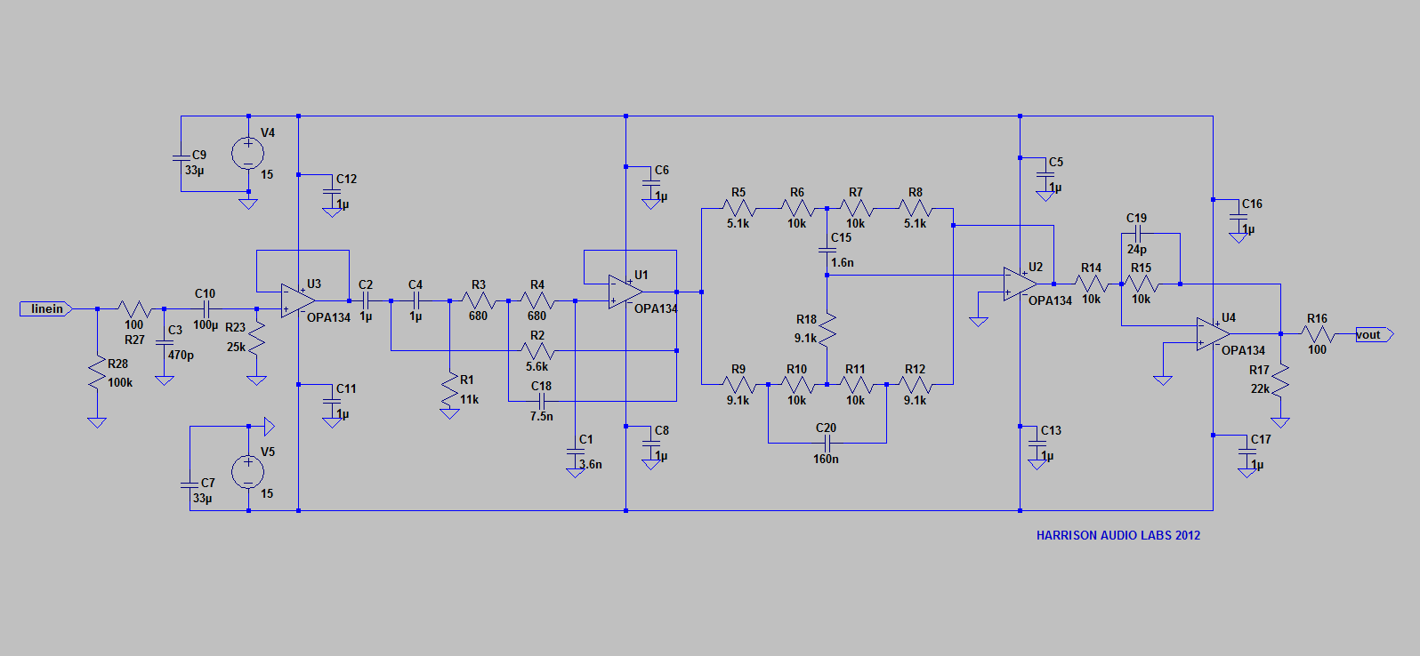

time to share what am looking at
This is what I am currently looking at.
The last block can be converted into a level and volume control for universal acceptability, However I think the volume should be with the power amplifier.

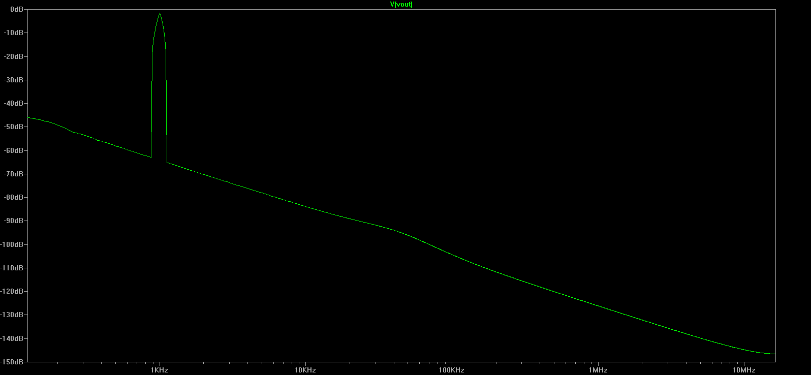

Will post distortion figures soon.
My assumption is that with the simulated low DC offsets, there will be no scratchy noises.
The focus of this preamplifier is rather on the control curves, should you decide to go discrete that's fine.
Suggestions for improvements welcome.
