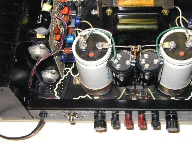

My venerable DH-220 seems to be developing more mechanical transformer hum. Google got me to diyAudio, and forums search got me to this thread.
I've made one pass through the thread, but I think it will take another to digest everything! The first read was enough to have me asking questions, if somebody can manage to humor yet-another new guy:
1. I don't actually use the DH-220's power switch. It is plugged into a switched outlet on the DH-110 (WCF == Wife Complexity Factor precludes anything else). Am I in danger of cooking this switch from the turn-on current draw of the DH-220?
2. If I'm going into the DH-220 to add rubber washers for the transformer mounts, it sounds like I should be checking values on the power supply caps and replacing if they have lost value (or upgrading to more if I also want to put a higher-rated bridge and soft-start in), and adding smaller-value caps in parallel regardless of keep/replace/upgrade. Have I got all that correct?
3. I see C405 on the schematic (effectively across the secondary), but would a snubber cap in parallel with each diode in the bridge be helpful (I've seen it in other power supply schematics)?
Thanks for answers and newbie tolerance!

If you study the schematic for the DH220 you will see that each electrolytic capacitor has its own small film bypass capacitor. There are no "quick fixes" or simple mods worth doing to the DH-220. They already have been incorporated into the circuit.
The jury is still out on whether faster diodes or snubber capacitors on the diode bridge are worth the effort in improved sound. If someone can point me to a credible well designed and implemented A-B test of this mod I would like to read it.
The only mod I have found worth the effort (and expense) for the DH-220 is to replace the original 10K uF filter caps with something like the 26K uF caps from Musical Concepts. This extra capacitance with 2 uF film bypass caps (and 6800 ohm bleeder resistors for safety) can make an observed and heard difference in the sound. This is worth doing. But, the extra capacitance puts a much greater load on the ON/OFF switch and diode bridge on start up.
This extra PS capacitance is right on the edge of requiring a huskier power switch -- if you can find one. Many who add extra PS capacitance also use a soft start circuit to gradually (over 1 second or so) to turn on their amplifiers. I use such a device built up in the metal case from an old AT computer power supply (the large version) that uses a 3-4 second time delay relay with 117 VAC field coil and a 50 ohm power resistor in series with the incoming AC. Circuits of this type are all over the place here, do a couple of searches.
Some people use a CL-40 Thermistor - Type CL, soldered in series with the incoming AC supply and placed in free air to aid cooling. This thermistor slows down (microseconds) the initial AC surge enough to provide adequate protection to the power switch. Some argue that a thermistor reacts too slowly to the varying power demands of an A/B type amp circuit, some say it does not make a difference in the sound. Later versions of the DH-500, for example, used a thermistor. I have used one in my DH-220 with extra capacitance and heard no difference and have modified two other DH-220s for friends who also heard no difference with the thermistor in place.
The DH-220 came along after all the many mods for the DH-200 were published. The DH-200 needed the mods, the DH-220 does not.
Another mod mentioned in threads here is to place a 470 uF electrolytic in parallel to the existing 10,000 uF caps in the PS. These smaller newer electrolytics can make a difference in the sound of the old tired caps in most old Haflers, and I have heard this difference. Here is a picture of such a mod:
