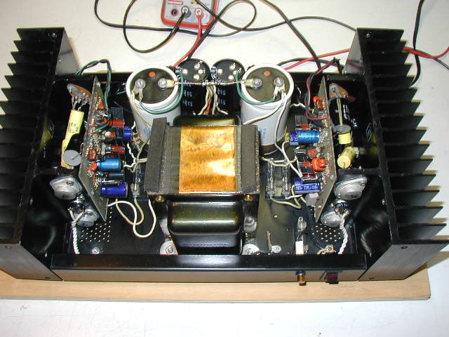

Dick West picture
Hi dick nice to see you finally got there, I note your thermal breakers are still connected, try connecting your mains directly and get a real surprise those extra
wires and breakers are sound destroyers particularly on 110volts supplies,I also observe the extra power supply caps, very sensible.Hope to see an extra pair of O/P

Hi Humble,
No need for a truce, we were never at war.
Whenever anything causes me grief, I like to hunt it down until I understand why. Just my nature.
For what it's worth, I've noticed with beta's that measure the same I may still not be a match. The test jig I mentioned mimics a diff pair with no feedback so that a match can be confirmed at whatever voltage and current you want to run at. I was hoping the technique would help you in the future.

Humble
Been there, done that. My present amp with the Musical Concepts PCBs has 6 MOSFETs per channel using heat sinks similar to those from the XL-280.
In the USA a company, Smart Devices, sells amps to motion picture theaters. For years they used the DH-220 PCBs with their version of amp chassis, toroid trannies, etc. They put the thermal breakers in series with the wiring that goes to the speaker protection fuse circuit. Thus, the amp can effectively be shut down by overheating and the speakers can be protected by the fuses. They did not put the thermal breakers in series with the AC.
I've considered doing this. What effect on the amp's output will the thermal breakers produce?
Hope to see an extra pair of O/P devices there one day.

Hi Dick,
Not much. Marantz did this on some models.
Essentially, it's a set of contacts, like a relay. The only problem is that they can oxidize and you can't clean them. Replacement only.
Hi Humble,
Everyone around here knows that I take a very dim view of removing any protection circuits or devices in an amplifier. It's pretty darn foolish, and a bit arrogant (especially if you charge for that "service"). Don't do that. Buy new ones instead to replace the older parts.
That is the one thing that does get me steamed up. There is no argument you can make to compromise a safety feature.
-Chris

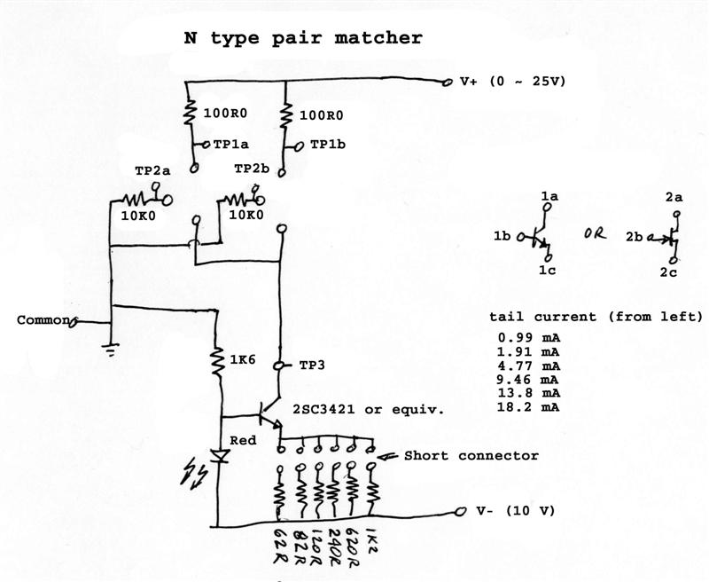

Anatech Diff tester
Hi Anatech,I'm sure many people would be interested in your SUPERTESTER,
including myself can you print the circuit? Also IANS forum member [meridian 605]
mentioned that he thought he had seen your name against some original Hafler mods, I couldn't find any of these only your particular "Critique" of other peoples postings I would be interested to read about your mods to see how they compare with those I have submitted, if there are any similarities, in case I have missed some

Hi Humble,
The thing is a test jig, not by any means a "SUPERTESTER". I have described it quite accurately and there isn't much to the thing.
The reason I described it rather than put up a picture (easier) is that my camera is missing and I'm in the process of redoing my home network. That included migrating from windows NT4 SP6 server to either the Beta of Microsoft Home Server or a Linux (probably RH 7) server. Never mind a new all in one printer and a few workstations that did have a sound card test system on it. So two workstations in flux on top of that.
So, just for you ('cause you are so special), I spent about 1/2 hour and hooked up my old scanner to my old Win '98 machine so I could scan this rather simple test jig. Keep in mind that it was designed and constructed in about an hour - and it seems to work very well. I sent some matched samples to a member with access to a Tektronix curve tracer to verify it's operation. He is located in Great Britian as well, so I've also put my money where my mouth is. They were sent airmail.
From what I have seen in practice, it is an improvement over simply measuring beta or IDSS and gate voltages.
Now, when it comes to mods, I do not speak out against any unless the compromise reliability, safety or are based on "magic parts". I use mostly the same user name, so go ahead and look. I believe I have been very consistent in my views for well over 30 years (in case you find someone who knows me, they can verify this). I have even taken a few manufactures to task over poor engineering and been vindicated. Have have not singled out any Quad or Hafler products for mods, just silly technicians.
I have been involved in servicing for over 30 years and I get to see the fallout from equipment being hacked. So I would think I'm in a decent position to understand what can happen as safety devices are bypassed. So, without installing another safety system to replace the one you are removing, you are doing a great disservice to your customer. Also, in Canada anyway, a line fuse or breaker is there to protect the connection between the unit and the wall outlet. If it also manages to protect internal components during a fault - GREAT! Other systems ought to exist to protect your load (speaker) which may be flammable once coil temperatures reach a certain point (believe me when I say that some certainly are!).
So, my stance is that if you feel that sound quality (as you perceive it) is more important than safety, you are a fool. Protection systems can be designed that have minimal to no impact on sound quality.

Hi Humble,
Yes, audio has come a long way. I do recognize that there are other ways of protecting the speaker. My point is merely that if you remove protection in one place, it must be covered somewhere else or by a different method. Still, I'd rather breakers than fuses.
One thing I have learned over the years is that components all fail. Each part has a failure rate, even when conservatively used. Also, what a manufacturer does and doesn't use in line with a speaker may have no bearing on sound quality. Rest assured that each one has a valid reason why the way they do things is better. I still don't buy the lack of protection. All I have to do is hold up the Bryston 4B or Proximity amplifiers as case studies. Each did not believe in any form of speaker protection, and each has taken speakers with them when they have (inevitably) failed.
Carver solved this problem nicely in their amplifiers. Low energy stored in the supply and AC shutdown. It works so well that often if an output shorts, nothing else is damaged. Not even the speaker. The speaker leads go directly to the amplifier unless it's a TFM, in which case they go through an LC network on the way.
All,
I reversed the current settings list in my jig in post #472.
-Chris
