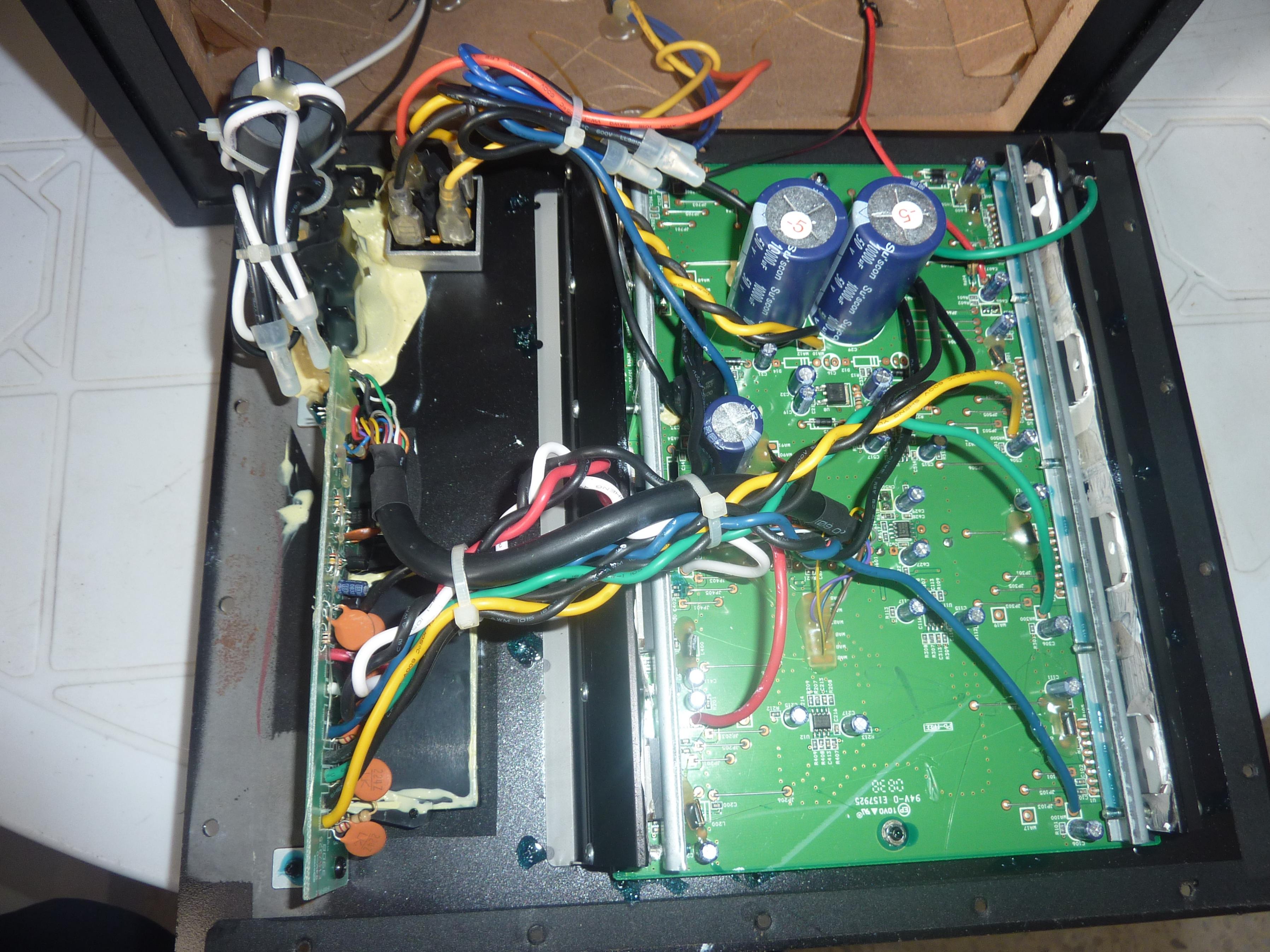

I purchased a cable from ebay to enable my z5500 to work without the control pod. The problem with this cable is it apparently send the maximum signal to the sub and the sub COMPLETELY overpowers the rest of the sound. I tried cutting the wire inside the sub to the sub-speaker and that cut the bass too much. Next step? Add a pot to control the sub to control the volume of just the sub channel. The problem? I'm a novice when it comes to electronics.
I used a potentiometer from Radio Shack: 10K-Ohm Audio Control Potentiometer with SPST Switch - RadioShack.com
and soldered it inline With the grey wire between the (i'm guessing) line level board to the amp board with the ground pin going to the ground wire attached to the back of the heat-sink.
It works great!

I'm in NO WAY an audio geek. I have almost no knowledge what so ever in this field. I'm an electrician and I also like working with computers, inside and out.
At work someone told me they found a speaker in a house that had been auctioned away, and it was to be thrown out. I looked at it, and it was the subwoofer/amplifier from the Z5500 system, and it looked to good to be trashed.
I took it home, and thought it might be usable, but no. There was no control pod.
Then after some googleing i find you guys!
Now. What to do. My plan was making this into an active subwoofer, that would work together with my Sony 5.1 amp. It's got a preamp phono jack out, for subwoofer connection.
One of you had reverse engineered the pinouts, so it made the job quite easy.
I'm an electrician, so I have testing tools. I started measuring from pins on the connector on the back, to the circuit board inside, and found out where pin 6, 7, 8 and 13 ended up. Then I soldered 4 wires on. I mounted an RCA connector in the back of the subwoofer amp plate, and soldered the 4 wires to ground. The I found out that pin 2, Sub In, was the grey wire in the wire bundle, so I cut that and wired it to the center of the mounted RCA connector.
And it worked! My Sony amp can turn up and down the volume on the subwoofer individually.
