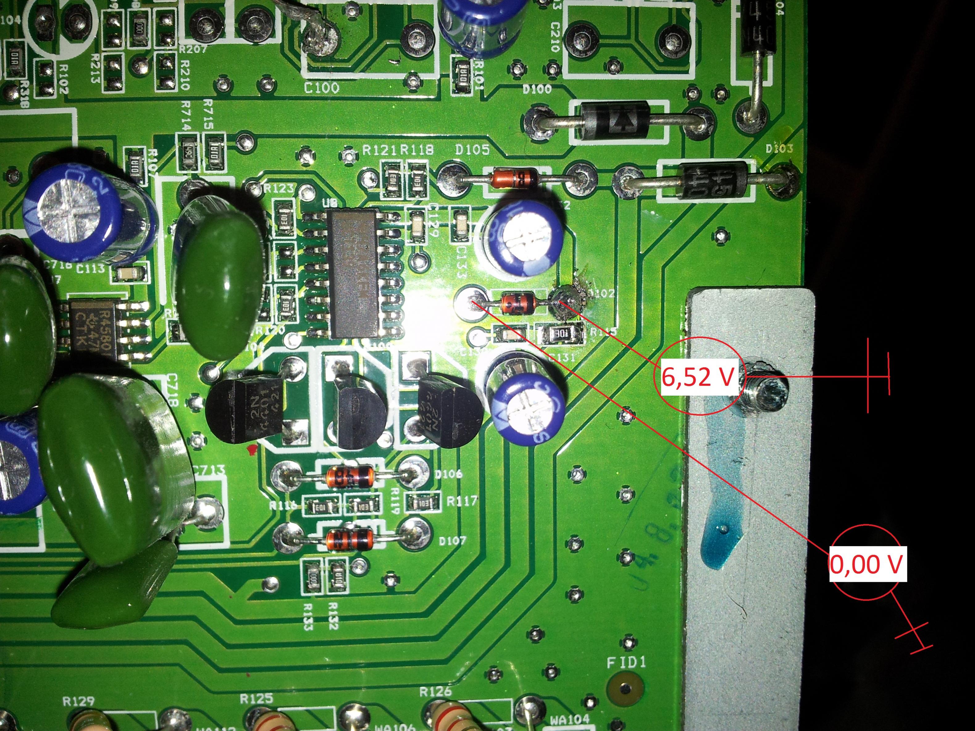

Yesterday i tried to hack my z5500 RCA version cause the pod is dead.
I connect all so pin 7&8 to 5v and the sub and other speakers like on page 4.
First i got a buzzz sound and when i plug in the jack it was gone. and i was able to listen to music. I changed the source from mobile to computer and canhear something. I changed the source again and the buzz was gone. I tried my mobile and all speakers are dead. No sound anymore. I think i killed something. My experience is not sooo high. Maybe u know whats going on. Preamp dead? Is it possible to bridge that so that u go direct to the amp? Or set a direct signal to the amp to switch it on?
Greetings from germany
Mordi
Hi, Today i was watching again because this Stress me out a lil.
So i have in front of the Resistor? 6,.. V and after that Zero,
think this isnt normal,
hope u can help me, please
Greetings from Germany
and by the way sorry for that bodily harm cause of my english!

Is somebody there who can told me the voltage out from Hct139. I have connect the sub and was set about 8V Voltage on the in channel from right speaker. Cause i was connect it like the pod in and dont think about that they make some cross in. So my amp will not switch on anymore. I hope somebody tell me the voltages into the amp that iam able to messure it to fix my misstake. All channels make nos sound output anymore. I think i killed something on my preamp. Maybe somebody maked the same misstake and got a solution for this.
Please help me!
Mordi

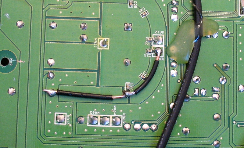

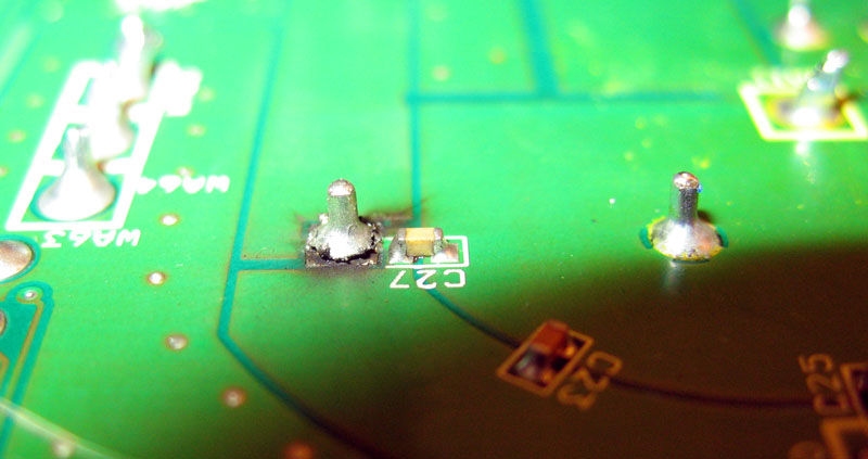

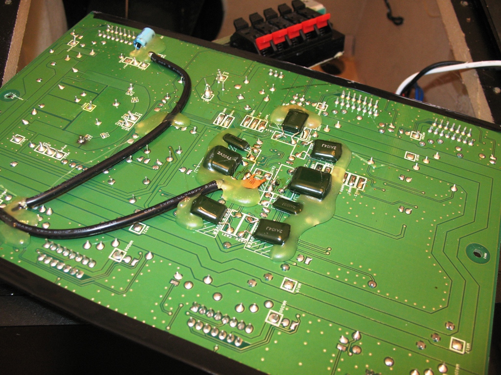

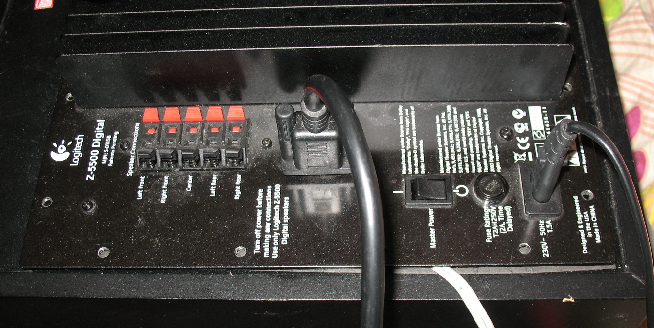

Here is my short story.
Logitech Z-5500, springs-clamp version. Was buzzzing from all channels when turned on. CS* IC was not fried so I started to listen signal on POD-out. It was clear. Then I checked voltages on Amp board and noticed, that -rail is lower than +rail.
Problem was in bad solder jont, or even cracked trace around solder joint under one of power caps.
Here are photos with my solution.
