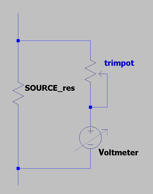

it's simple as this
source resistor or resistor in series with rail ( lazy to look at schmtc)
just calc do you have enough voltage across said resistor to have enough current through voltmeter for mid position of needle , which is half of declared current

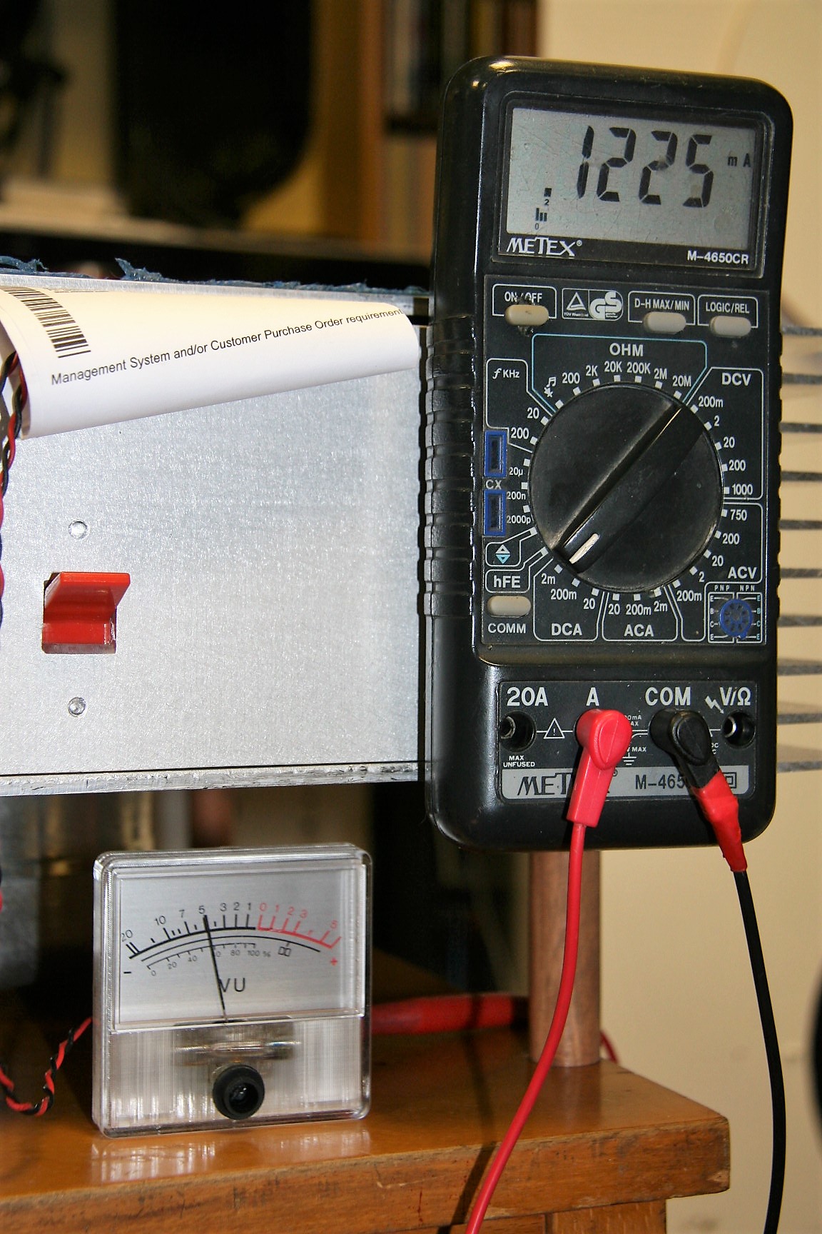

I've measured current through VU meter.
It is 0.1225mA or 122.5uA, in a quite good correlation with calculated value, which is 0.1V/760 Ohm as is 131.5uA. It is slightly higher than measured value, because of serial impedance of my METEX multimeter.
But I must to know those cheap ammeters internal resistance to choose the proper one.
exactly
if that info is missing , buy just one and measure it
