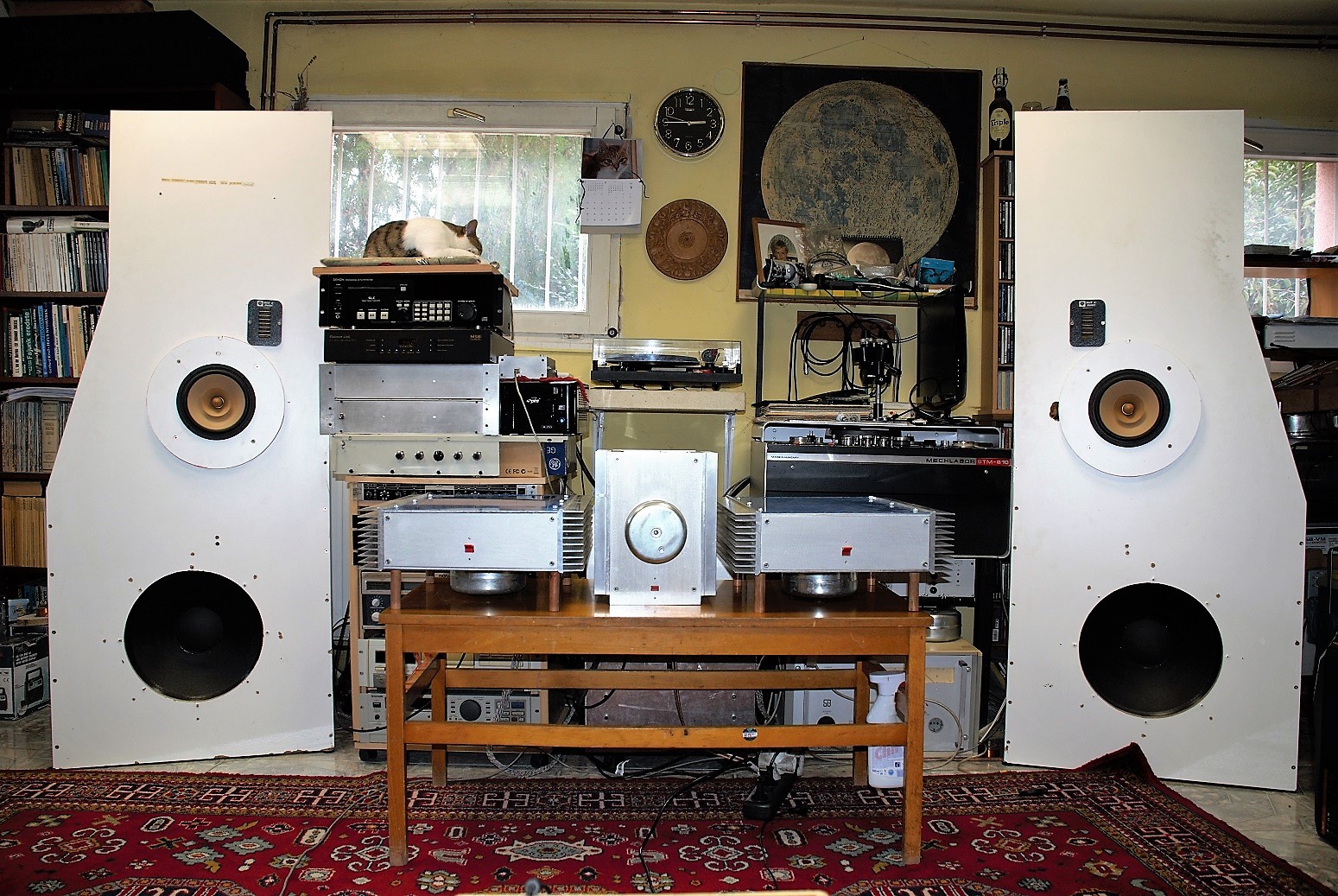

It sings for more than three hours now.
I'm a happy man, with two Sony VFET amp.

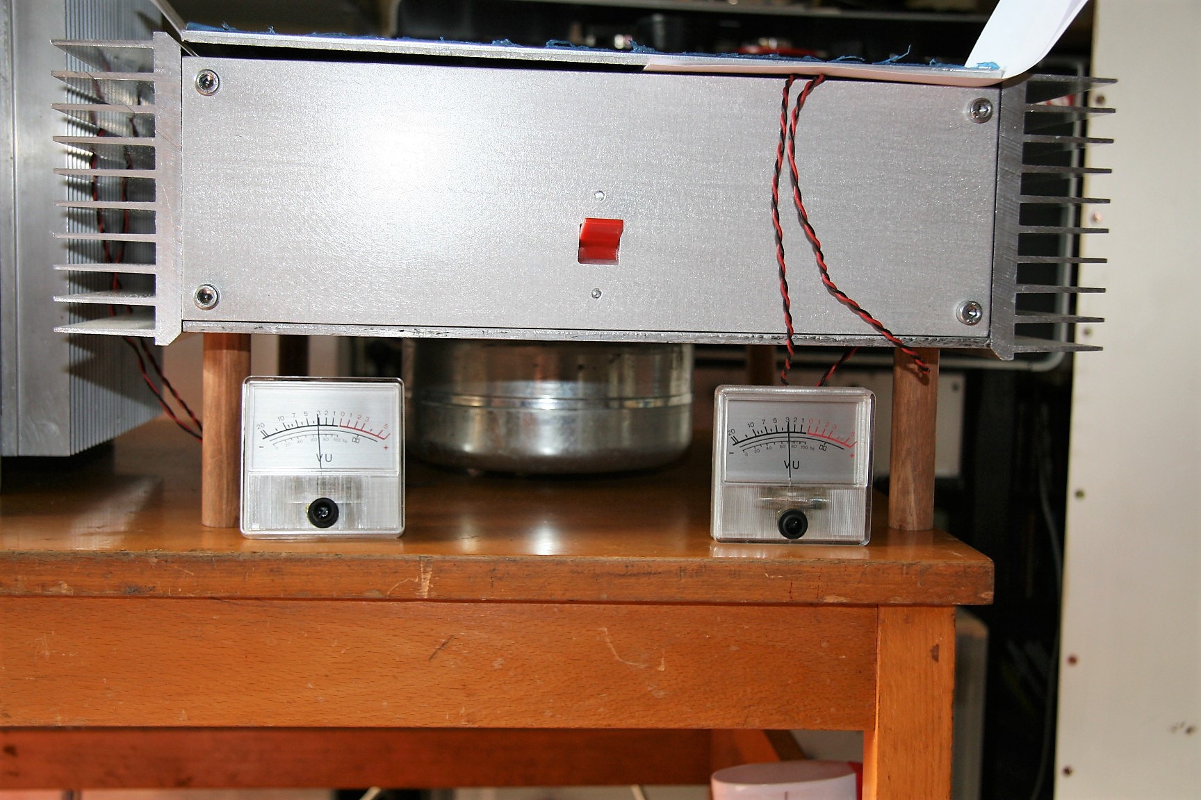

Second one is up and running!
Congratulations! Double fun...!
So I would like to use a meter to constantly monitoring bias current on both (four) channels.
There are many kind of cheap Chinese round analog ammeters on Ebay, but I don't know, how to choose a proper one.
I would welcome any advices!
It is just for testing purposes connected to R32:

What I've thought, I will simply parallel an appropriate micro amp meter with R32.
Those VU meters are in this configuration, they shows bias current pretty well.
These have about 760 Ohm resistance.
So most of the current goes through R32, and a little portion drives VU meters.
My problem is, I don't know which cheap micro amp meter has similar parameters.
And I do not want to spend money blindly, even if it is little.
