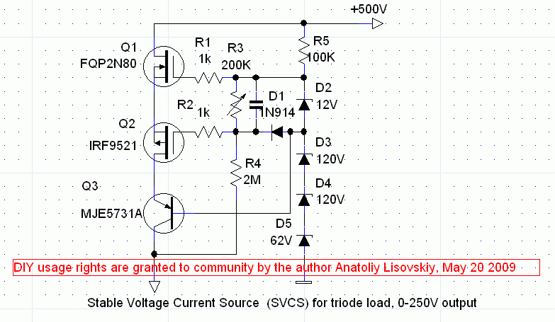

I would still call it a SVCS: it is a voltage stabilizer on DC, but a current source on AC. I prefer descriptive names that reflect functions.

Ok, I'll draw you a draft as soon as get some time. It will be one MOSFET voltage regulator, and a SVCS. Now I have to go to finish a prototype that will be tested on tomorrow's concert.

OK, now I have time enough to pester you a bit. :D
Can you tell me something about the circuit choices you made? First, I assume the 5731A is there because I mentioned I'd been thinking of using it. But the only reason I had them was that I got them a few years ago as (possibly) improved replacements for MJE350's in an older CCS circuit. They do sound better than the 350's but it wouldn't surprise me if there's a better sounding alternative by now AND as you're depth of knowledge is so much greater I can't let it go without asking, if starting from zero, what other transistor (or other device) would you have chosen?
The other question right off the bat is why enhancement mode Mosfets above and specifically why the IRF9521 ? Again, not criticism just wanting to understand the thinking behind the choice.
Thanks Wavebourn !
Transistors here must not sound, they must regulate. There is a broad range of available devices, and their regimes would depend on the device used.
Why your favorite transistor?
Because you have it, and it will work well in the application.
Why enhancement mode MOSFETs?
Because it was simpler to use them here. Their G-S cut-off voltages summed determine a reference that will be used to compare a voltage drop across the cascode. Since they vary from device to device, you have the pot that will be used as well to vary a voltage on your tube's anode to to make feel happy it and another one that it drives.
Why IRF9521? Because I have it right now in front of me on my laptop; it has low capacitances and more than plenty of volts and amperes specified by the manufacturer for this application.
The top one I've found searching a datasheet catalog online, it again has optimal parameters for your application, plus a good safety margin.
Zener string? Again, you may use Zeners available for you; I selected Zeners again for optimal price/performance ratio.
There are many ways to skin the same cat. Those who exploit the single topology struggling to find the best parts for it are called "Legendary Designers". I am not. For different parts different topologies would be more optimal, or different regimes in the same topology. For different regimes different parts would be optimal. And so on. I am free to vary parts, topologies, regimes, in order to get end results I need. I could use more transistors or less of them. I could arrange them differently to get similar results. But before designing something I carefully define end results, limits, conditions. No problem can be solved without the comprehensive conditions given. That's why I was asking you about voltages, transistors, currents, tubes.
Hearinspace said:
Trying searches on Digikey and several manufacturer's cross reference search engines I get nothing concrete on the IRF9521. Is it still around?
I don't know. I have a bag of them from Supertex. http://www.datasheetcatalog.org/datasheet/supertex/IRF9521.pdf
Search for something with less input capacitances; high breakdown voltages are not needed (actually, 60V is more than plenty since about 10V maximum will be between source and drain), maximal current up to 2A. I am sure you will find some. If it's cut-off voltage will be different we always can recalculate values of resistors, but as designed tolerances are wide like barn gates (everything adjusts one pot), so don't worry.
