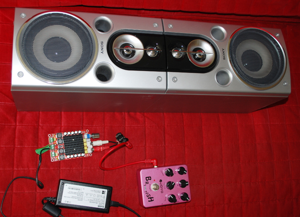

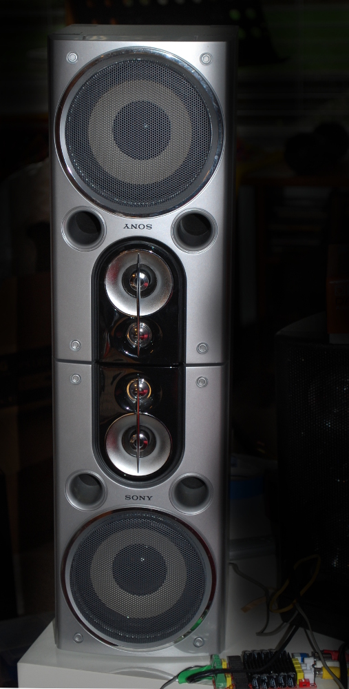

Recently I've been using my long-neglected Zoom G3, combined with a DIY powered speaker, as my living room guitar amp. The G3 offers three individual (digitally simulated) "stomp boxes", which can include amp simulations. What I've been using lately is an amp simulation first in the chain, followed by a reverb/delay "pedal", and finally an arena reverb, before the signal exits the Zoom and goes on to my powered speaker (a pair of thrift-store boombox speakers glued together and wired to a class-D audio amp module and a 24V SMPS.)
The G3 was a budget-priced digital modeller from several years ago, and its built-in amp simulations will never be mistaken for a real valve guitar amp. Still, once I've chained in the right post-"amplifier" effects, its not bad as a living-room guitar amp. If the crude digital amp model in the Zoom were replaced by an actual valve preamp, I expect it would sound considerably better.
I've used the same powered speaker with a Joyo American Sound (supposedly a Sansamp Blonde copy) as well. It wasn't bad, but sounded better when the Joyo was followed by an (actual) reverb pedal. It never occurred to me until this moment to try chaining the Joyo into the Zoom, using the Joyo as the amp simulator, and the Zoom for post-amp EQ and effects. But I'm definitely going to try that as well.
